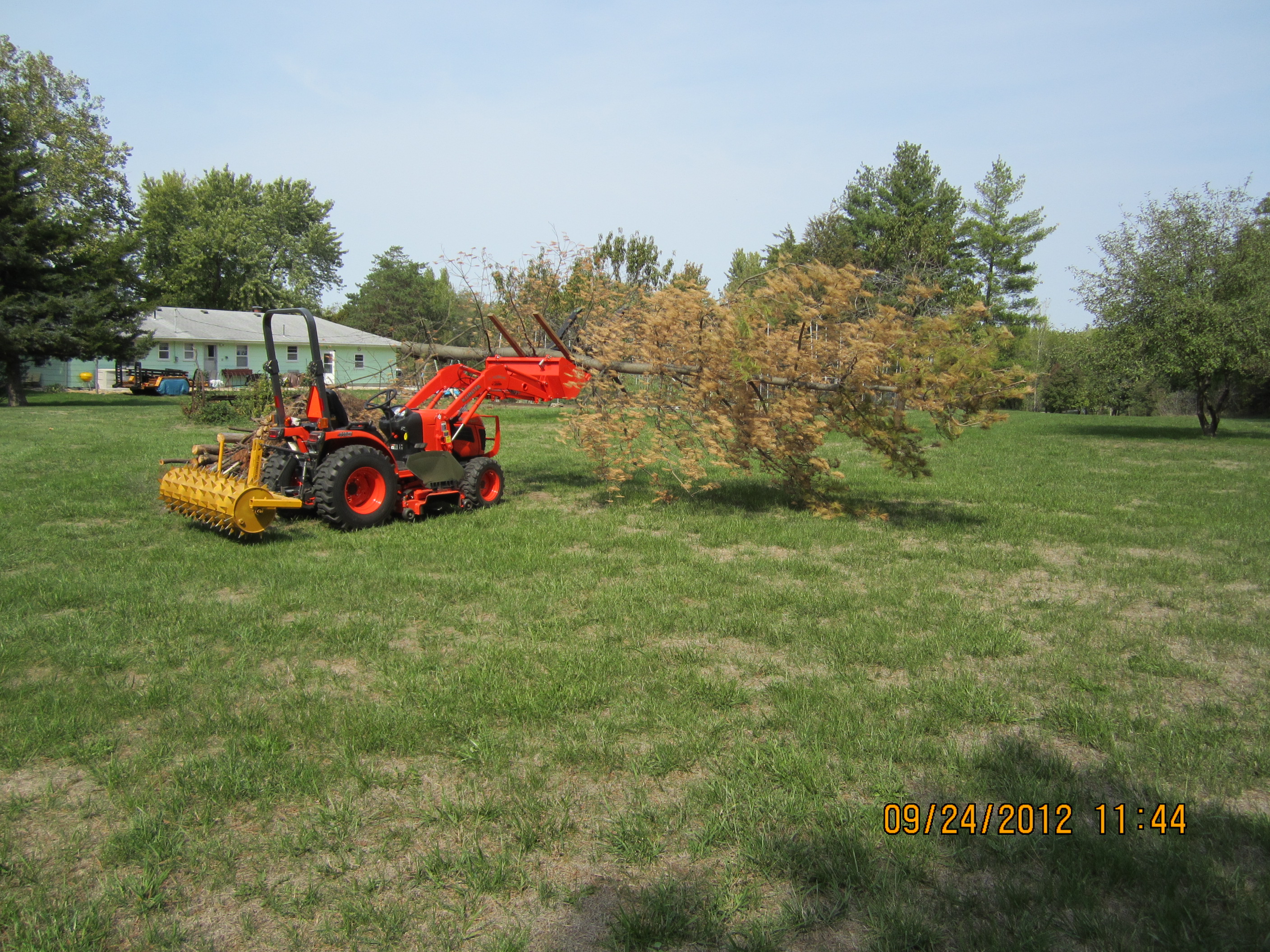

I bought the Leinbach aerator from EA. It works fine for me, but its critics would say that the spoon type is the only way to go due to compaction. 265.JPG
I add about 30 gallons of water which raises the weight from 337 lbs to 440 lbs. In the fall or at other times I drain the water onto a Blue Spruce that needs it. The spikes don't break off or need service. Works great for overseeding. In the attached pic it was being used as ballast for the moment.

I bought the Leinbach aerator from EA. It works fine for me, but its critics would say that the spoon type is the only way to go due to compaction.View attachment 493466
Last I checked, water was @ 8#/gal. 8x30=240. JS.
Geeze, I must have quoted the different build sizes of the Spiker/Aerator as empty. Thanks for the correction.
