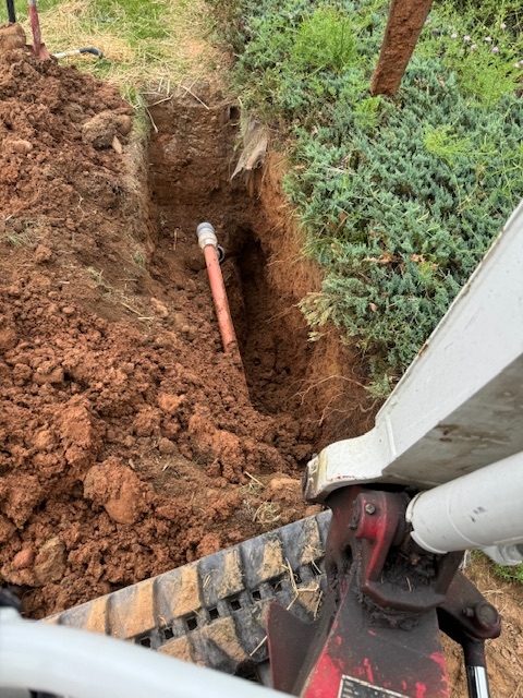

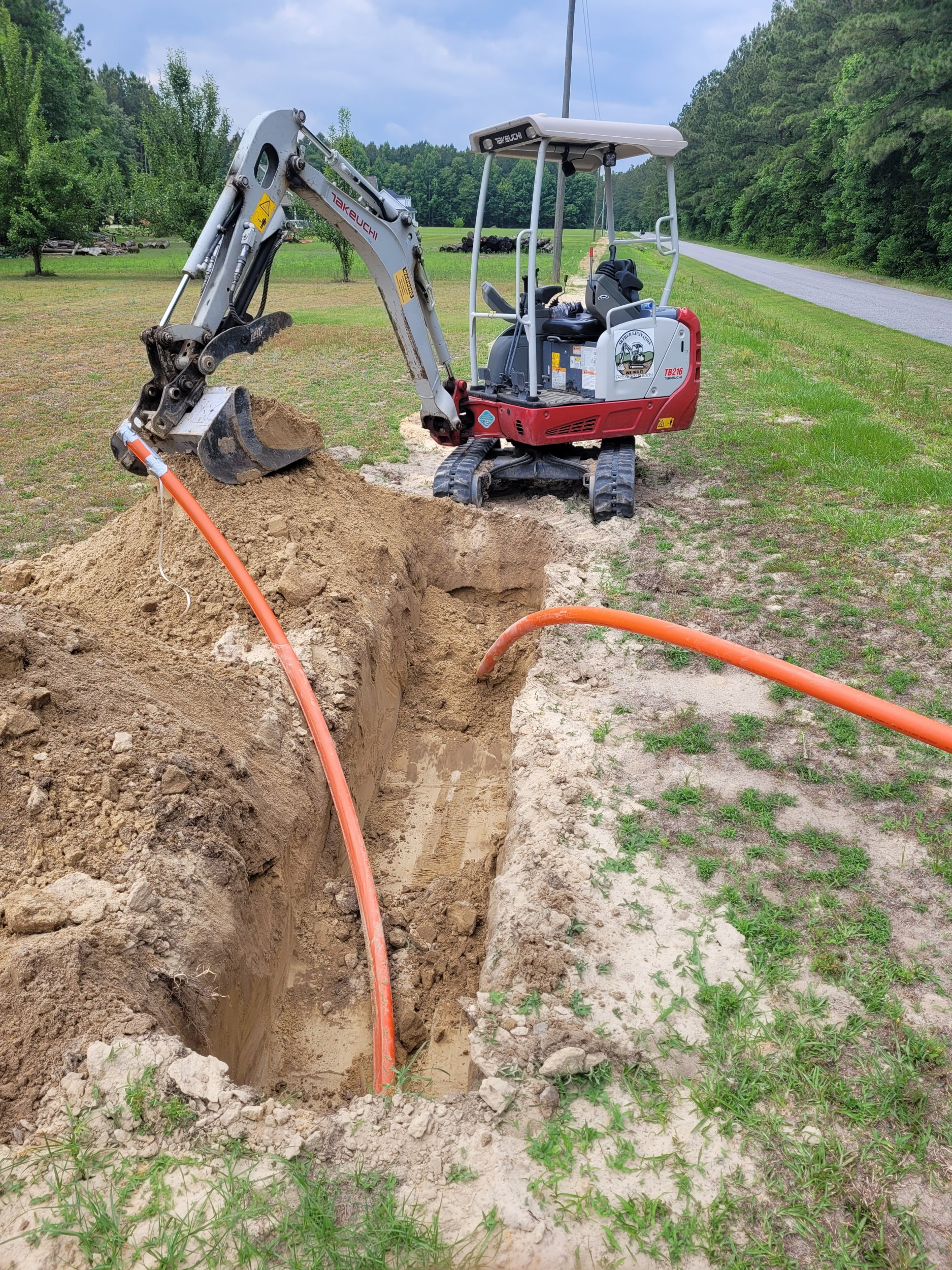

The bucket is so long so I can dig narrow trenches and clean up cave ins like the one in this picture. The long toe will also make it easy to dig under the Verizon main line and drops I have to cross many times during this project.
I rigged up a system that feeds the conduit as I trench if I hadn't done that this cave in would have been a pain to fix. We don't have any natural rocks around here just soil, sand, clay and roots. I'm making the bucket plenty strong so I think my machine will run out of hydraulic power long before this bucket bends.
I didn't come up with the idea of a bucket like this but made my own for a few reasons. It will be exactly like I want, no one makes one for my machine with the tag quick coupler options, saving money and l like making stuff.
Some companies call this type if bucket a trenching fang, some a cable bucket some a deep dig trenching bucket. The point is to dig a deep narrow trench without have to dig wide for the coupler or thumb.
If you zoom in the first picture you can see the cave in. When you trench in at anView attachment 748371View attachment 748372View attachment 748373View attachment 748374 angle because of the ditch it undercuts and promotes this but you have to go where you have to go because of other utilities, culverts, etc. The second pictures shows my conduit feeder. Simple but effective. I just took the one picture of a cave in but it happened in about 8 spots along the 700ft section I did today. If I hadn't been feeding the conduit as I went I would still be out there trying to clean up those sections to the required depth.

Cave in.
Feed shovel lol.
Backfilled and measuring with my co worker.
