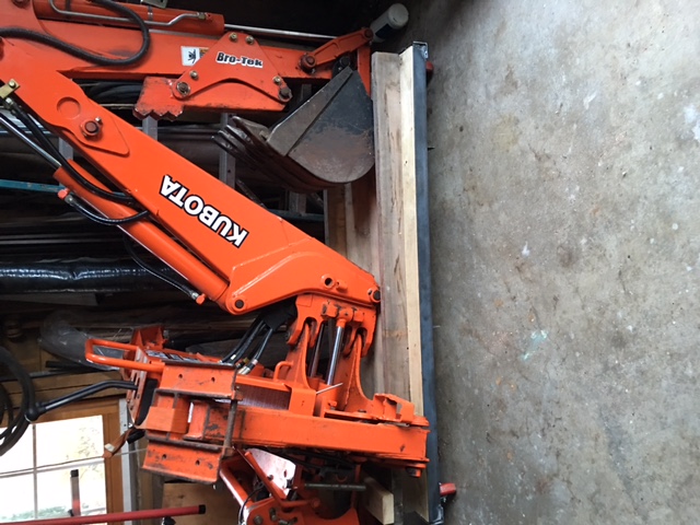

I have R4's as that's all they put on the B21, and where I am on the coast its all rock/ledge and woods so tough on sidewalls. I do use chains on the front - makes a huge difference in traction and control - this is what I have been using for 3 seasons - inexpensive and easy to install. I figure to get 5-6 years out of them so at less than $20 I can buy a few pairs. Amazon.com: ALEKO Chain One Pair of Passenger Car Snow Chain 12mm, Size 7: Automotive As far as Turfs, yes I hear most everyone on TBN they are better in snow as they have more surface area a wider footprint and more traction.
For woods/rock work R4's are the best, and if you are concerned about sidewalls and sticks/stones then go with the R4s. For moving your trailer around - go to HD or Lowes (or ask your dealer) to weld on a receiver hitch on the top of the bucket that you can put in a normal trailer ball, or a hook too.
For brush hauling I use the combo loader with forks and BH Thumb - The loader holds a lot and thumb can grab a fair amount too - that way you dont need to unload the trailer.
