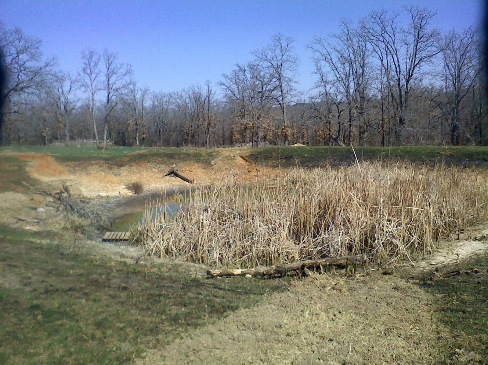

Here is a photo.
2 more month's without rain and I'll be able to jump in with my tractor!

Talk with someone who has experence operating heavy equip. on soft ground.
Years ago I nearly flipped a backhoe in a pond while trying to break a dam. I had the hoe sitting at 90 degrees to the bank. While lifting the heavy muck my outriggers started sinking,,,fast. I had to jam the bucket on the pond bottom to save the hoe.
Your dam looks just like the on I was working on.
Rent the big hoe.

I posted before I noticed your photo, sorry.
I would not have any problems clearing that pond with my mini, nor getting the weed on the bank for later removal. Your experience will give you the answer on what you can handle as far as this job would go. You could also cut a small road/ramp into the pond so the drive down would not be so steep. Eddie is correct digging is the easy part getting rid of the spoils is the pain. I have a ditch bucket on my mini {30" wide with water drain holes} it can move one heck of a pile of cattails in no time. Digging weed is a lot different then digging dirt and IMO easy to get rid of.
