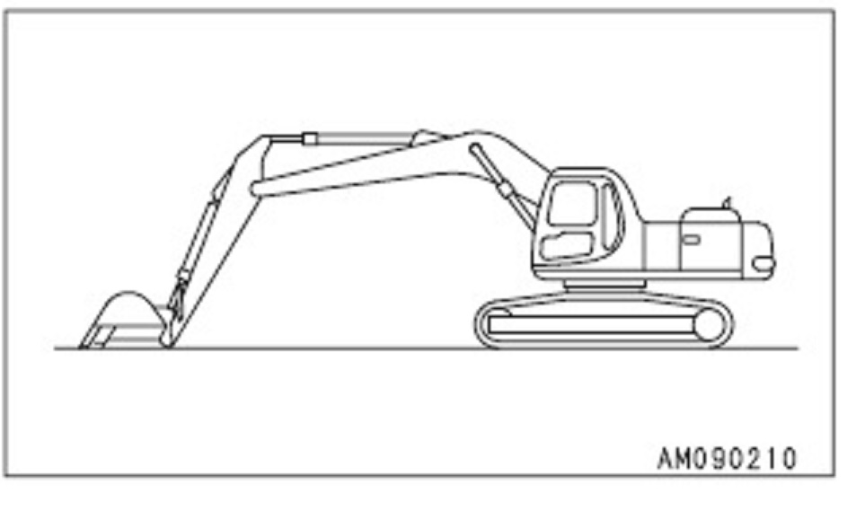

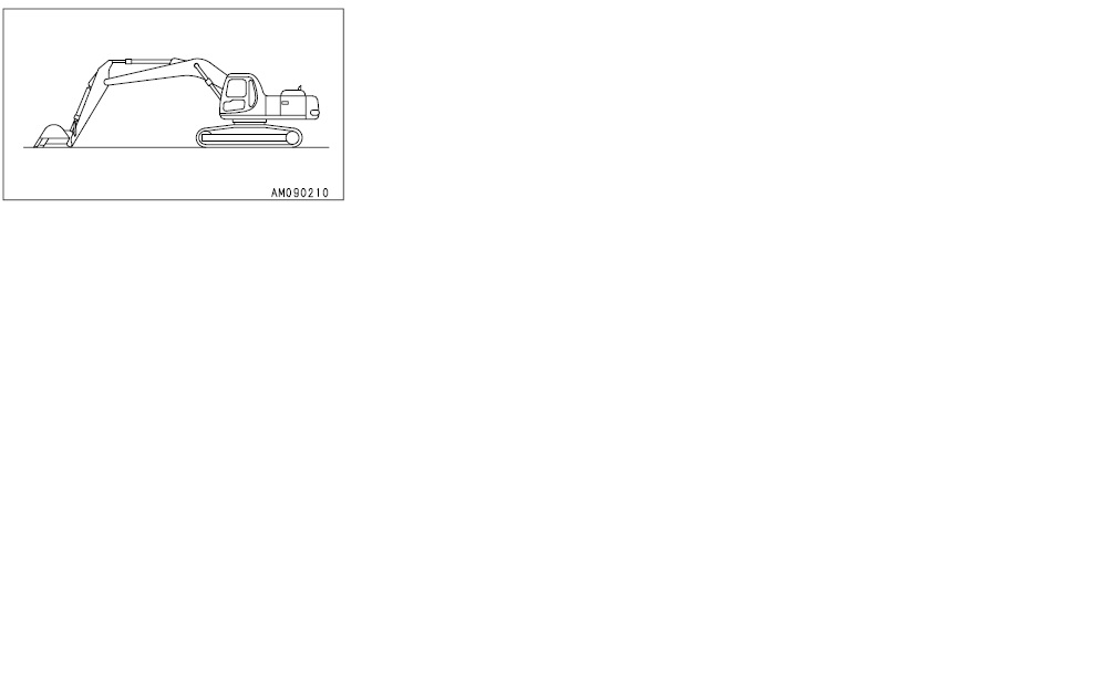

Did you check your manual to determine what position your boom, bucket, and blade should be in to check hydraulic fluid level?
   / Excavator Hyd Hose at Top of Tank
#12
No, I didn't.
I see now this is the position it needs to be in to check the level.
Did I mess things up?
