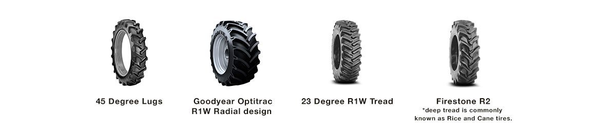

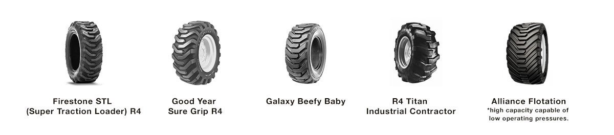

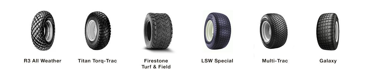

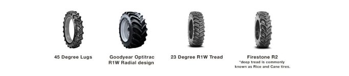

Then you get to the various tire options in the 3 main tire classes (Turf, AG and Industrial). Kubota did an article on that a couple years back with a good lineup:
Turf:
AG:
Industrial:
In the AG line, look at the difference in tire widths, they range from what appears to be 8 in wide to what appears to be 18 in wide. That would make a huge difference in ground pressure and what kind of tracks it will leave.
A tractor driver who doesn't care and isn't being careful can leave tracks with any tire, a good tractor operator can leave almost no tracks with any tire.
