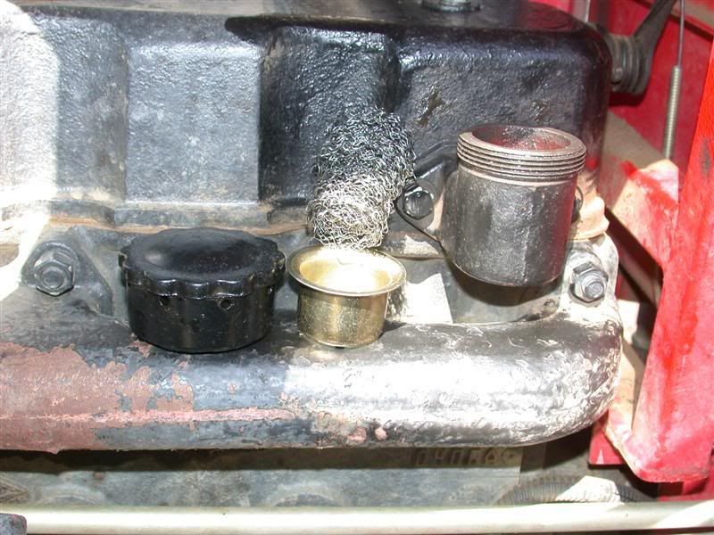

Here is a photo of the oil fill/breather on my Kama 554.
The cap is off on the very left. You can see the breather holes in it. Then there is a metal sleeve with the bottom open (cross hatch) and a steel wool like element that goes inside it.
I am with you guys that the root of the problem is worn valve guides. I think that is a good bet.
There are no water leaks whatsoever and there is no white smoke to indicate that. There is never a radiator water level change, nor does it ever run hot. (Except when I'm brush hogging when the air filter and radiator fins get plugged up.)
Only oily smoke that blows out of those holes in the cap above. You can see in that photo how the right rear of the valve cover gets oily. It's not very much in this photo, buts gets worse by the end of a long day. There is no noticeable loss of power either...but then again I am not positive about that. I haven't done a compression check to see if it could be worn rings though. Might not be enough to worry about after all.
Thanks for all your replies!
   / Excessive Blow-by on Kama 554 #15
My breather is almost the same, you've got steel wool - I've got a fine mesh basket (like in the fuel filler neck). But mine also disassembles farther. The knurled cap comes off the part with the vent holes. Inside is the rubber flapper I described.
//greg//

Yes, I didn't take the cap apart for that photo.
What I referred to as "steel wool" is not really steel wool, it is probably the same as your mesh material.
I was thinking of taking the knurled cap off and adding a hose that went directly to the intake manifold so those vapors would get sucked in and burned up. Most of them should condense on the mesh and drip back into the valve cover.
