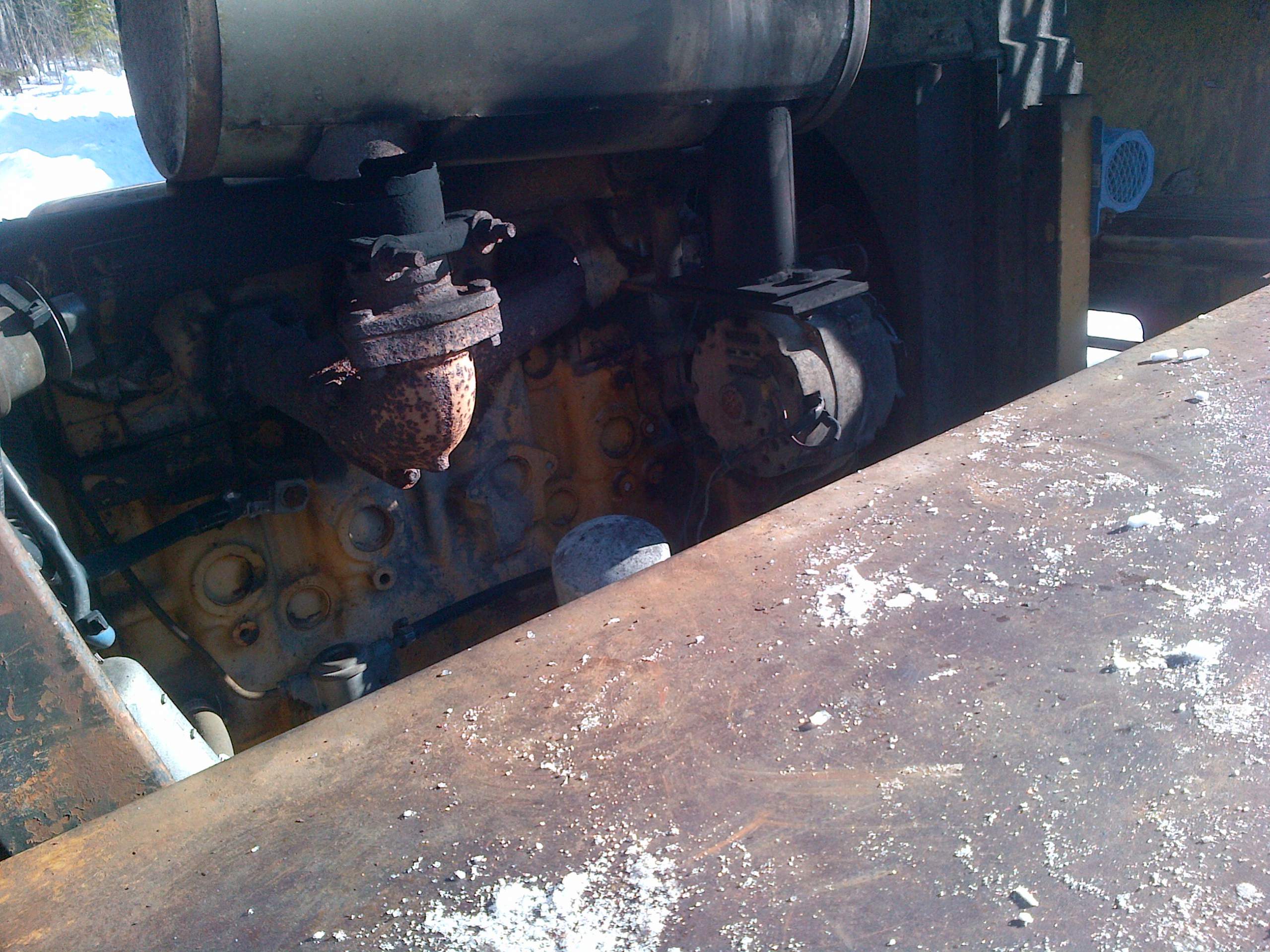

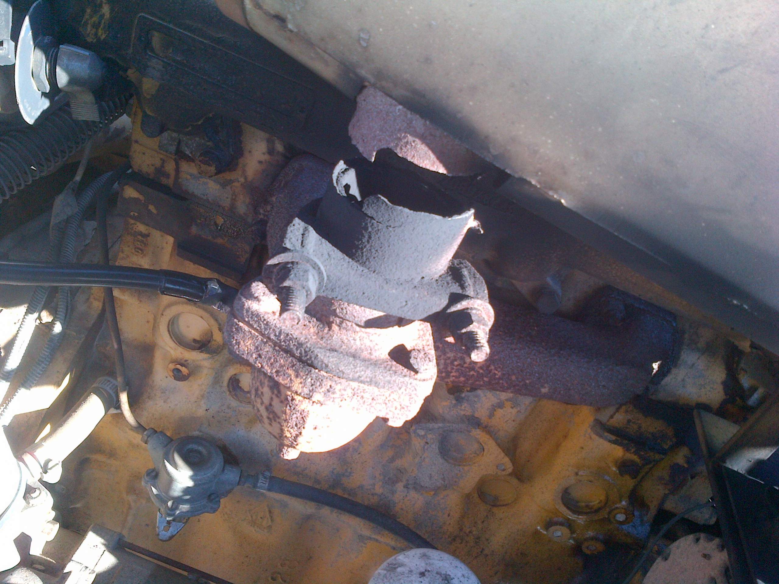

What effect will a broken exhaust have on my engine? (diesel). Will be working to remove the rusted nuts/bolts this weekend to fix or replace...looks like just the manifold to the muffler needs a new pipe..which my friend will weld on (apparently not a job for the monster arc welder lol). It does seem like the machine is down a bit on power...but i'm not the expert.
Thanks to all.

Physically it wont damage anything. But it will be loud as ****. That looks like a fairly easy repair. B.
   / Exhaust Broken: Perkins 4cylinder Diesel: #3
On our Perkins in stallions we had only to test for maximum back pressure, no limit on minimum.you should have no problem running until you get it fixed. It should have no effect on power. Not sure how your engine is located in relation to the op station but fumes to the operator could be your main problem.

Thanks for the feedback.... the fumes aren't doing too much as everyhthing is under the hood on this motor...and it is typically very windy out. (engine behind me on my machine..it's a big ol forklift).
I will get some 'blaster' on those bolts to start the process of loosening them this weekend and see what's what. We have another foot of snow to look forward too when i get up north this weekend,

the johnson bar and some penetrant got everything loose for me., looking for a replacement muffler the 'dealer' wants 550 dollars for the factory muffler. (things line up with an exhaust pipe in the rear cover of the machine). my bud asked if they have aftermarket and they laughed... he found me one for 150. I guess these places need to make some money...but 550 vs 150 is pretty steep.
should be a loud plowing weekend if we don't get the new one before then.
