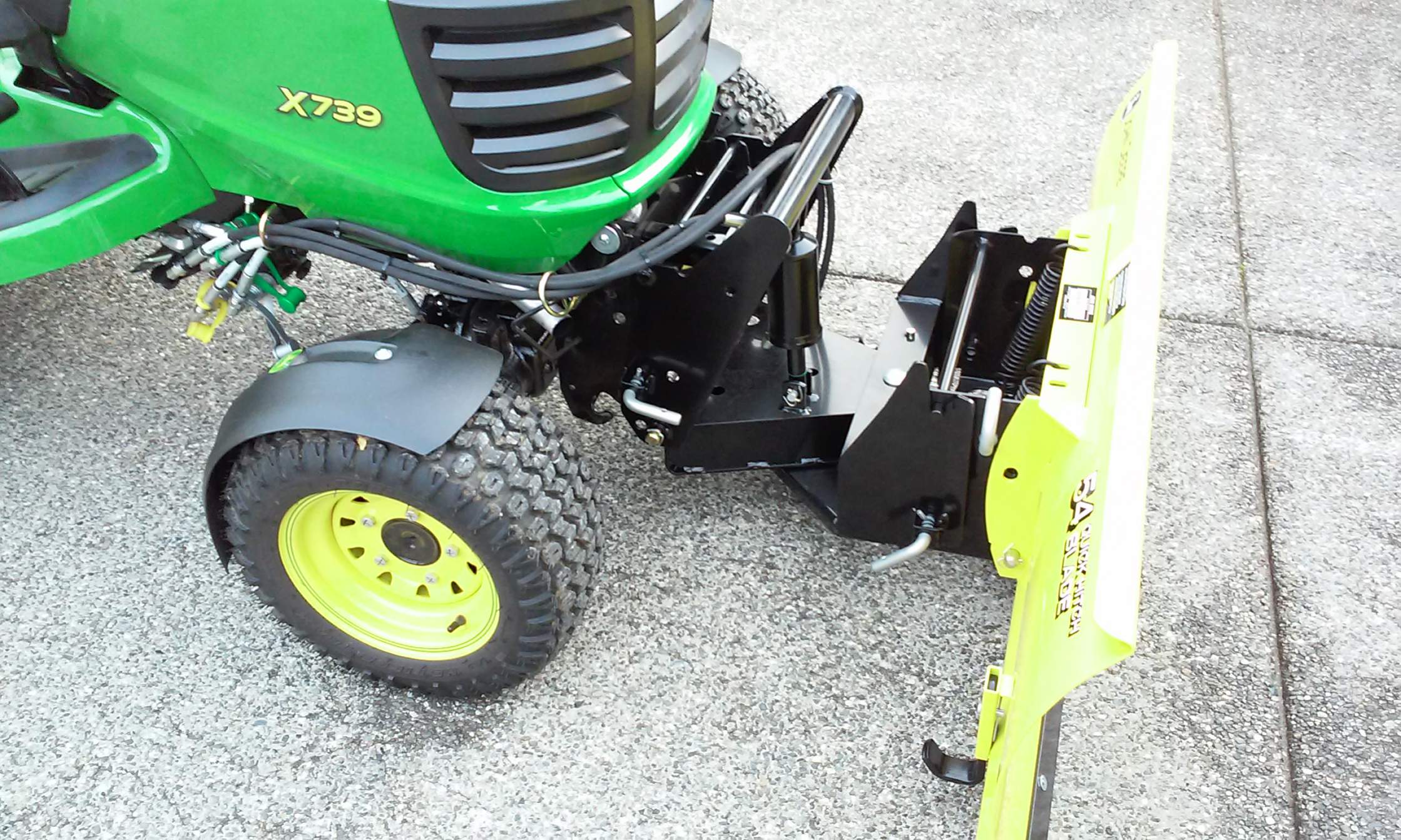

Here is my setup. Since taking the photos I've added a coupe of tie wraps to tiddy things up a bit. Hoses have been good thus far, staying above the exhaust. I know what I have is for the blade, and a retro-blade fit at that, and you have a blower. Might be a bit different, but there should be plenty of places to dress the hoses to prevent exhaust damage. IMG_0066a.jpg

Here is my setup. Since taking the photos I've added a coupe of tie wraps to tiddy things up a bit. Hoses have been good thus far, staying above the exhaust. I know what I have is for the blade, and a retro-blade fit at that, and you have a blower. Might be a bit different, but there should be plenty of places to dress the hoses to prevent exhaust damage.<img src="http://www.tractorbynet.com/forums/files/john-deere-lawn-garden/402816-exhaust-extension-img_0066a-jpg"/>
Hey Gittyup, is it just me, or does your plow mounting frame in the right side of that pic have an enormous crack in it? Sure looks like it. I'd be welding/reinforcing that ASAP if it were my machine.
/ Exhaust extension #9
That's water or oil running down the side. Sure does look like a big crack at first glance!
/ Exhaust extension #10
Here's where the hose hangers should be located, one of them just above the exhaust. Installed per JD front hitch installation instructions.
These photos show the location without the hoses, you can see the wire loop is attached to a hole in the frame just above the exhaust:
/ Exhaust extension #11
I don't know, I swear I can see through it. I'm voting it's a serious crack. I would think the rod would fit closely in the cutout. As it sits, there's 1/4" of clearance on either side of it, with a 1/2" crack traveling down.
/ Exhaust extension #13
If you can expand on the pic, it looks more like water than a crack. If it is a crack, he's got issues....
Not cracks anywhere. It's melting ice, dirt, and just old (1994) with original paint. But there is nothing that affects it's function or strength. One of these days I may paint it.... but then again, why?
