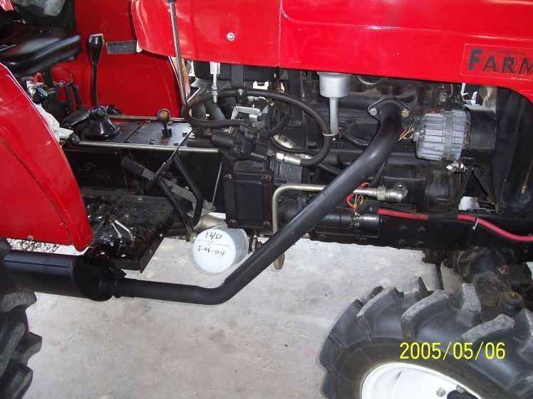

In the past, there have been discussions on the pros and cons of downsweep exhaust systems. We decided on the downsweep exhaust due to tree branches as well as the noise. So we went to the muffler shop, and got one ninety degree and one forty-five degree with long ends, two hangers, and a weld on manifold flange. Brought the pieces home, measured and cut, welded it together (and for you old timers - before the days of Mig & Tig welders, we welded it together with an acetaline torch & steel rod. We're not good at it, but it's together. Thank heaven for a grinder and good paint!) Then I installed an oversized and Ugly muffler. I'm very pleased with no exhaust noise - though I still have the diesel rattle, but the noise level is greatly reduced. P.S. We did save the old muffler in one piece, so it could be put back on the tractor. If interested, please see attachment. Yugo

Good job, nice, clean and professional looking.

"We're not good at it"???? What are you complaining about?
Thats a nicer looking job than the factory down pipe..

Yes, very nice, you taking orders? Notice you have a filter on the suction side of your hydraulics, has that caused any problems with pump cavitation, etc?

I like your down pipe better than the factory setup. It's clean and simple.
I ordered the downswept pipe with my tractor and discovered that it wouldn't fit with the FEL in place. So, I had to have a shorter manifold pipe made at a local muffler shop.
Take a look at the attached picture.

Hey, Billbill1 - I do know where you live. I made this exhaust system wide to clear the starter and hydraulic filter, so there wouldn't be any heat transfer. Probably wouldn't work with the FEL. And for the price - approximately $70, includes the $29.95 ugly muffler. Sure wanted one of those polished stainless steel Honda Zroom mufflers, but going for less noise, we opted for the Ugly muffler.

I initially set mine up in the down swept position then had to flip it up so I could mount the FEL. All that noise and breathing the exhaust was quite a contrast. So I had the new manifold pipe made for $30. Not breathing all that diesel crap is worth 10 times that much in my opinion. After using the tractor for a few hours, my lungs felt scorched. Now, I'm breathing clear air. /forums/images/graemlins/cool.gif

Bluechip - I'll try to answer your question about the hydraulic filter. It's still in the testing and experimental stage. I installed it a year ago, at 140 hours on the tractor. We've just rolled over to 300 hours, it's ok so far ? We know enough about hydraulic systems to be dangerous!! I worked on forklifts for 30+ years, and we know you're not supposed to put a filter in the suction line, BUT we did remove the filter screen in the hydraulic tank to eliminate that hassle. I'll change the filter out way early, and open it up to see what's going on inside the filter. If the pump dies, I will be sure to post my OOPs. Thanks for asking - Yugo

Truechaos - To make a long story short, hydraulic filters are supposed to be installed in the return line not the inlet, or suction side. Any restriction will hamper the volume of flow to the pump. Normally, the rule of thumb, is the inlet to the pump is three sizes the diameter of the output, but these Jinma tractors are smaller than the norm. I'm not sure how they get away with using such small inlet tubing. But the punchline is: be sure to keep the screen in the hydraulic tank clean, to avoid any restrictions so the pump doesn't self destruct. Now that I have exhausted my knowledge have a great day. Yugo
