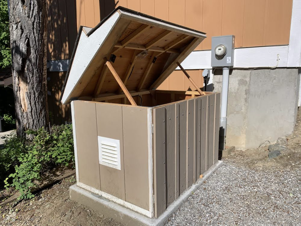

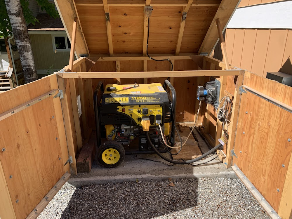

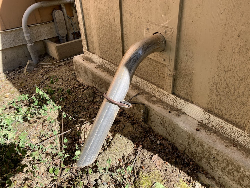

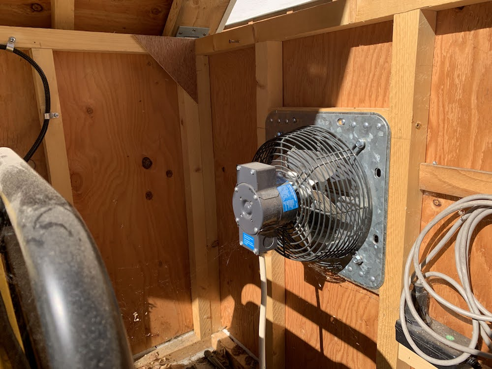

I have a similar setup (see pics): 9K generator, 3.5' x 5' x 4' custom enclosure, wood-frame/plywood-clad, with cross-ventilation intake and louvered exhaust fan for heat. For the engine exhaust, I was able to get a piece of 2.5" exhaust pipe bent and flared to go over the exhaust exit on the engine (no mods!) and have been running it for 3 years. Ran it earlier today for a few hours during a planned outage.
From the outset, the heat generated by the engine and generator was too much for the fan - the temp-cutoff stopped it. Any 2 of the three doors (flip lid/roof and one of two barn doors) open during operation is enough to keep it in operating temp range. I was going to try to insulate the enclosure to cut noise, but once the operating configuration was determined, there was no point. Fortunately, the non-open part of the enclosure faces the house so a fair bit of clatter is cut away. Up to 10-15db.
For the engine exhaust, the flared pipe is plenty for the smaller engine exhaust to expand into. To deal with the pipe passing through the wood structure, I made the passage hole in the wood siding larger than the pipe and lined both inside and out with cement-board panels, cut tight around the pipe. The unit has run like this for almost 40 hours with no ill effect to the wooden materials near the exhaust pipe. The thing sounds kinda throaty (think baby Harley..) and I will be addressing some of that with a small rock pit for the exhaust to push into for some sound reflection breakup.
I think any small enclosure will be a problem to vent enough to keep cool while closed-in.

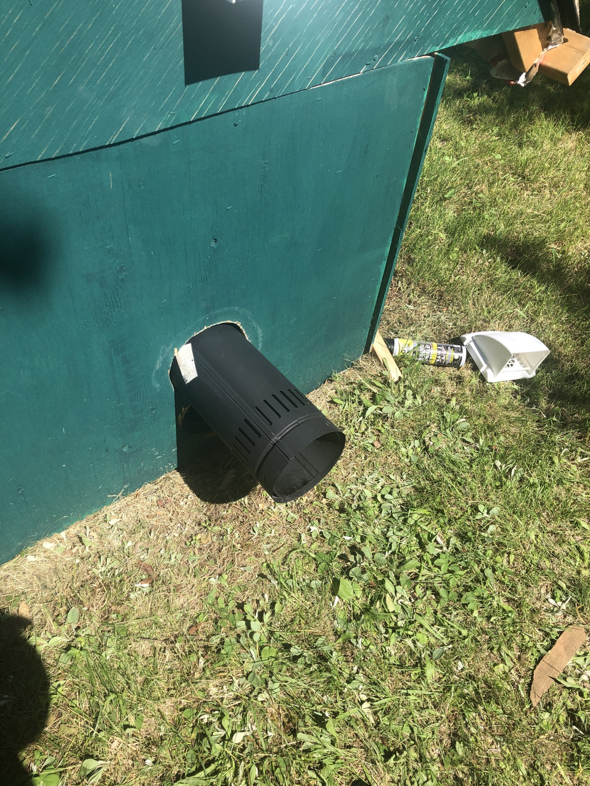

Thanks, grs - will use double-walled stove pipe. I looked over the generator again, and it turns out that the exhaust is only about 2 inches across. so, putting it in front of a 6 inch stove pipe should be sufficient. And I do not plan to use an exhaust fan after all. Just six dryer vents up near the top of the gable ends.

Got a length of double-wall stove pipe, and it is sitting right on the exhaust pipe. Will attach it with a couple of L brackets, and put some more vents in at the other end.
