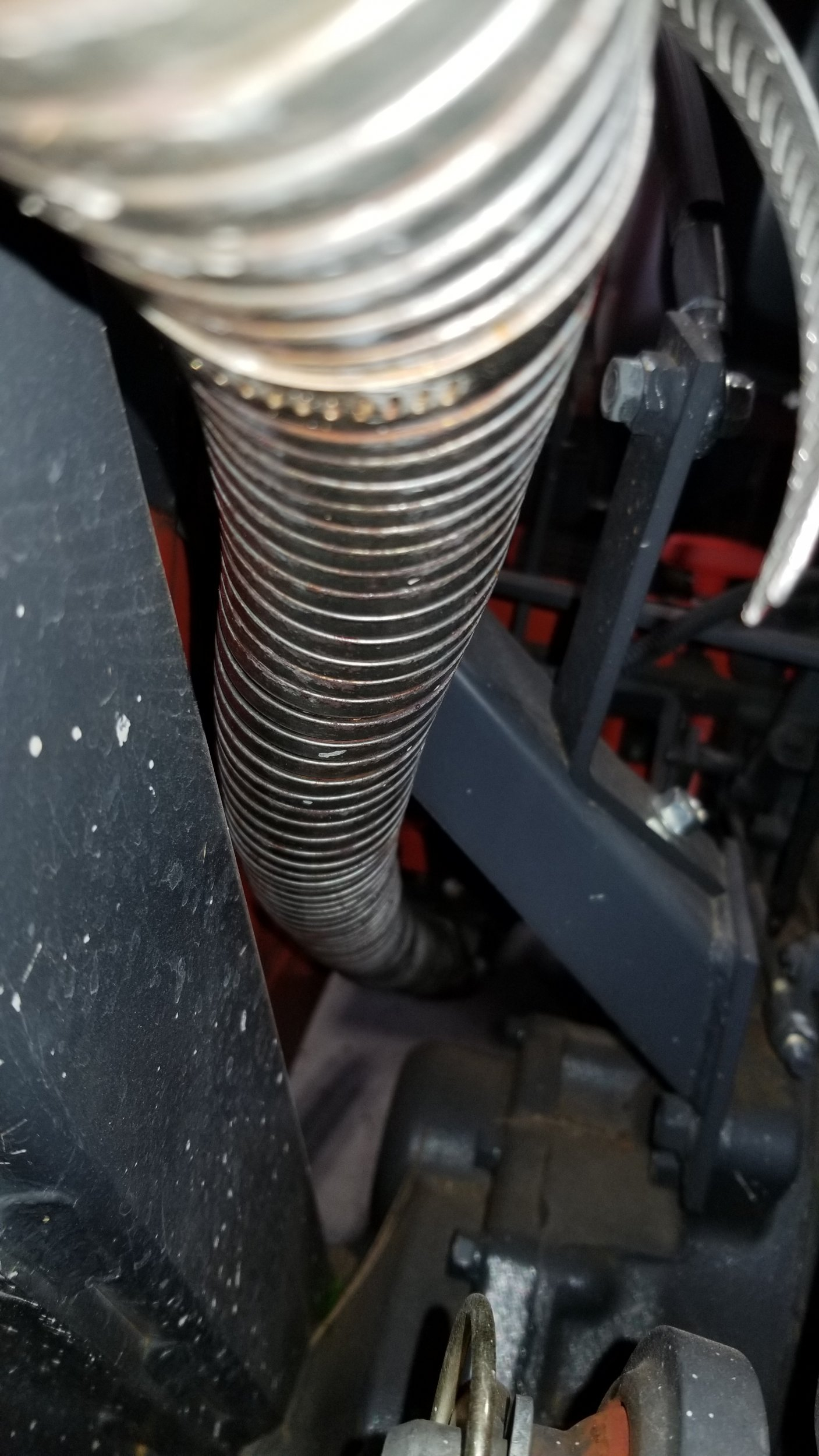

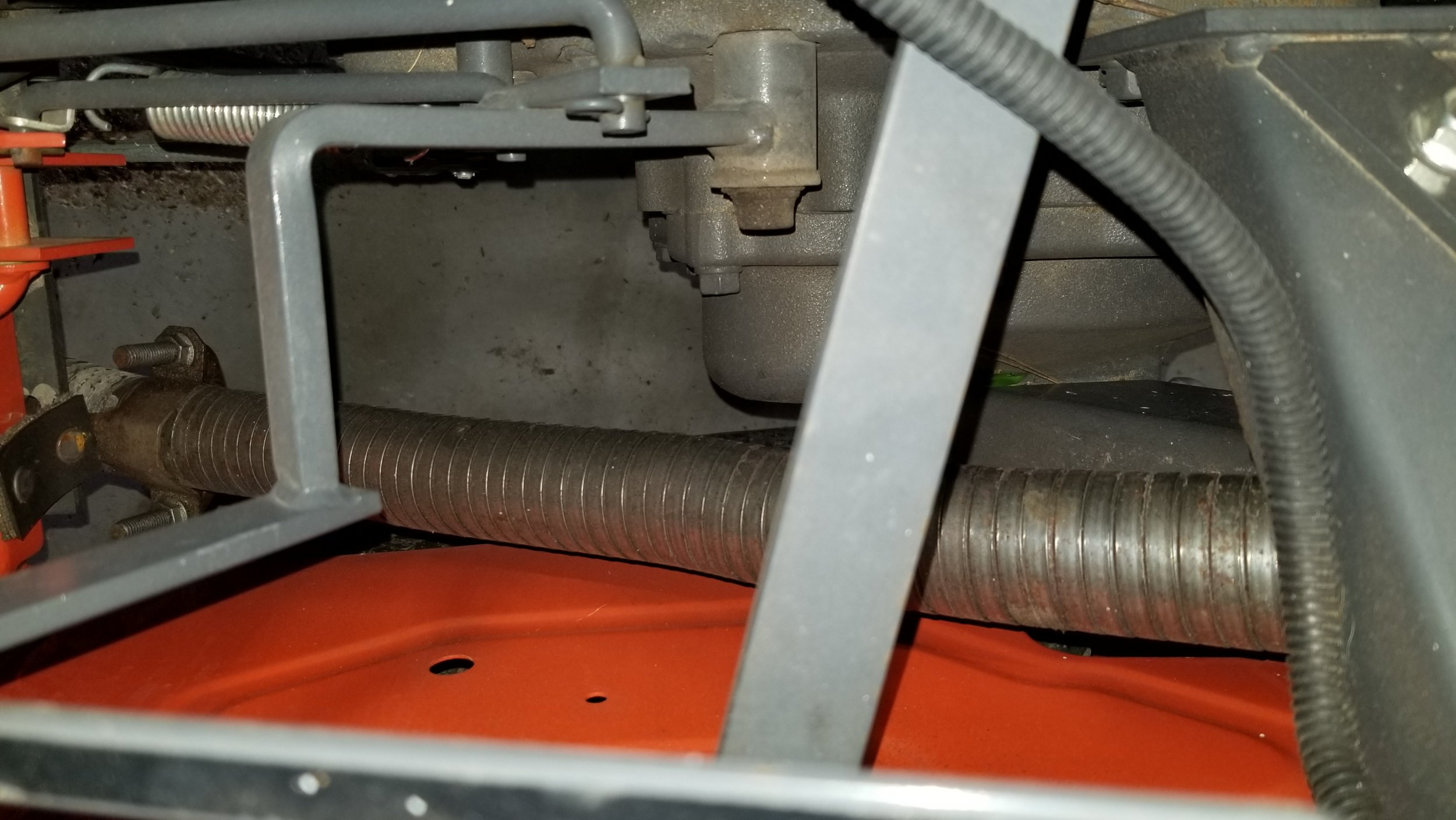

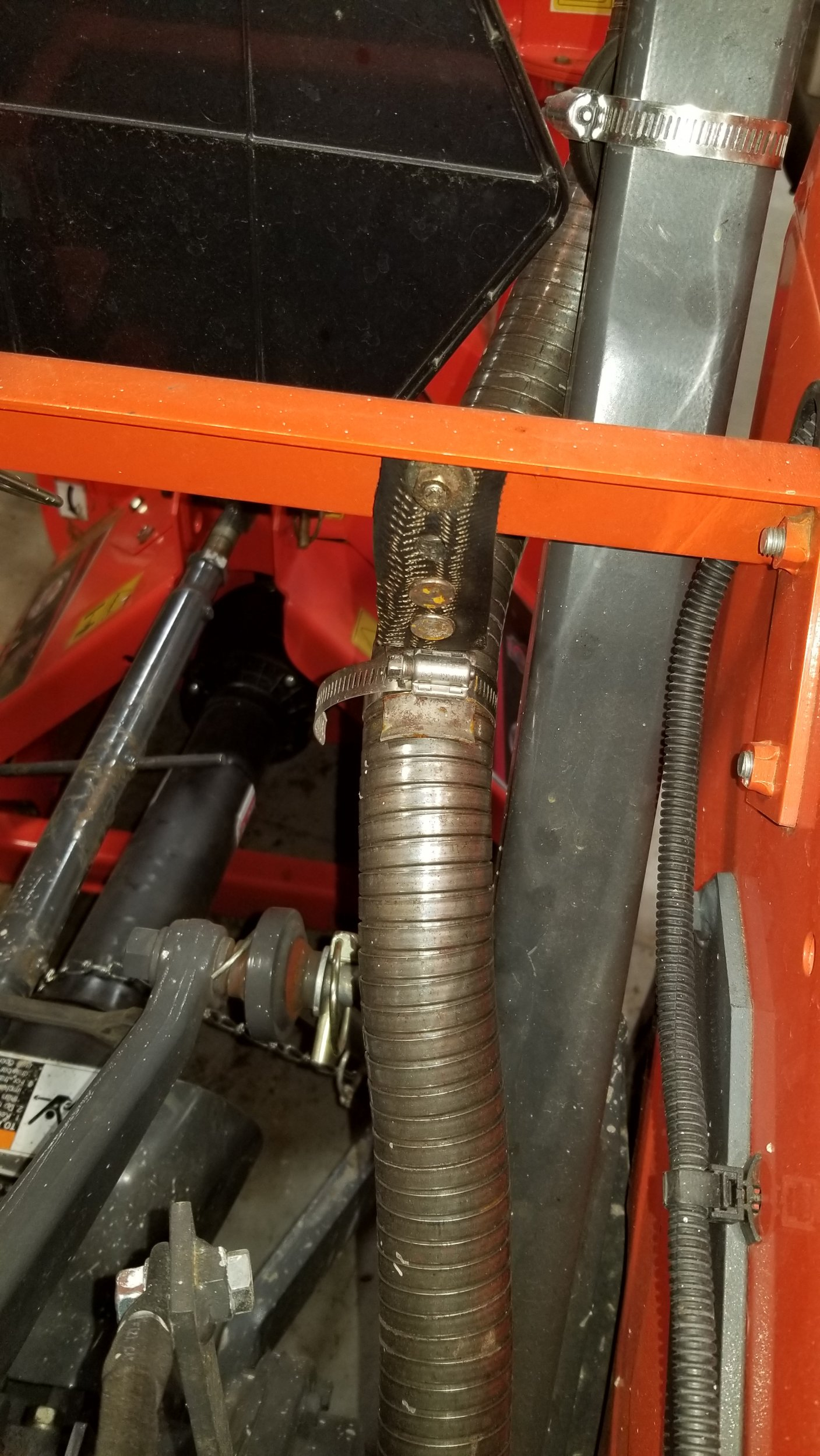

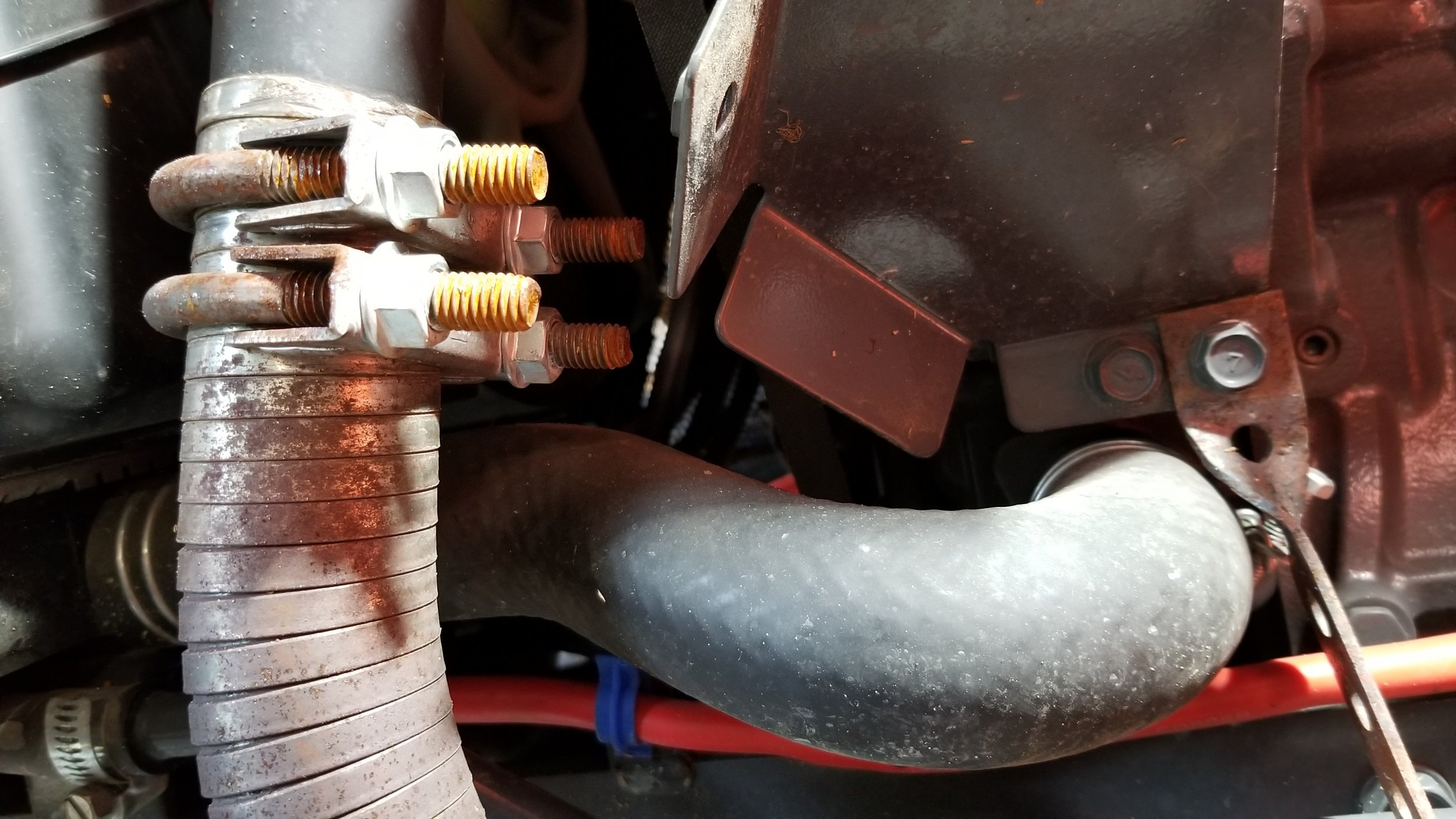

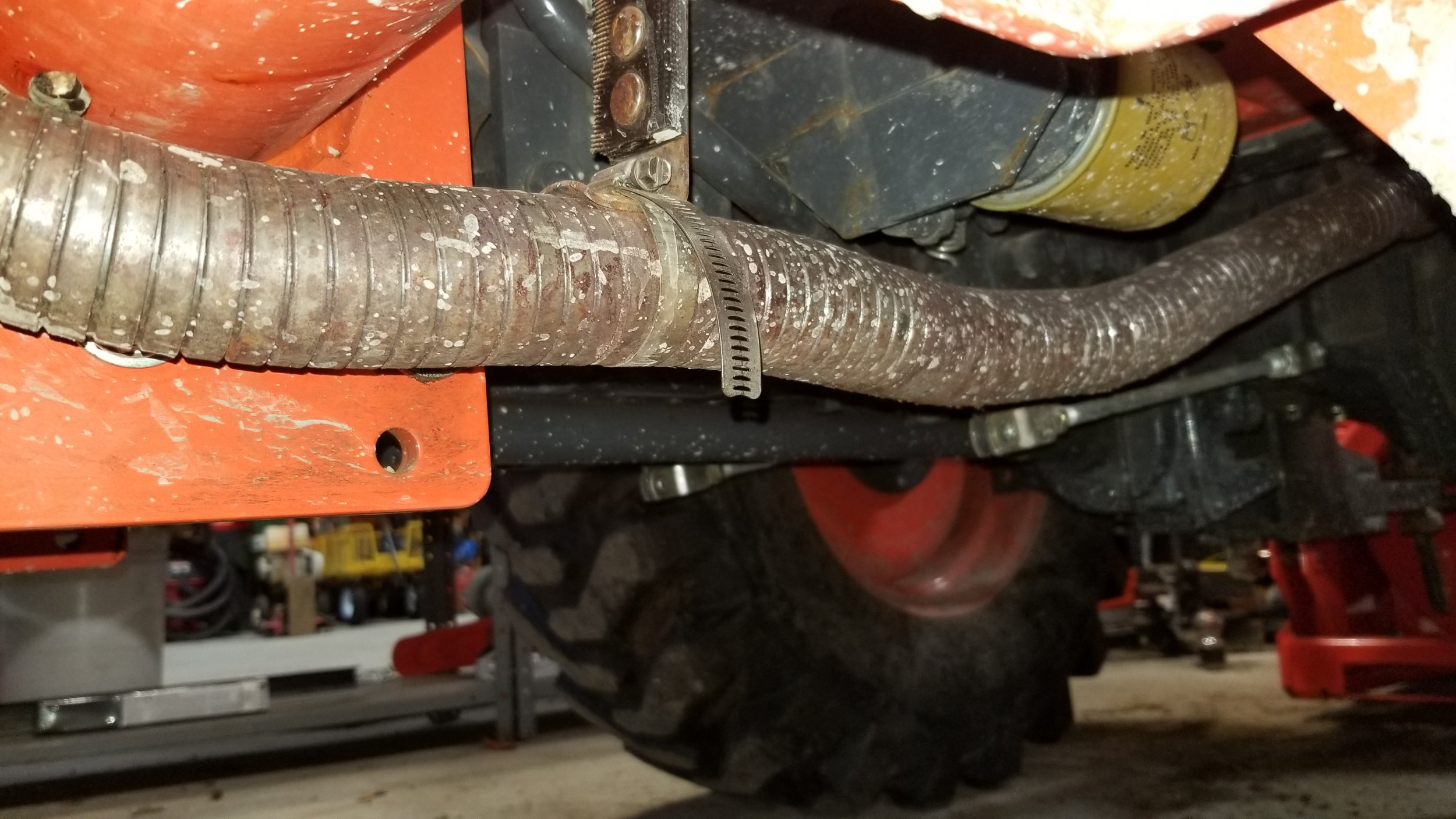

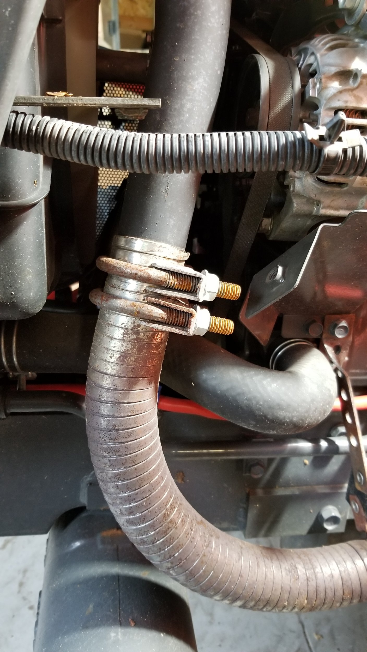

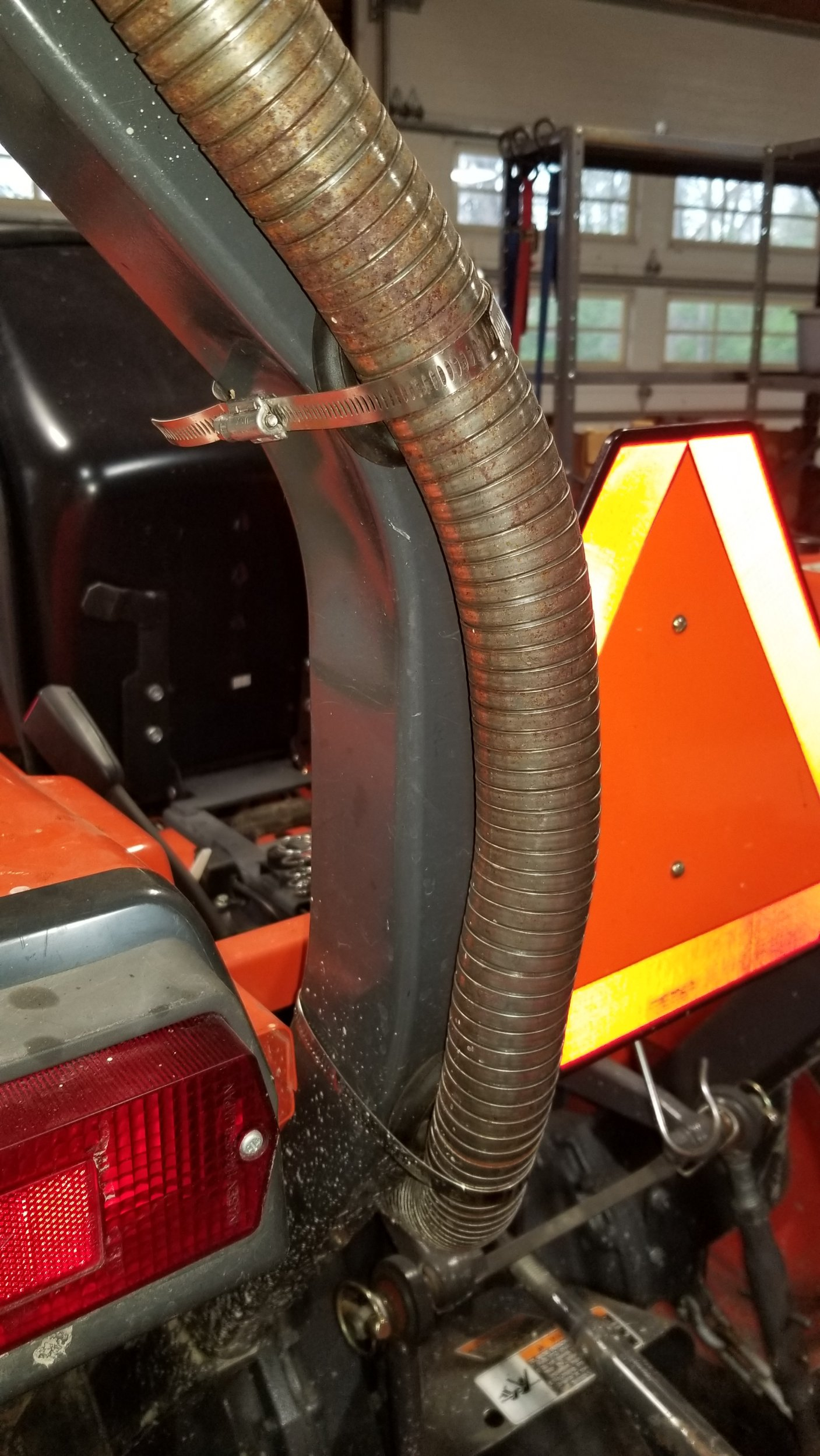

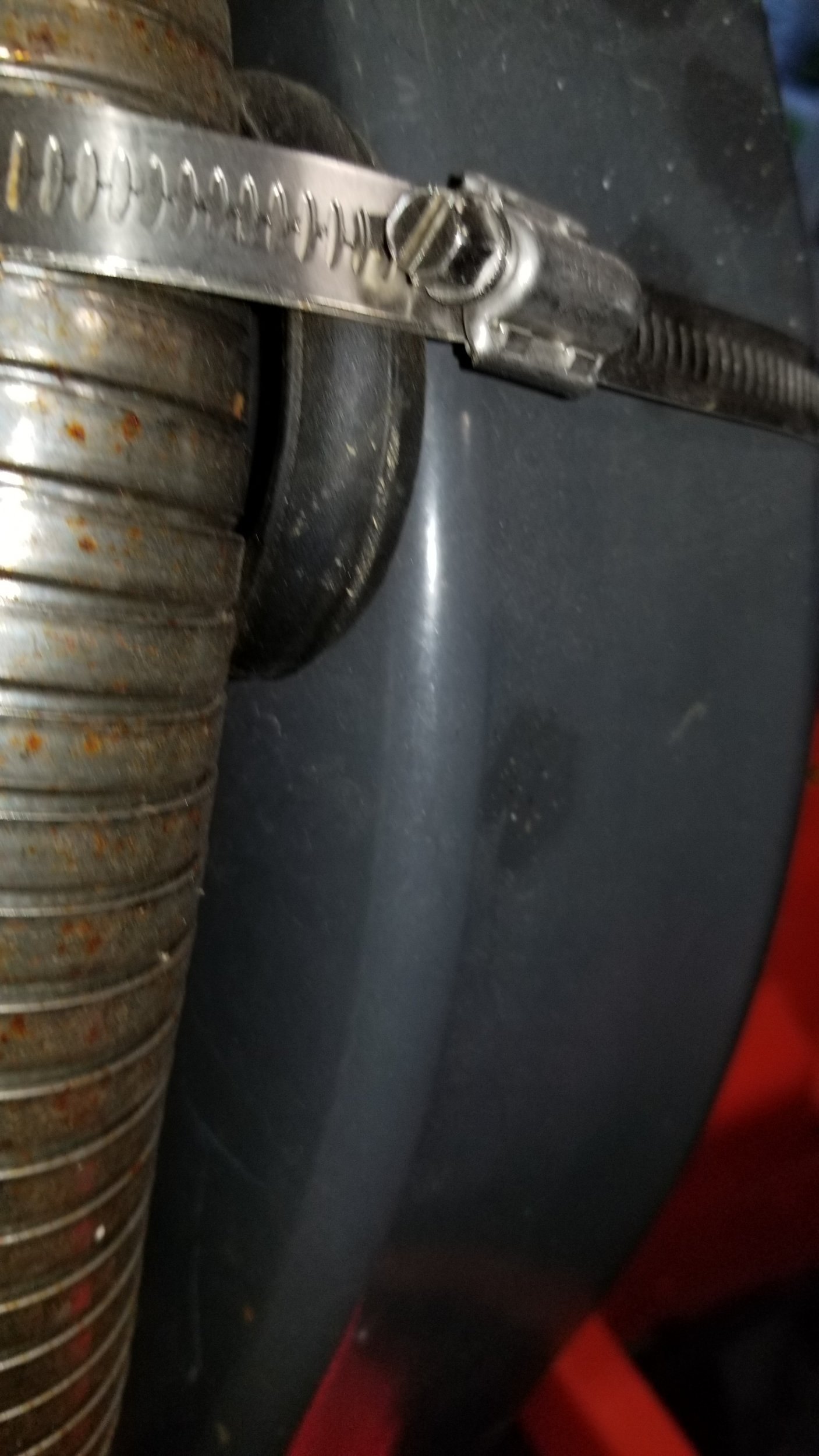

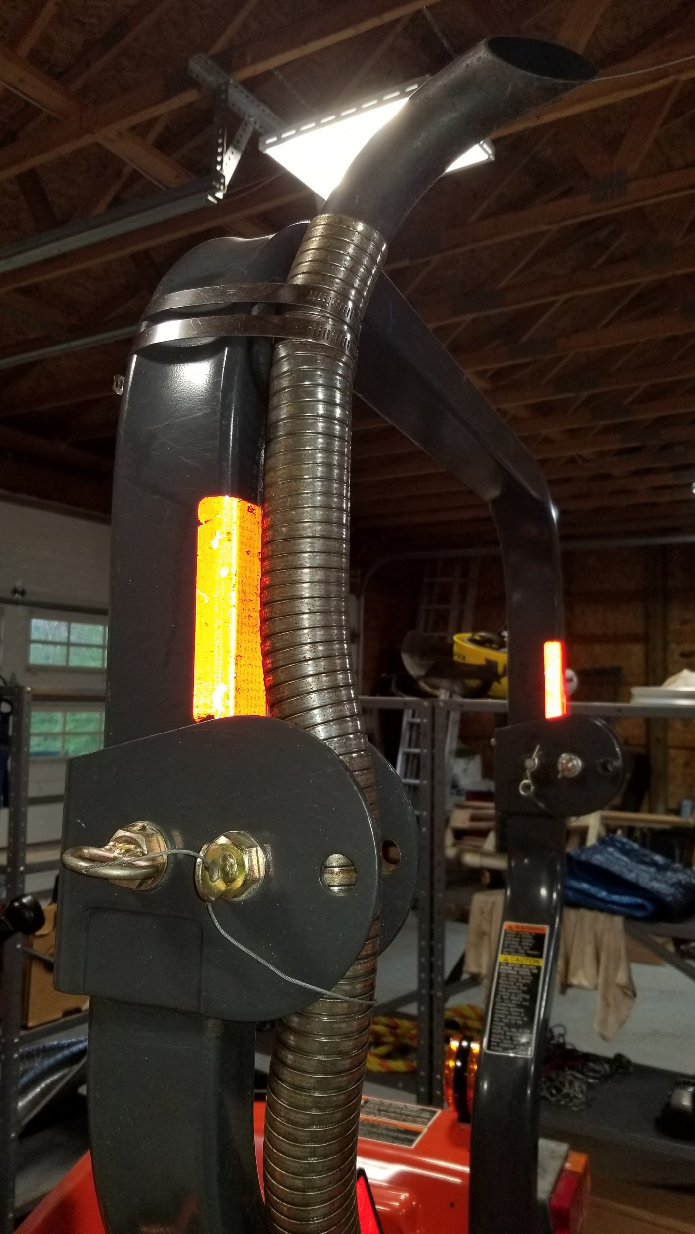

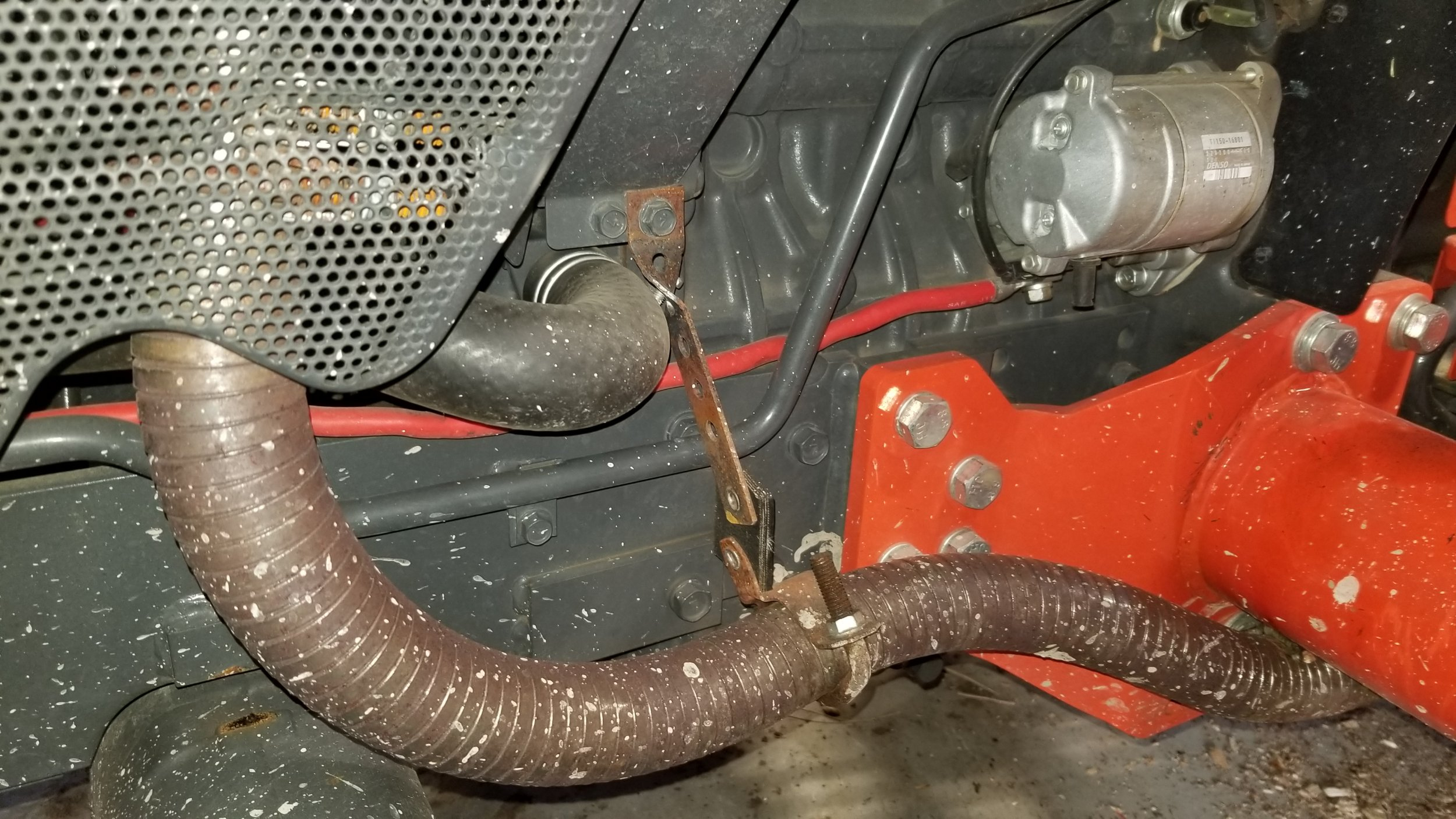

Here is my solution to moving the outlet of the exhaust. I'll have to take the panel off to show you how I mounted it on the existing exhaust pipe but I can tell you that I cut a length of the original pipe off so that it would give me a nearly straight down exit point from which to tap onto with a clamped flexible tubular exhaust. I used 2 clamps. And then I just routed around underneath and kept it away from fittings and other pieces of metal or plastic. I used flexible exhaust mounting hardware and hangers so that the pipe can vibrate on its own and not touch anything else on the tractor. I didn't want anything banging or getting too hot blistering paint or anything like that. I used stainless steel hose clamps and silicone rubber grommets for mounting to the ROPS.
I've had it on here now since about two or three weeks after my initial post so that would be about 3 years now. It's worked very well it's much quieter. The exit exhaust that I cut off, I put that piece at the very top as an exhaust tip. Keeps the rain out.

Pks, this is great. thanks for the great photos. what size flex pipe did you use. Because the stock exhaust pipe coming off the muffler is oval and not round, i cannot get the OD measurement to know what size metal flex pipe to buy? I can find 1 inch ID metal flex pipe but not sure if that would be too big.
Also, can you take a picture with the panel off to show how you mounted it on the existing exhaust pipe?
Thanks in advance

Wrap a piece of string around the pipe, cut or mark it where it overlaps and measure the length, then divide by 3.14 to get the equivalent diameter for a round pipe.

I cut the original exhaust pipe slightly before it began to bend so that it would be for the most part a straight shot for the new exhaust pipe flexible tubing. I used 2 clamps to ensure that vibration would not rattle the connection loose. I don't know what size pipe it is, you will just have to measure yours and go to your local auto parts store. I went to O'Reilly's they tend to have cheaper stuff at cheaper prices.
The exhaust extension pipe was about a dollar a foot I think. I remember it being inexpensive. I think I put on 15 ft and I purchased an 18-foot chunk. I have seen this same exhaust pipe aluminized, for sale on the internet for $10 a foot. So be wary of where you source this flexible tubing.

Perfect! Thank you very much. This will be the solution to not breathing diesel exhaust all 8-10 hours of a day while working food plots. I think I am must going to run mine under the tractor so it shoots the exhaust behind the tractor versus out the side where it blows right up into your face. Its crazy nobody sells a mod for this, seems like it would be a common problem.
I am going to try 1.75 inch walker flex muffler pipe with a couple clamps and see how it works.
