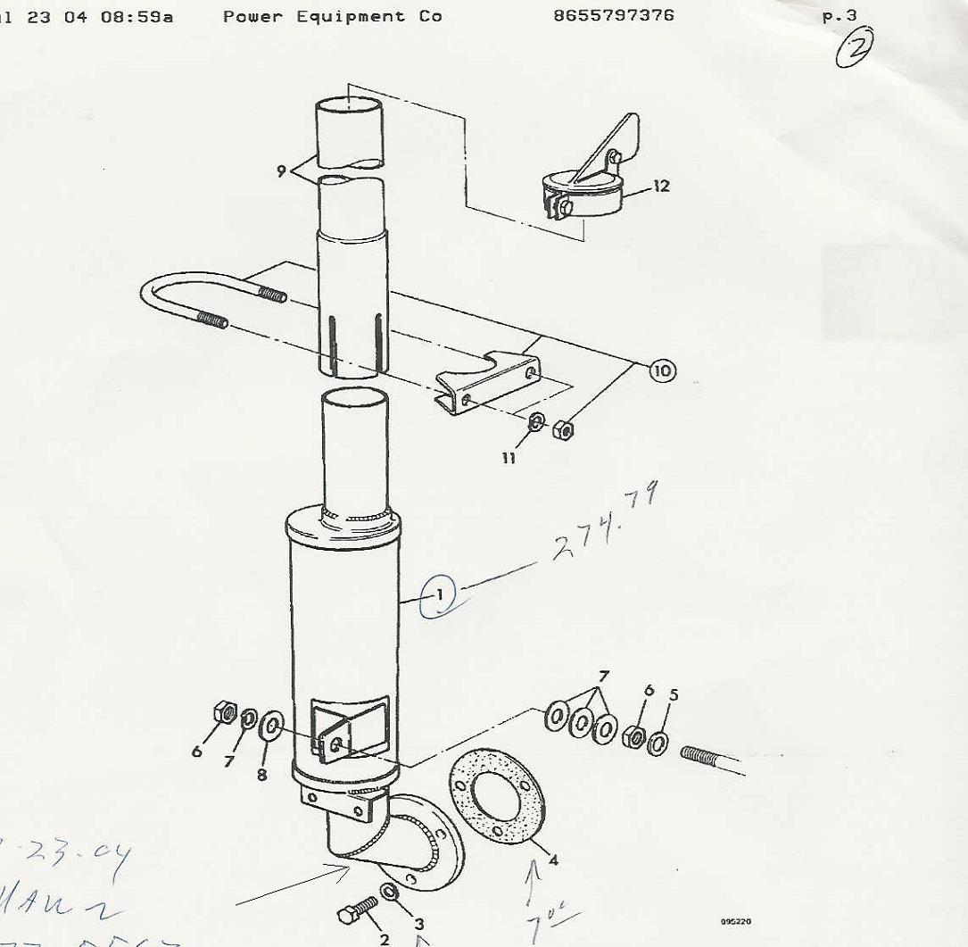

whoo hoo, I got it to scan.
In the pic, part 1 is obviously the muffler assembly. It is attached DIRECTLY to the output of the turbo with #4 in between.
I tried to draw an arrow at the "corner" of the muffler pipe to illustrate where it broke COMPLETLY through. Again, it's not a hole, it's a rotting of the pipe, so the pipe isn't very strong there.
As the muffler assembly turns north, it pops through the hood where the tall exhaust stack (#9) slips on.
The parts (muffler, bolts, gasket) are all ordered. You will notice a 7.00 pointing to the gasket... yes, that's $7.00 for what is probably a piece of cork /forums/images/graemlins/frown.gif
None the less, I just bit the bullet. When it comes to maintaining things, I usually try to do them 100% right rather than cut a corner and have to do it again later.
Hope the diagram helps a bit /forums/images/graemlins/grin.gif

Richard,
Thanks for the picture, it helps.
You ordered a muffler? Was it bad, too? That's where you're getting into the $$.
The gasket wouldn't be cork because of engine heat, probably asbestos (?)
If you can get out of the muffler purchase because it looks okay, you may be able to save about $200 by going to a muffler shop and get them to fab something or weld the bottom of the muffler (braize?) if the pipe has broken off it.
Of course, that is only if the muffler is okay.
Yeah, I know it's more work and will be a hassle, especially to drag stuff to a shop, but you stand to save real $$. If the hassle factor is greater than the $$ issue, then go for it. Been on both ends of that stick /forums/images/graemlins/grin.gif
By the way, you do have the flap on top of your muffler, right? If it isn't on or is damaged, that's a prime cause of the problem you mention.
Also not running engine long enough to get hot and "dry out" the muffler can cause it. Same with cars. That's why the perfect condition "little old lady" car with very low miles has no exhaust- moisture.
Let us know what you decide and how it works out.
Oh! - Make sure you don't hurt threads (#2 in your pic) when reinstalling the bolts. It's easy to cross thread with the weight of the muffler on it. Try putting in your support bolts on the muffler, but don't tighten them until everything is started. Be prepared to replace the bolts if they are rusted...

ok, I'm putting my cylinder escapade behind me & have a question on the exhaust.
Now I see the larger picture, just so you know what I found...
Evidently a long time ago, the muffler needed replaced, they torqued a head off a bolt and left the thing on being held on by the 2 remaining bolts. They then WELDED a galvanized waterpipe nipple, something like 2"x4" to the TOP of muffler and that's what the stack pipe connected to.
Fast forward to today, pipe is broken, so needs replaced. The other bolts would also NOT come out (even after DAYS of PB blaster) so I just got done grinding the head off 2 bolts and took all off.
I now have 3 studs sticking out of the exhaust port of turbo. I've been soaking them too with PB blaster.
They are (so far) NOT budging.
I'm using vice grips to TRY to grab them.
Any ideas...
Heat? (directly on exit side of turbo???)
I've "tapped" them to hope to loosen rust some.
I've soaked PB blaster onto BOTH sides of them
I can't use them as "studs" per se, because they will only be FLUSH with the new pipe & not extend through, so they have to come off somehow.
I think if I try to remove entire turbo, I'll have more of same with it's bolts.
ok, I'm ready for ideas. Once I get the 3 out & clean the threads up a bit, I'm ready to put it ALL back together.
