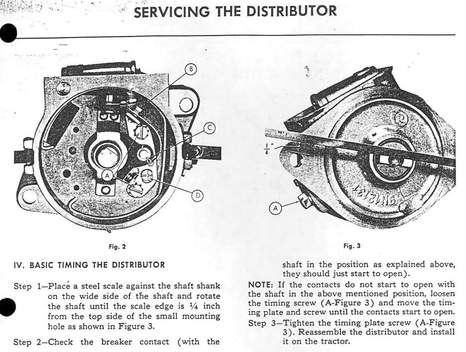

Do you remove the distributor to tune or maintain it?
   / Exhaust popping, losing power when hot #14
Valve or spark timing. If you set the point & plug gaps right and you got a good condenser (lots of complaints about cheap chinese made condensers), setting timing is the only remaining thing to the tune-up. You said you replaced the distributer -- I'm assuming the cap, how about the rotor? If you replaced the whole distributer, or removed it, did you line it up the same on reinstall? If valve lash is at specs & springs/seats/rocker arms are ok, try advancing the spark timing if the pop is exhaust/****** if intake & carb popping. Any arcing on the wires? If none of those fixes it, your next step would be to check timing chain/gears for proper crank/cam positioning.

Spark Timing is the first thing I would check. Setting it takes a timing light and one screwdriver. You just loosen the distributor and then tighten it when the light shows you the right position. The only mechanical check is to verify that the advance is working.
The whole whole timing procedure doesn't take 15 minutes.
Anyone who has a timing light can do it if you never have.
Spark timing is rarely required unless you have been doing work on he distributor work.

That process does not work for the Ford front-mount distributor. You have to static-time them and you can do this with the distributor off the engine and on your work bench. You can get a tool to help with this on eBay: Locking & Align Tool for Timing Front Mount 8N, 9N/2N Ford Tractor Distributors. | eBay
Yes, it would be nice if other manufacturers had copied Ford's lead and designed a keyed system so the distributor could only be assembled in one way. But there are enough downsides with modern gasoline that maybe we should be glad they didn't.
On lots of early engines, using a timing light for the first time requires mounting a pointer, a degree wheel, and painting a few marks on flywheel or engine pulley.
Paintng or filing timing marks on an early engine turns a 15 minute job into a two hour job the first time. After that, it's simple again.
But I wasn't saying that the popping was caused by timing. What I was sayng is that when you are looking for a problem it makes sense to start with the simplest and work towards things that are more complicate . For a mechanc, that is ignition and ignition timing - because the most common culprit in hot running if the radiator is doing it's job retarded ignition. Next comes another look at the cooling, the radiator & thermosta. Followed by carburation where lean running like a leaky intake manfold or plugged jet can cause overheating and those also can cause pre-ignition popping. Some time during that process we check for burnt or valves not sealing for some reason with a compression check.
All of these things are still in the realm of the home hobby mechanic, and my bet is that one will cure it.
But it needs a systematic approach, not a shotgun diagnosis.
