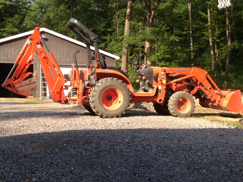

About to hit 100 hours. I may wash the soot and all to celebrate!

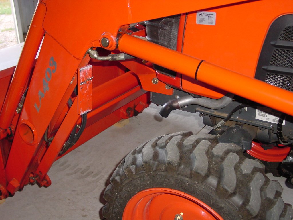

I fit a 1-1/4 inch 45 degree copper elbow onto the end of the pipe and pointed it downward, away from the loader arm and bucket. The soot problem is gone but the exhaust does kick up more dust and dirt if the conditions are dry.

Here was my solution for the soot.
