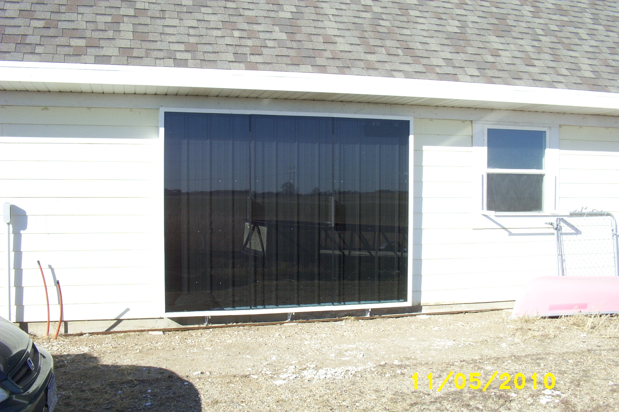

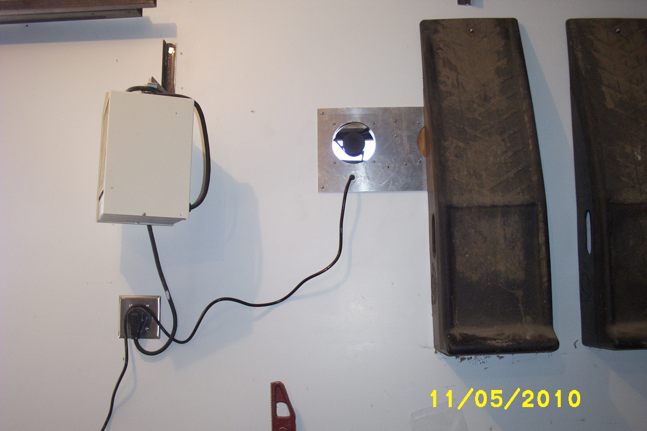

Here is my 27'x40' garage's solar heater I made. Please note the electric heater (x2) next to the solar panels discharge. It supplies 100+ degree air when the sun is shining...I said when the sun is shining. Hint...the sun doesn't shine as much as you think:
