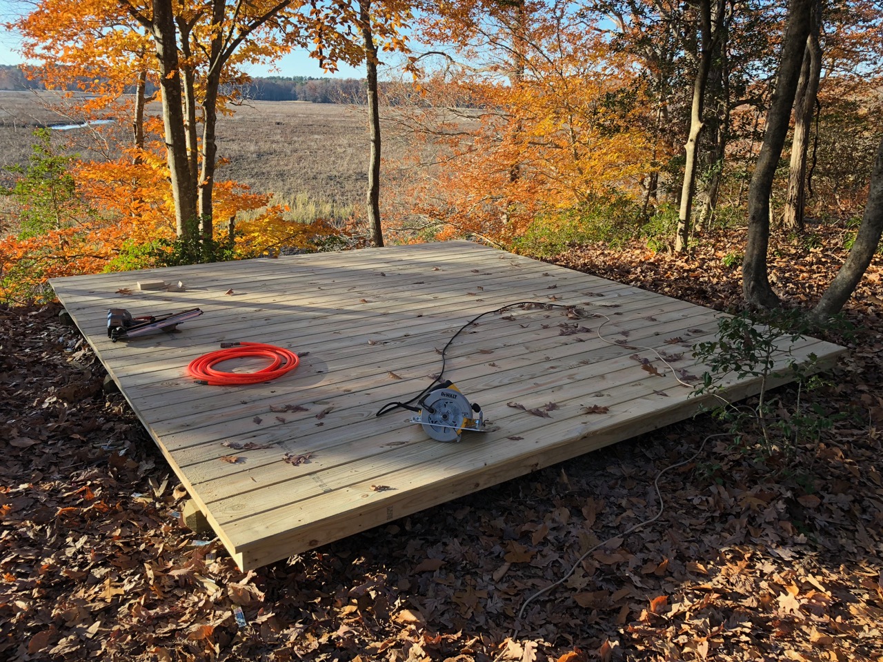

My summer project at the camp will be a small 8'x12' free standing deck.
Looking for guidance on support structure. Right now, the plan is to use concrete deck blocks setting on grade. Is there something better/easier? How many should I use? Should I stay on 16" centers, or is 24" OK? Planning to use 2x6 pressure treated frame, with 5/4 top boards.
Deck location is established compacted soil, slight slope (1-2 degrees), usage as a patio/dining area for 2-4 people.
Thoughts/ideas?

Yes. They make special concrete piers, about 12 x 12 with a recess for the 4x4 posts.
I'd run one level of 2x6s at 24 OC in one direction, then another level of 2x6s perpendicular at 16 OC similar to what's shown above. I'm not sure I'd do what they did with the 4x4s though. I usually lag through the joists into the posts.. Edge board of 2x8 or 2x10 around the perimeter. Deck boards laid perpendicular to the top 2 x 6s and over the edge of the perimeter boards. Use deck hardware, joist hangars, corners, angles, etc. as needed.

Yes, that's what I'm referring to as deck blocks. Seems like a great idea!
That style might put me up too high at the high end of the slope. I have less than a foot of height to work with there, to match up to the front porch of our cabin. I was thinking of running the braces inside the frame, vs on top like the pic. Excavation is out also, due to all the trees & roots.
I wonder how often one of those blocks is needed? I was thinking maybe every 4 sq ft? Maybe too much?

I've used those concrete blocks and I don't like them. You need a lot of them, the recommended spacing is small, and getting them all level to start with is a pain. They will sink into the ground, at different rates, and your deck will wobble. For just a simple deck I'd build it on skids, just two 6x6's lying on the ground along the long dimension. It's a lot easier to get level and square. I'd frame the deck with 2x6's on 16" centers. I probably wouldn't attach the framing to the skids so if I ever needed to move it or adjust it I could pick it up, I don't think it would move.
If the deck is more than about 7" off the ground you're going to want steps or railings and then things get complicated. You could set the skids into the ground to keep it low. Another alternative is a single step running the length of one side.

For a small deck close to the ground, you don't really need that many. I'd say 6-8 for the size mentioned, maybe 10. Using the short 4x4s, the blocks don't need to be leveled to each other. Set the blocks so the surface of each is level. Add 4x4s at the corners, use a line to determine level and mark the 4x4s with a pencil or chalk line, then set the 2x6s to those marks. Add the rest of the 4x4s and cut them off flush with the top of the 2x6s. The surface will be level even if the blocks aren't.
Can the blocks settle into soft ground over time? Sure can. But OP stated the ground is full of rocks and roots, so it may not be too likely there.
