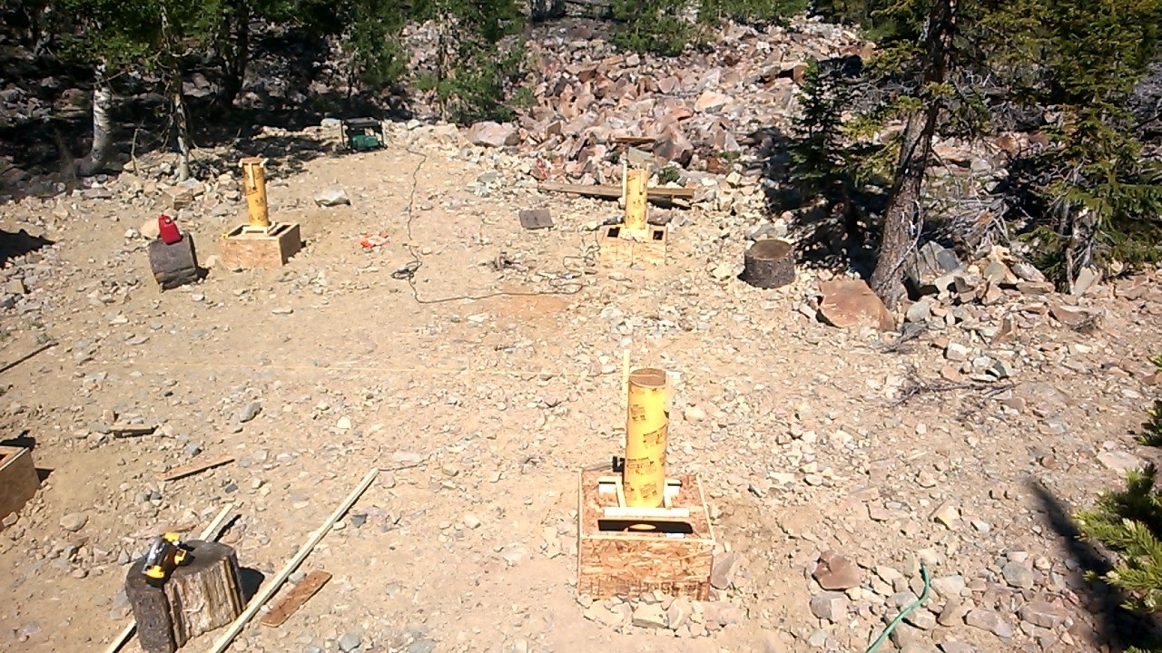

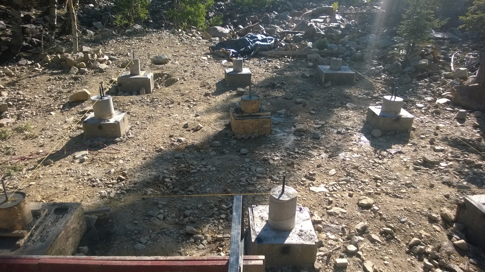

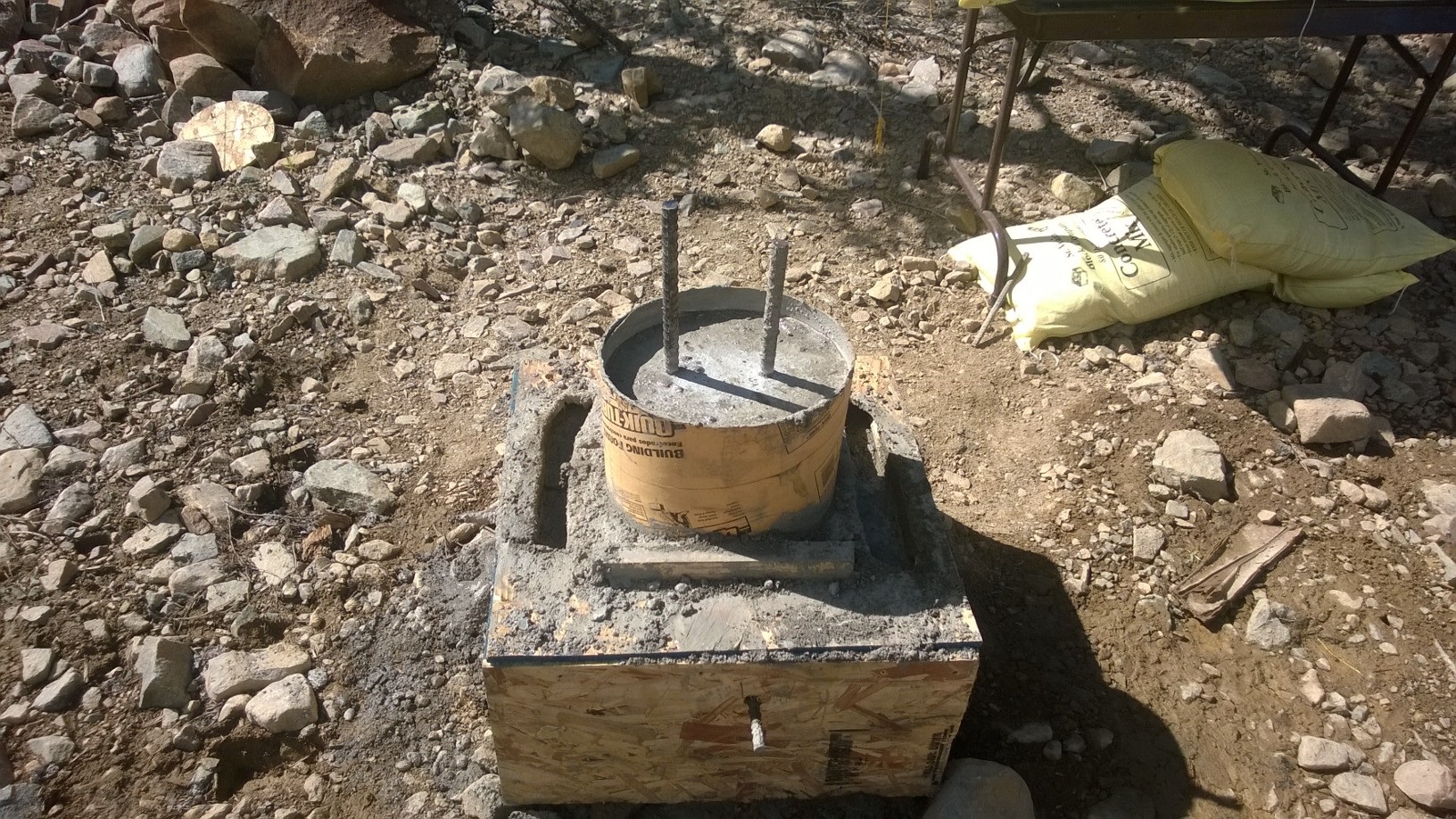

Here is how an engineered sonotube foundation is made. The snotube is not in the ground, the base foundation box is. The sonotube is held up in the box (see fist pic) with rebar and then a monolithic pour is made.
Now we put the entire cabin foundation on top of an old glacial till area, so there was no need to go down below frost level as the big open rocks had no hydraulic pressure action on the boxes. The boxes only go in the ground about 10 inches, per design. The boxes are what hold all the weight, the sonotube piers just make a level platform for framing....

   / Explain concrete sonotubes to me #38
Thanks for that one Snobdds, up until your pics, I thought that I had a lot of rocks :laughing::thumbsup:
Nice job.
   / Explain concrete sonotubes to me #39
Wow, those are some giant footers
