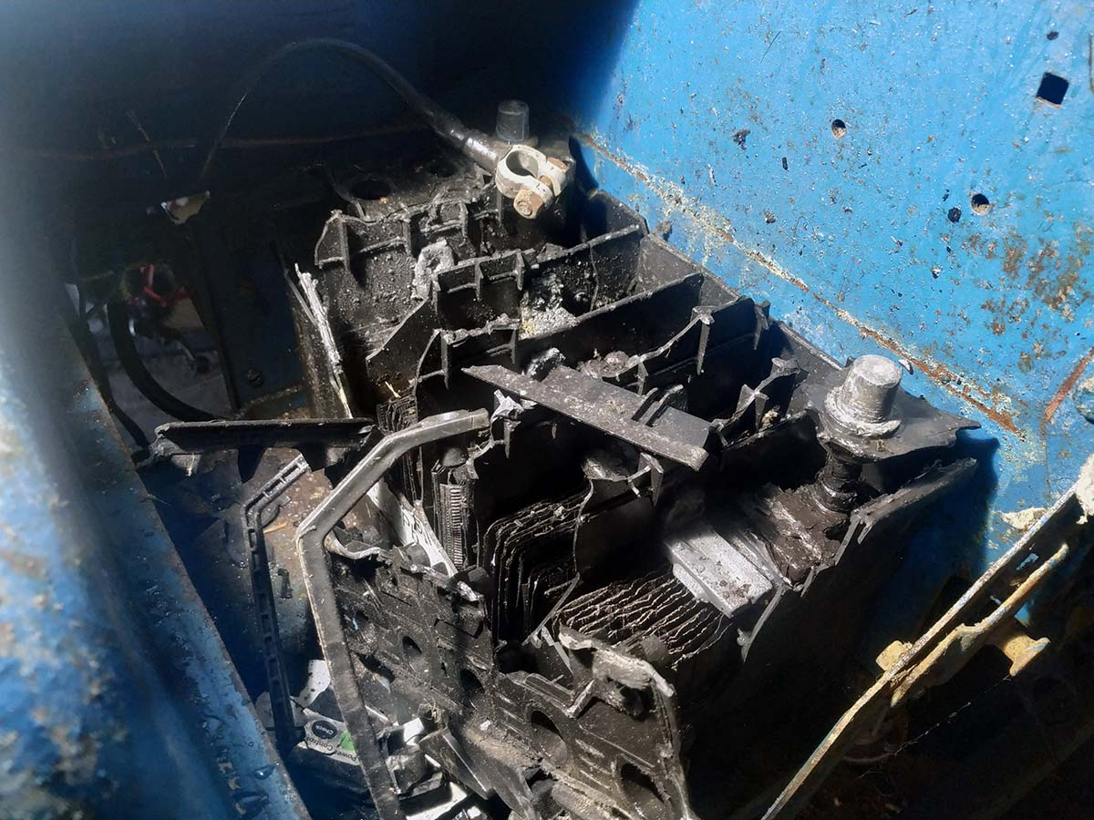

Well that was bloody scary.
I charged the (not entirely flat) battery on my Fordson Super Major overnight and came to start it this morning. Big spark, huge bang, smell of battery acid and battery fluid dripping all over the barn floor.
Everything had been done properly. Correct polarity. It just seemed to happen out of the blue.
Any idea how best to clean the battery acid off the tractor and floor? Hose pipe?
What is is likely to have been destroyed? Alternator? Anything else?
Thanks for any advice

Some type spark(internal in battery or external cable connection) set off the acid gas created while charging battery. Apply baking soda to neutralize the acid then wash affected area. Yrs back I had battery explode on IHC 300 while I set on tractor with my knees straddling battery. Now that will get a fellows attention!

I would start with the battery and go from there. Likely nothing else is damaged. Did it blow when you were disconnecting the charger or when you turned the key?
Looks like the battery is in a somewhat inclosed space. The gases off of the battery likely got trapped and the spark caused the explosion. I have a few pieces of plastic in my hand and lip from a battery that exploded. Mine was in a 53 Ford truck. The battery was located in the passenger floor board. I was jumping it off and let the cables spark.

Baking soda will neutralize the acid. I’d sprinkle baking soda on any spots you see acid, and then spray a mix of baking soda and water on it, and sop it up with kitty litter. Wear your oldest most sacrificial clothes, they might get ruined.

It exploded as I fired up the starter motor. I had charged it overnight with the bonnet open but very luckily had closed it when I fired up the tractor, otherwise I'd have battery acid and plastic embedded in my face.
I'll go get some baking soda. I'll need a lot. There's acid all over the place.

As others have said, baking soda / water mix. Try 1/2 to 1 cup per gallon well mixed. Hose the whole area off once you note that the reaction has stopped.
As far as cause, that explosion began internal to the battery. Likely due to a low electrolyte level while charging, then an internal Arc while starting. The plates should ALWAYS be covered in electrolyte.
