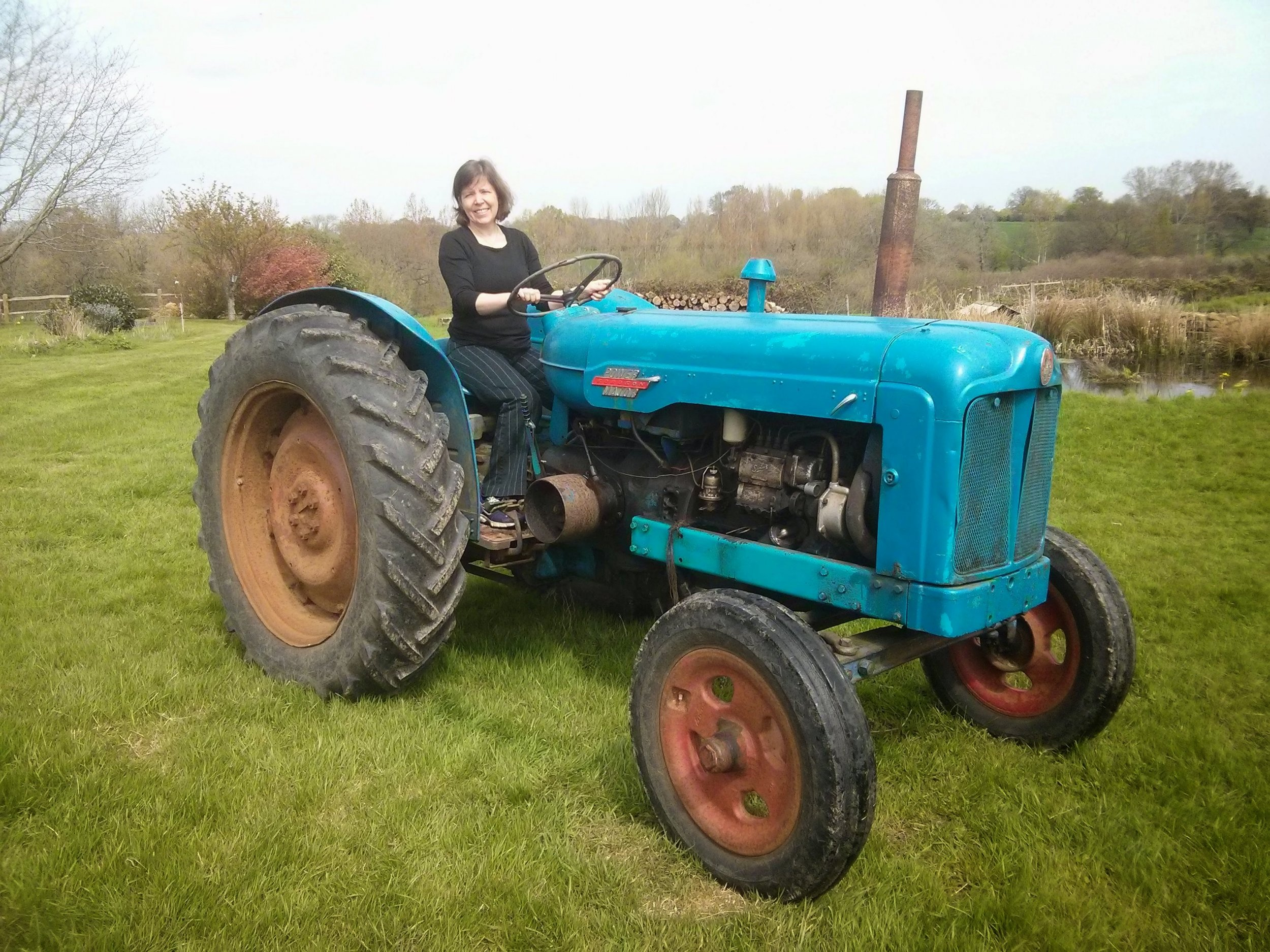

Mine's a 1959 model. It's 20 days younger than I am. Despite only being used 2 or 3 times a year it always starts first go. I've had it nearly a decade and this is the first time I've had any real issue. I've no idea what a vacuum governor is, or even if it has one. Anyway, here's a photo of it with my sister-in-law in the driving seat.
No, yours don't have it, an upgrade for me is to have your type. Batteries explode at times. I have had it happen a few times. Not on the tractor. It shouldn't hurt anything but the battery. Wash the acid off of everything.
