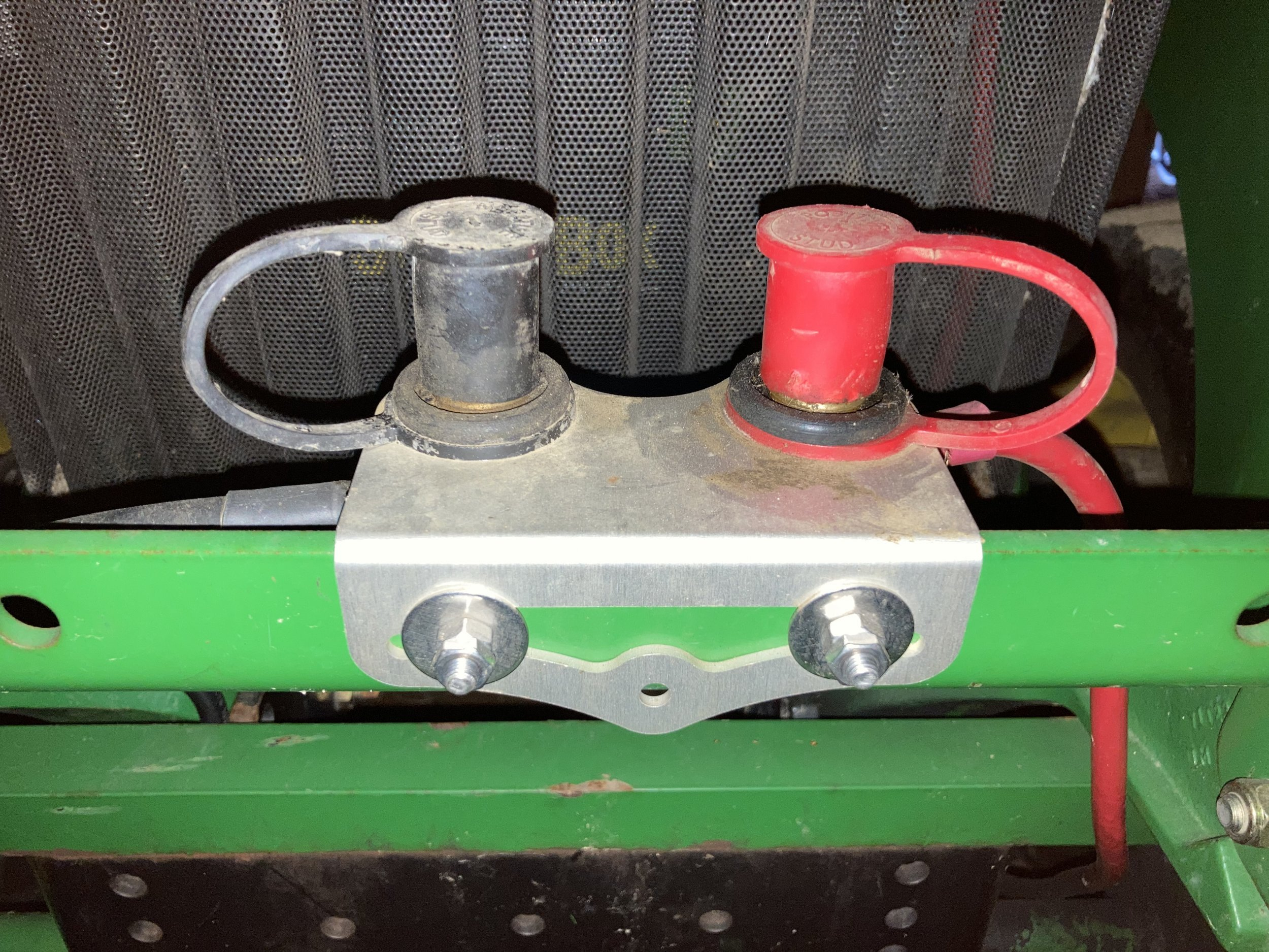

I had a 56 IH Utility 330 and never gave a thought to the position of the battery until my friend had a battery explode on his JD M. My present tractor (2007 JD 3320) has a FEL and I would find that in the rare occasions when my tractor needed a boost on a VERY cold morning(didn't give the block heater enough time..or battery was nearing the end of its useful life) getting to the battery was quite the pain..I installed a set of external terminals on the front guard..has made my life alot easier
