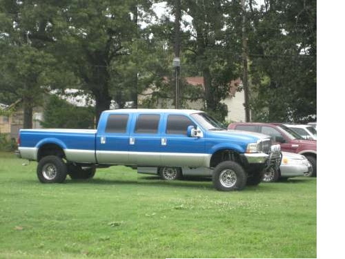

The final outcome should be like the truck pictured below...

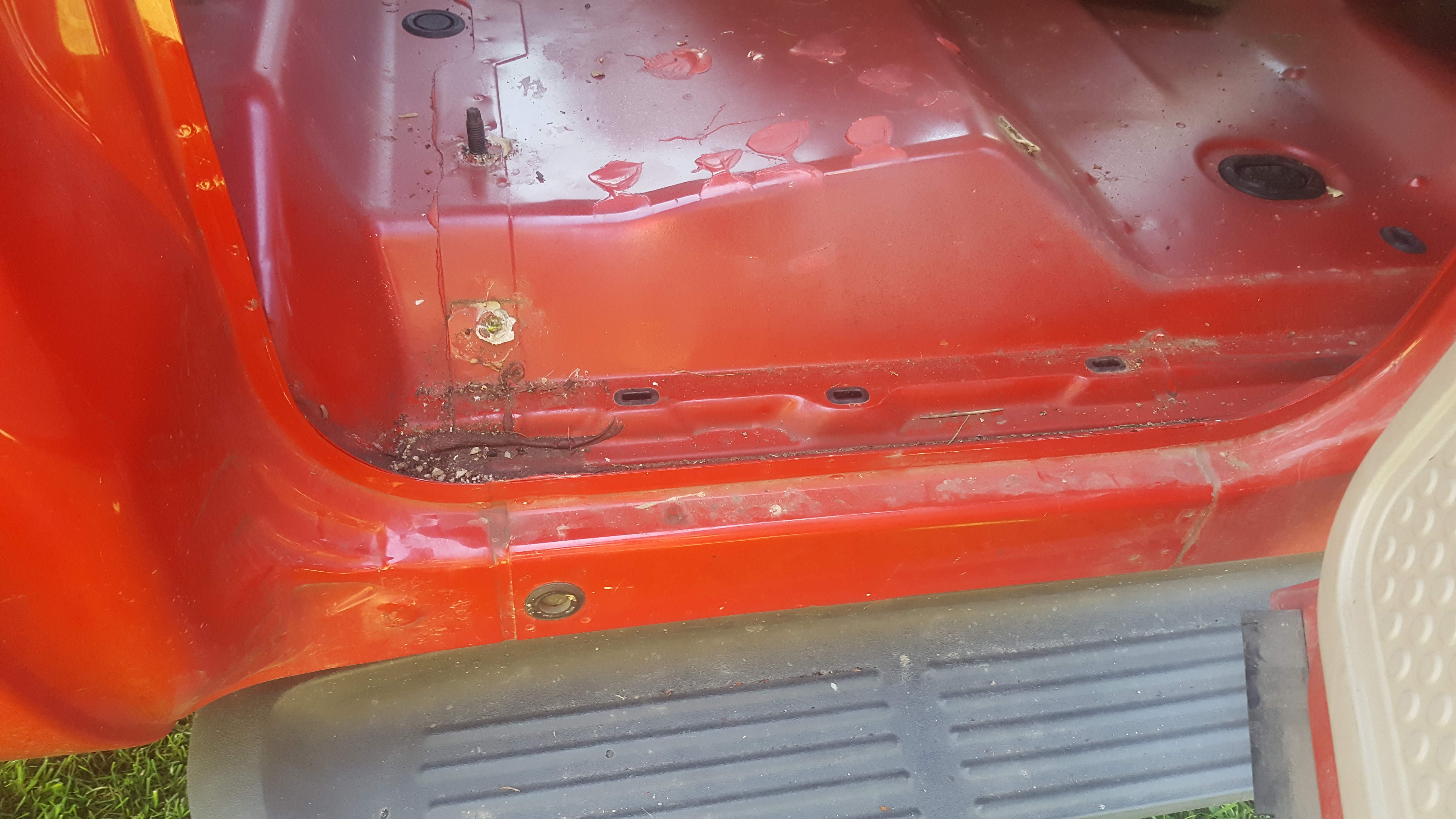

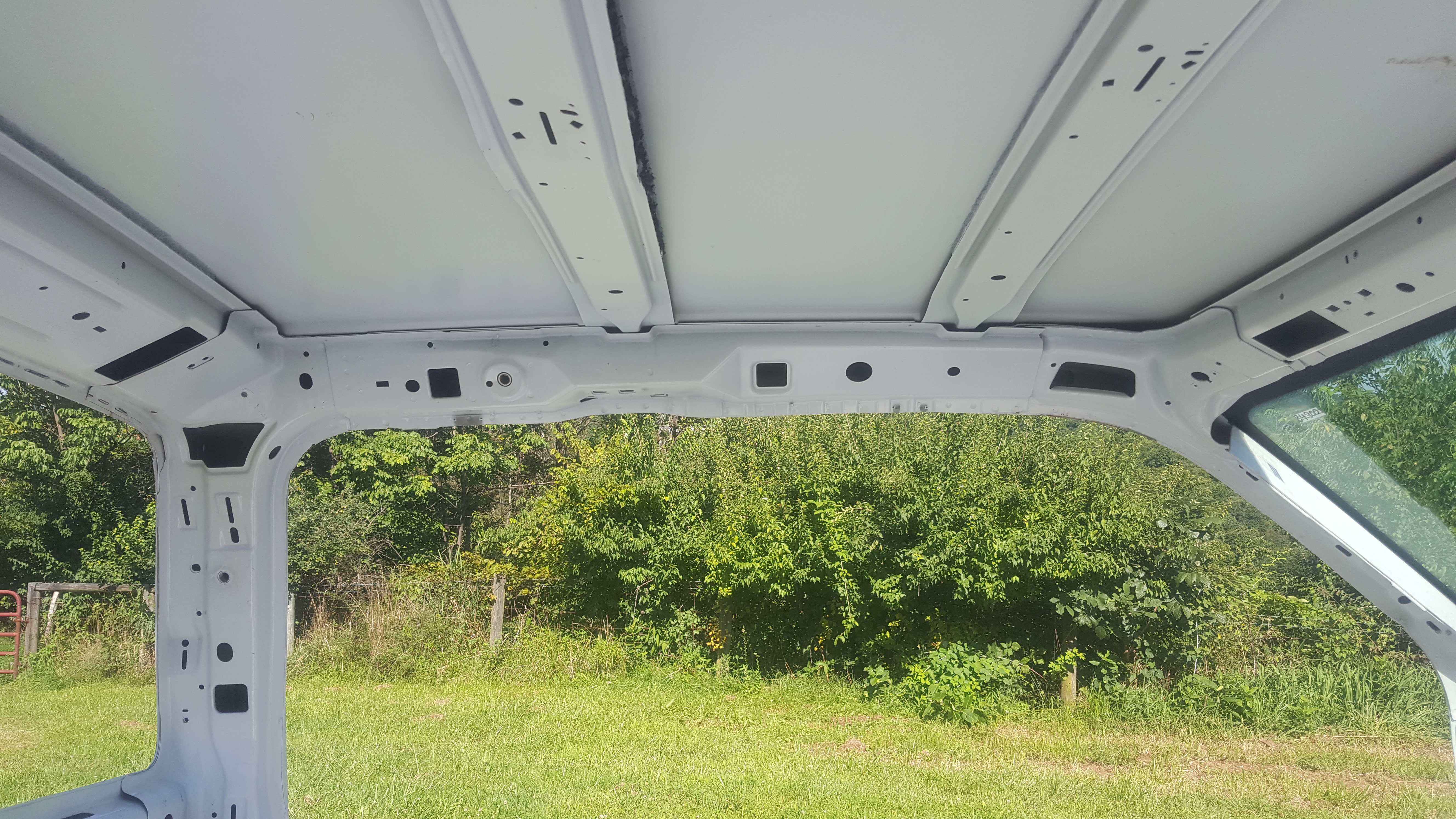

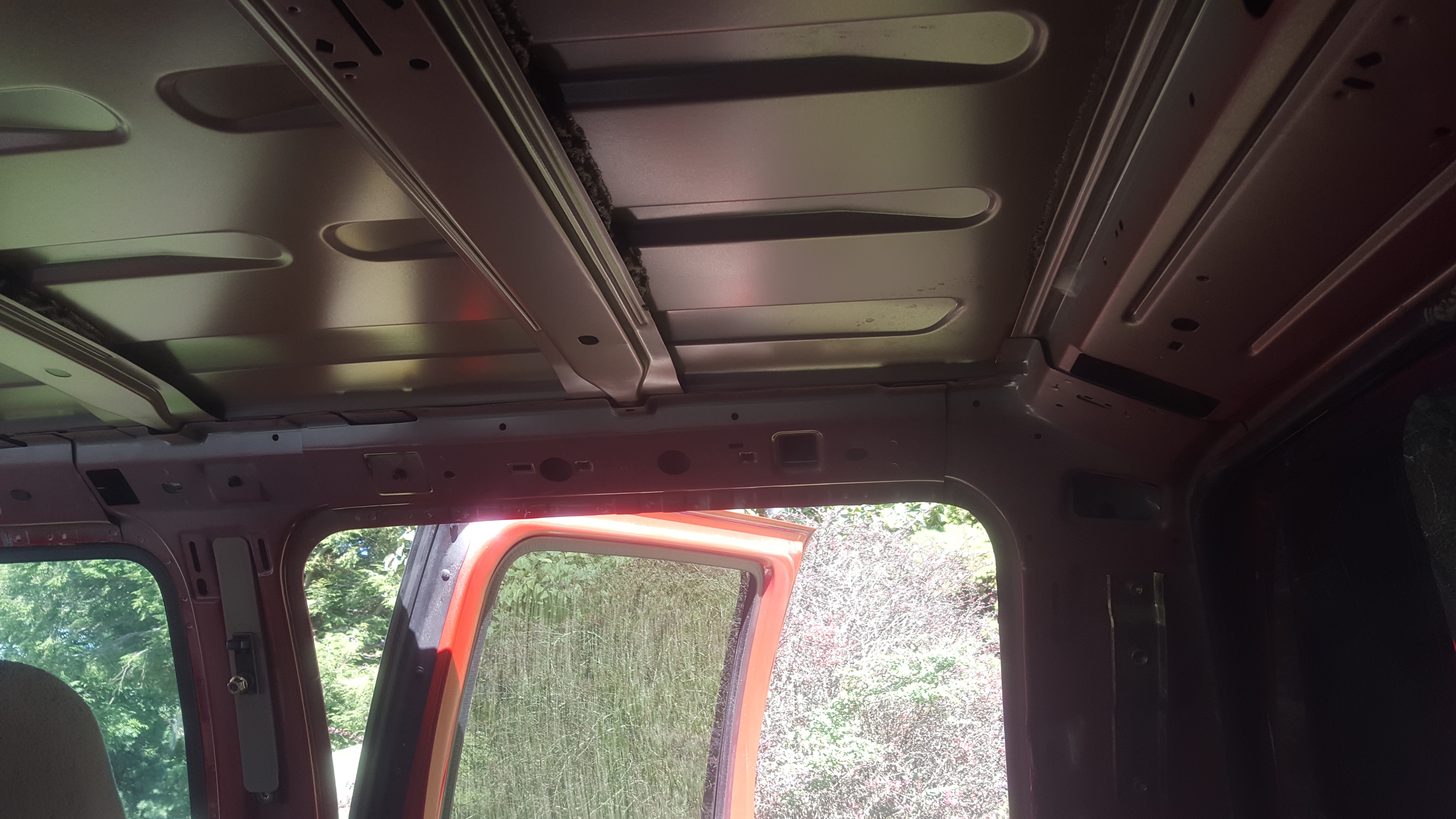

Here's some pictures from today... and my focus on where to splice the floors and roofs.

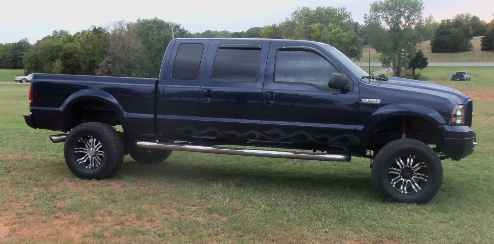

   / Extended Crew Cab- The SuperDuperDuty family hauler
Bruce, yes kinda like that only not that long... I just edit added a picture to post 1.
