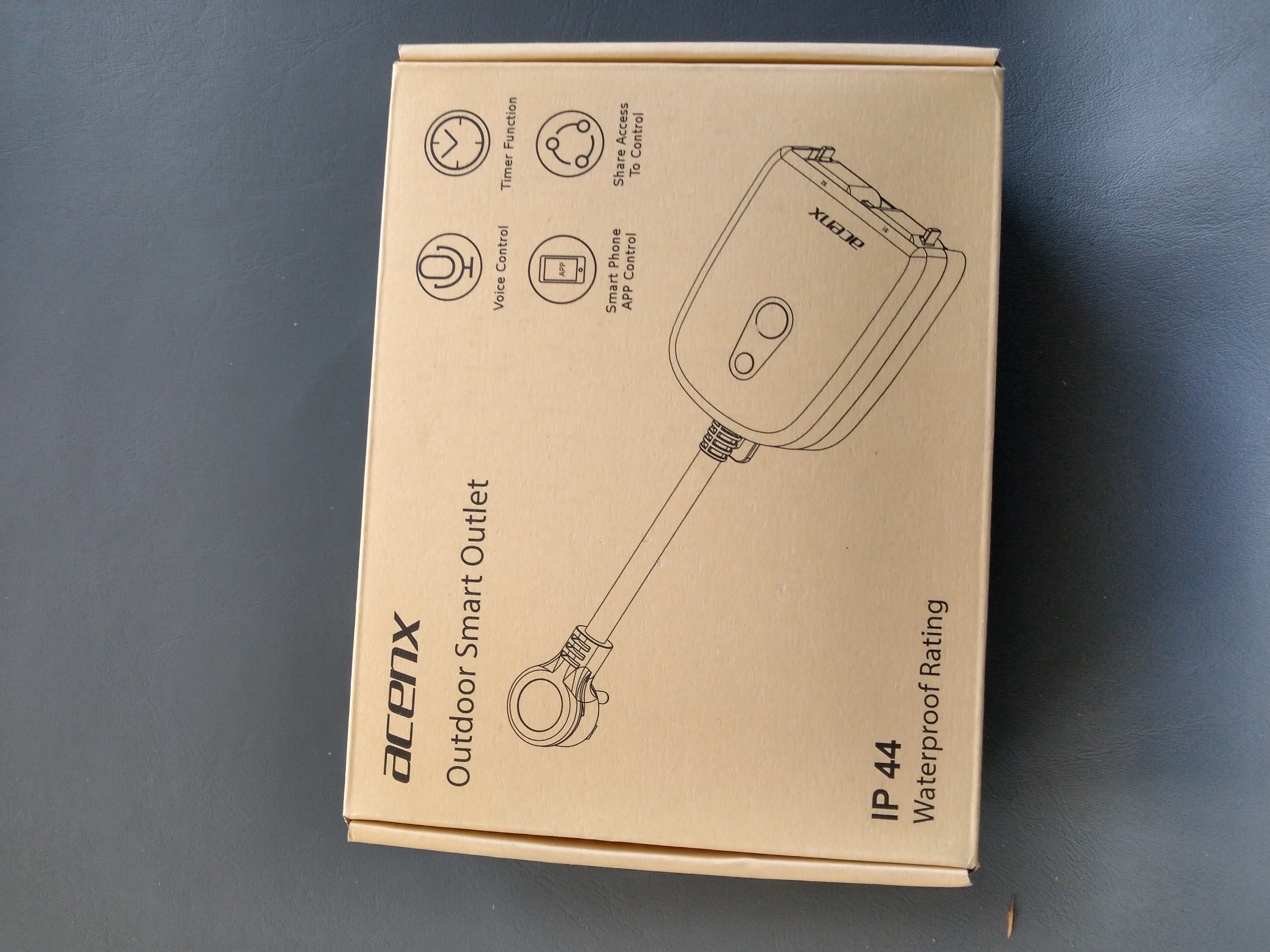

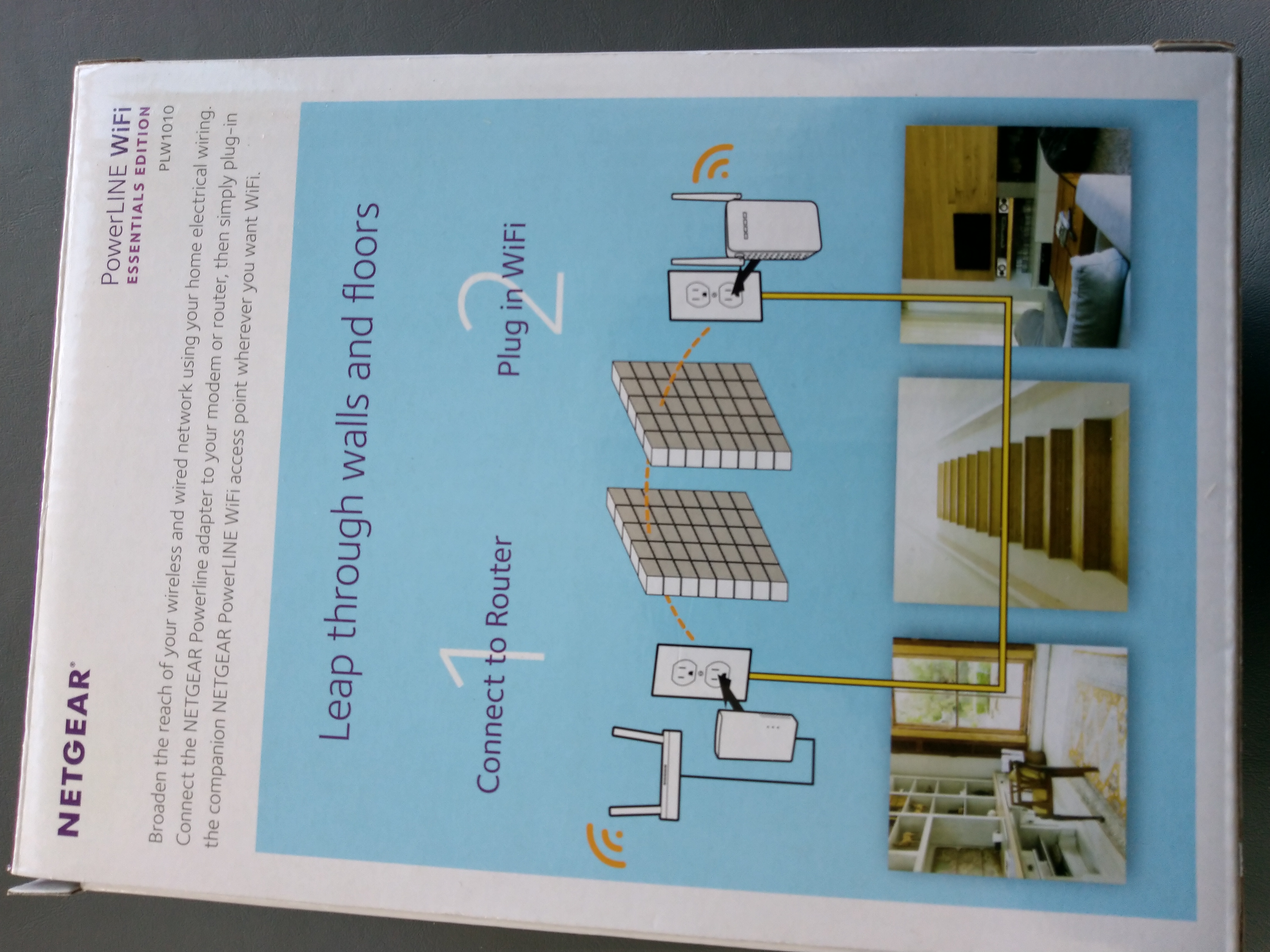

My barn is about 50 yards away from my Router in the house and couldn't access the internet.
1. I added the NetGear PowerLine access adapters.
Hooked one adapter to an outlet close to my router in the house.
Added the other adapter to an outlet in the Barn. Magic - I have internet in the Barn.
2. Plugged in the ACENX Outdoor Smart Plug in an outlet next to my Tractor.
3. Downloaded the "SMART LIFE" app from "Google play" to my Phone.
4. Followed the ACENX Smart Plug Outlet instructions how to "Pair" to my Phone.
5. From my phone I set the "Smart Life" App and program to shut power off to the outlet - after two hours.
Equipment purchased:
1. NETGEAR PowerLINE 1000 Mbps WiFi, 802.11ac, 1 Gigabit Port - Essentials Edition (PLW1010-100NAS)
Amazon.com: NETGEAR PowerLINE 1 Mbps WiFi, 82.11ac, 1 Gigabit Port - Essentials Edition (PLW1:)-1NAS): Computers & Accessories
2. Acenx Outdoor Smart Plug Outlet Waterproof,Smartlife WiFi Outlets Timer
Acenx Outdoor Smart Plug Outlet Waterproof, Smartlife WiFi Outlets Timer Works with Alexa Google Home, Smart Christmas Light Timer for Light Strip Projectors, Schedule&Timer by App, 2.4Ghz WiFi Only: Amazon.com: Industrial & Scientific
Total Cost = $114.00
Enjoy!

Nice setup Puddlewalker.
I have the same situation as you with the shop a bit too far from home.
I just used a couple TP Link Powerline adapters and a smart switch for enabling/disabling an homemade alarm system. This also allowed me to have CCTV there.
These powerline setups are awesome and saved me lots of trouble by not having to run an ethernet cable from my house to the shop.
