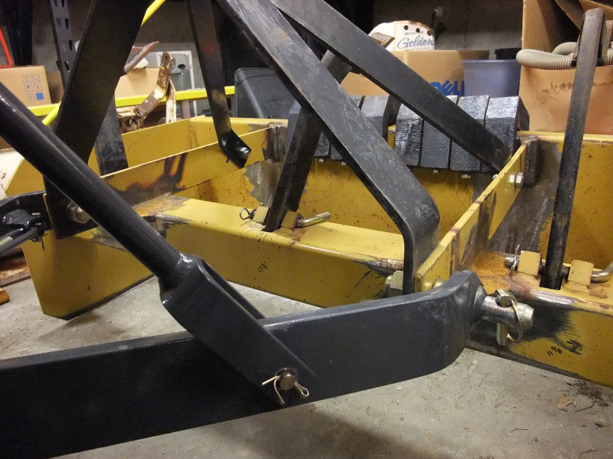

With my BX sitting on concrete the lift arms are about 10.5" off the ground to the center of the lift eyes in the fully lowered position.
Box Blade is an old Woods BB5 and I have thought above moving the mounting pins on it. This would require some welding of new mounting plates.
Will see if I can get the Box Blade attached before dark tonight and take some pictures. If not tonight tomorrow night for sure. Right now tractor is on blocks and working on a belly plate/ fan cover.
Does anyone know if the upper arms are keyed or splined to the lift shaft. My thoughta are could these possibly be one spline off. Long shot but thought was worth asking the question.
My experience has been with ag tractors is the linkage has never been to short. 100 HP Cat 2 the arms are lower than on this Cat 1.
Check your manual to see if it states what this height should be. My tractor lists it at 6.5" with GP/R4 tires. Even with the taller ag tires, it lists 7.1" Upper limit is supposed to be 32"
My CT225 and the BX should be roughly similar in dimensions. Both have about 9" of ground clearance, although the CT is longer and wider. I would expect that to make my TPH higher, rather than lower.

The parts manual shows they are splined and held to the rock shaft with snap rings.
A dumb question????? I don't have my tractor here but is it possible you have the lift arms on backwards that would move the side link to a different position and geometry???

I no longer have the 1850 but am certain the arms went much lower than yours. Open the speed valve and step on the links to see if they will go down any more. The new BX1860 raises higher but also will not drop as low as the 1850.
Most of the bx issues were not lifting high enough.
   / extending 3 PH lift arms on BX #10
Make sure they are really down all the way. Mine won't lower by themselves if they have no weight/implement on them; sometimes I need to step down on them with the lever in the lower position. Seems too simple but thought I'd mention it.
