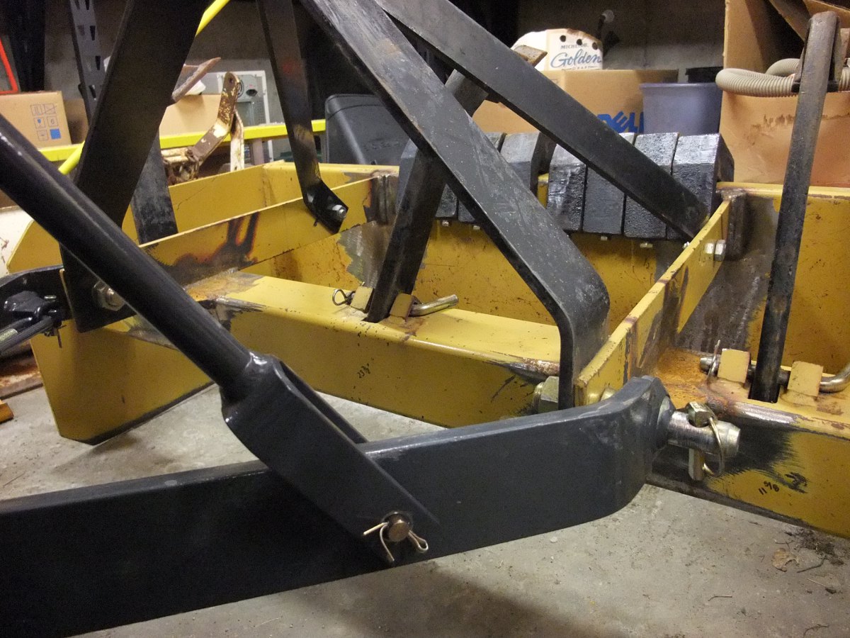

My BX24 goes down to about 9 1/2 inches. If I remember correctly, the standard requirement for Cat 1 Hitch is 10 inches.
   / extending 3 PH lift arms on BX #12
My 3-point eyes were about 10" off the ground fully lowered, and the box blade was 4" off the ground at that point:
http://www.tractorbynet.com/forums/kubota-owning-operating/159256-bx2660-3-point-height.html
I ended up taking the box blade to a welder and had them cut off the draw bars, flip them over, and weld them to the top side of the 4x4 main beam that holds the scarifiers. Ended up costing me about $60. (Of course, now I need to re-paint it.)
Picture of the original box blade in the thread above. Picture of the modified box blade attached.

Guys thanks for all your replies.
I am going to look at moving the pins on the BB since this will only effect the BB and not any other future equipment I might purchase.

Here is what I did to my blade and tractor
my blade is the KK BX series maybe that is the difference?
