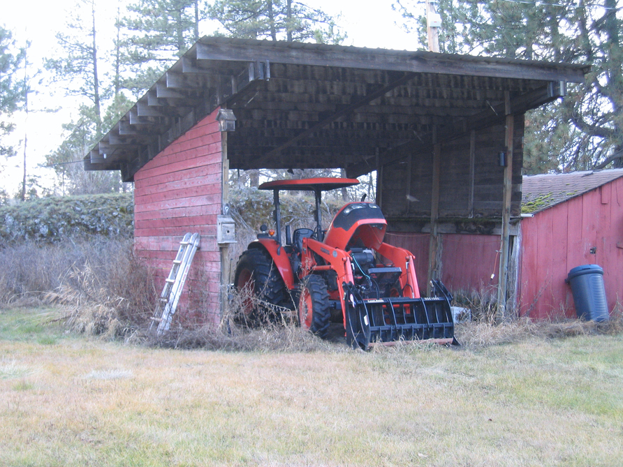

Not much help to the OP here but I did this on my old Kubota B7100 HST. It came stock with a horizontal muffler and short outlet tube. I removed the 4 bolt muffler flange from the exhaust manifold and rotated it 90 degrees so it was pointing upward. I bolted a 3' piece of galvanized 1 1/4" pipe to the outlet and problem solved. I just had to be careful near the tree line to avoid breaking it off on a limb.
Changing the exhaust direction shouldn't be a problem on most tractors as long as the method isn't restrictive. If you go vertical, make sure you keep the rain out of the pipe when not in use.
