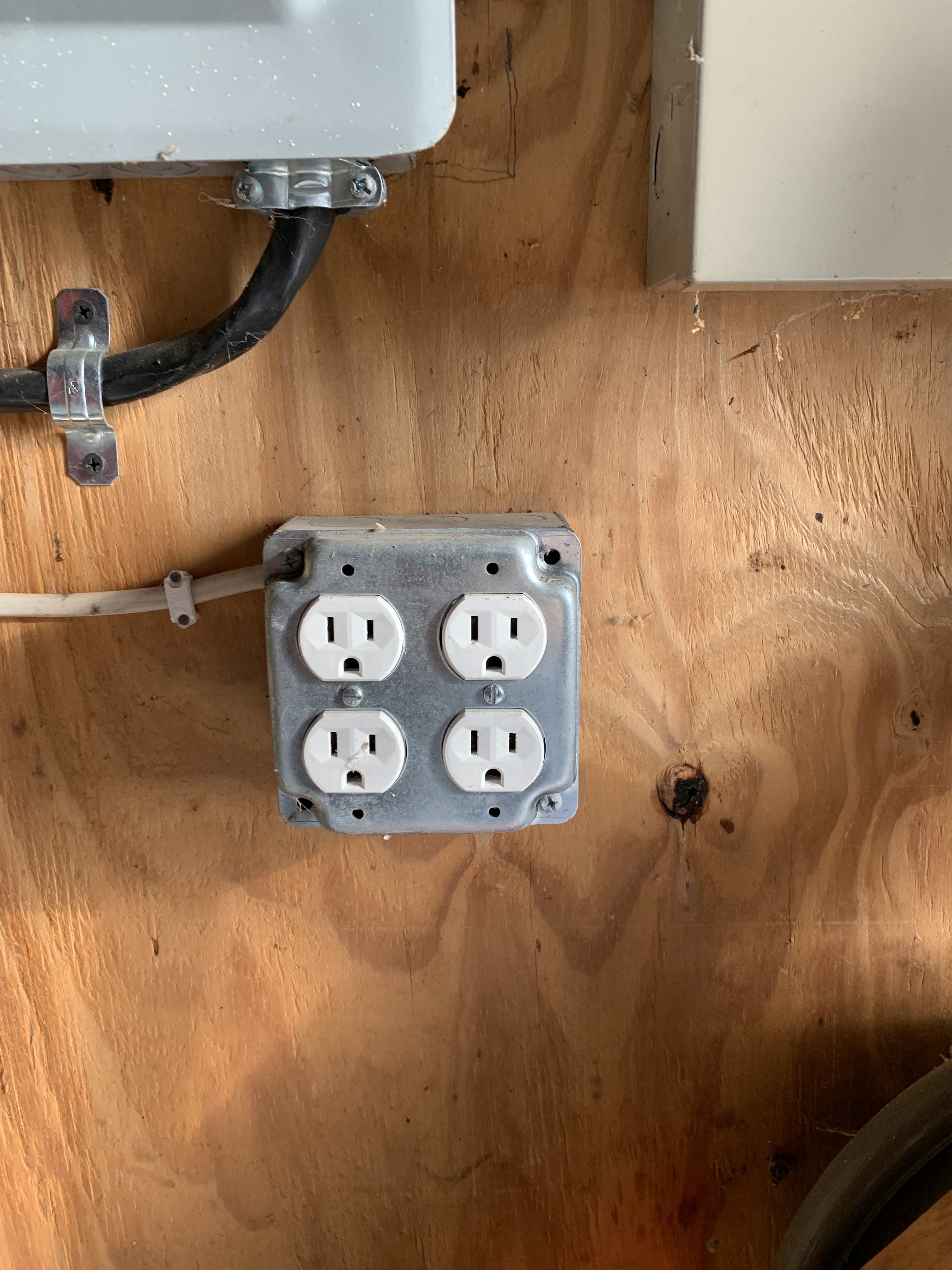

There was no girt behind the location where I wanted to place the exterior outlet, so I screwed a piece of plywood between the girts above and below. I fastened a 4" box to the plywood at the place I wanted the outside outlet. I drilled a 1" hole through the plywood and sheet metal siding and used a 6" pipe nipple to connect the inside and outside weatherproof box.
I've since used the plywood to mount other equipment, and added a double duplex outlet for convenience.

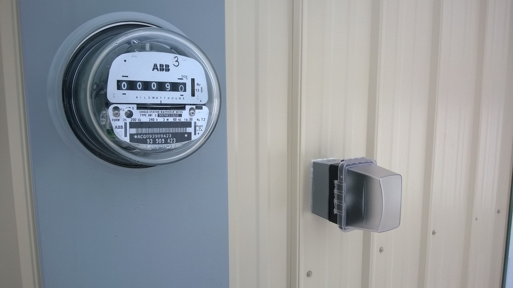

This mine from 10 years ago. I think I used it once. Inspector approved it.
   / Exterior outlet on pole barn/corrugated metal
#24
Thanks. Looks about how mine ended up, aside from the bubble cover (I hate those things!)
