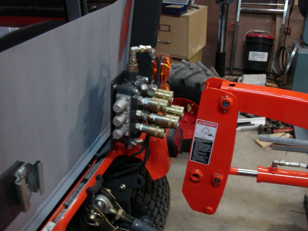

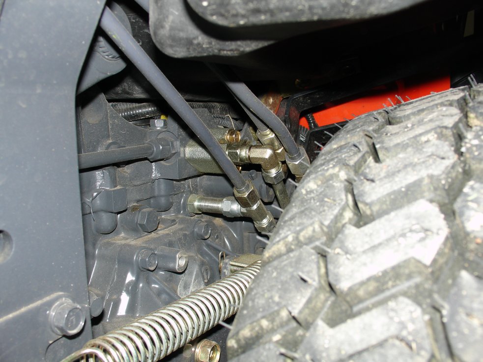

There is my set-up!
$310 CAD, that includes every things, valve, fittings.

/ Extra Hydraulics for BX2350??? #5
skippy957 said:
There is my set-up!
Looks nice but could you expand a little on this?
Did you build this out of parts or is it a kit or Kobota factory?
Where are the control levers?

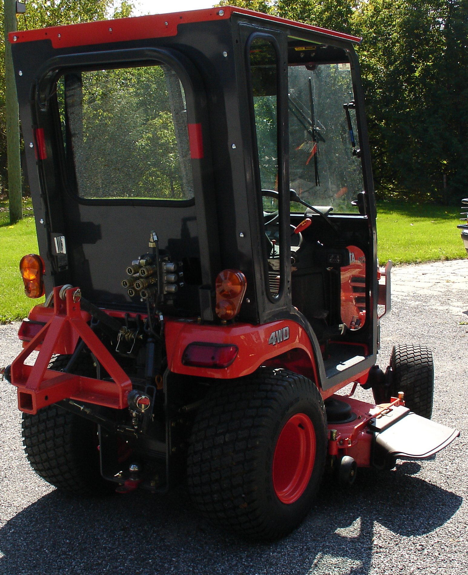

/ Extra Hydraulics for BX2350??? #6
This is home made. I got a valoil valve from my hydraulic dealer near by and plumb the hydraulic tubes my self. The controls are oriented inside beside the seat.
It is cheep and works great. Here in Canada my Kubots dealer was too expensive around $500 for a kit.
You must use a power-by-on set-up in line with the FEL.

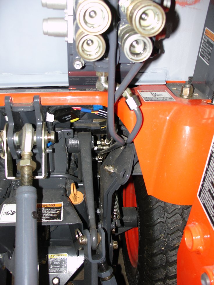

/ Extra Hydraulics for BX2350??? #12
I went with the BX7326 Dual Double-Acting Rear Remote Valve Kit for $420, dealer installed, when I bought by BX2350. I'm not sure what the kit retails at; it should be less than $300 plus installation. According to the installation instructions that were included in the paperwork I received, installation is relatively basic.
In my opinion, this is a clean, compact kit with great value.

1. 2 (two) remotes
2. Right hand side, in the open slot. Both levers are in the same slot, side by side. Bends in the levers separate them enough at the knob end to allow operation.
