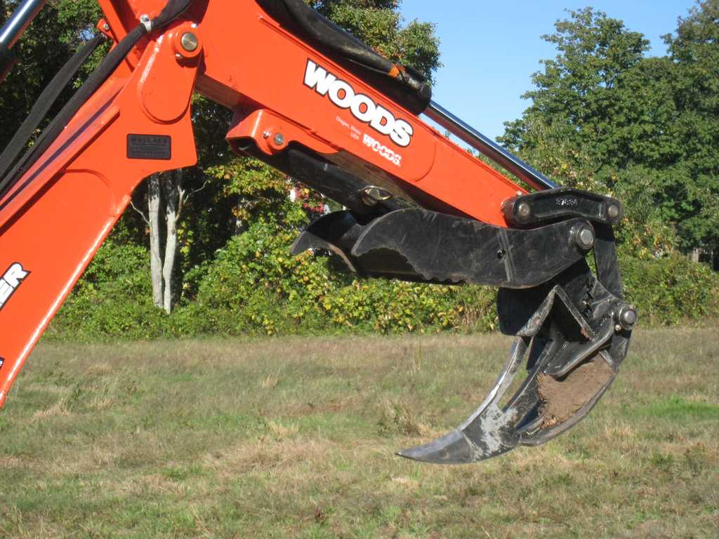

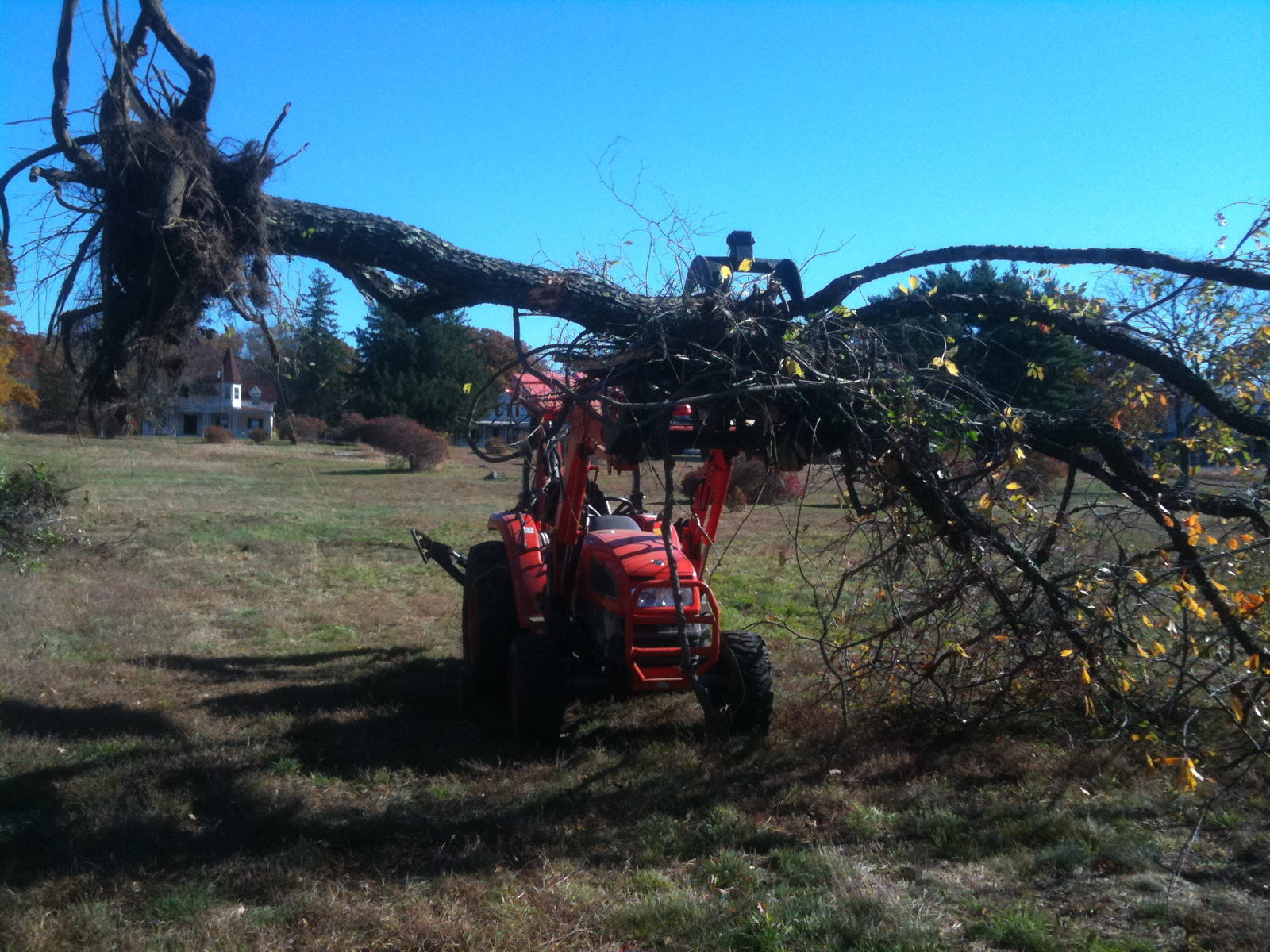

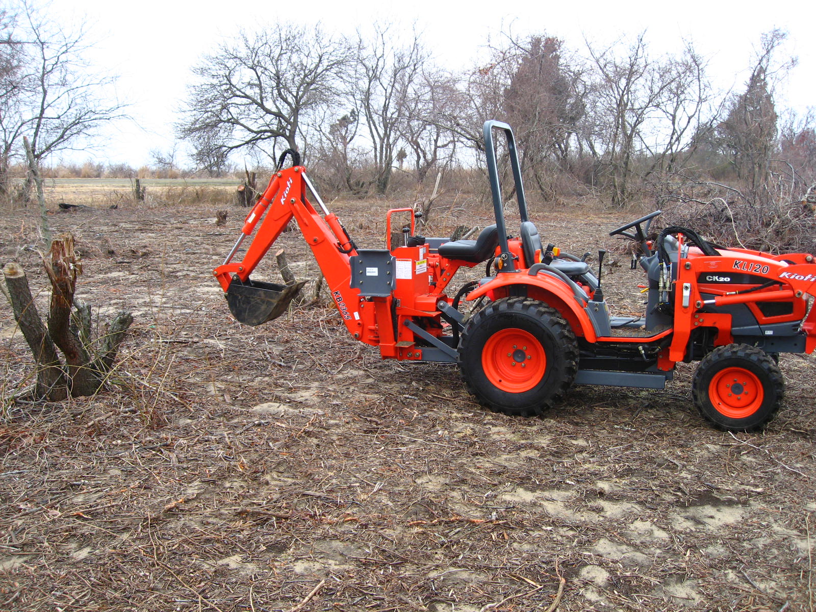

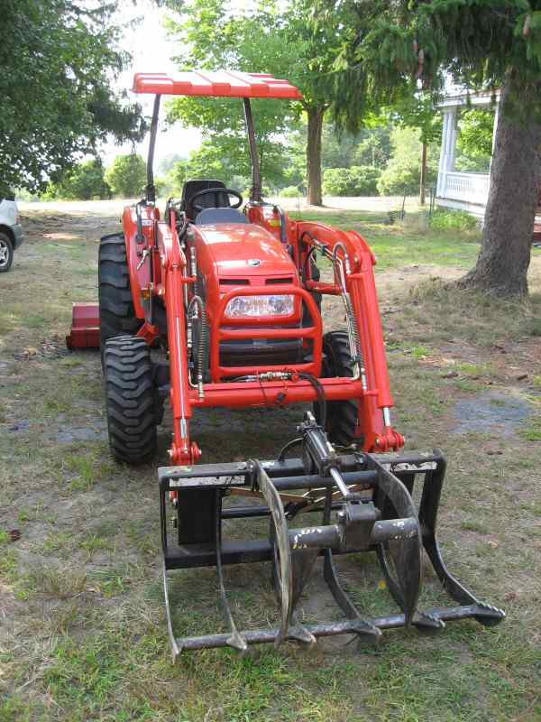

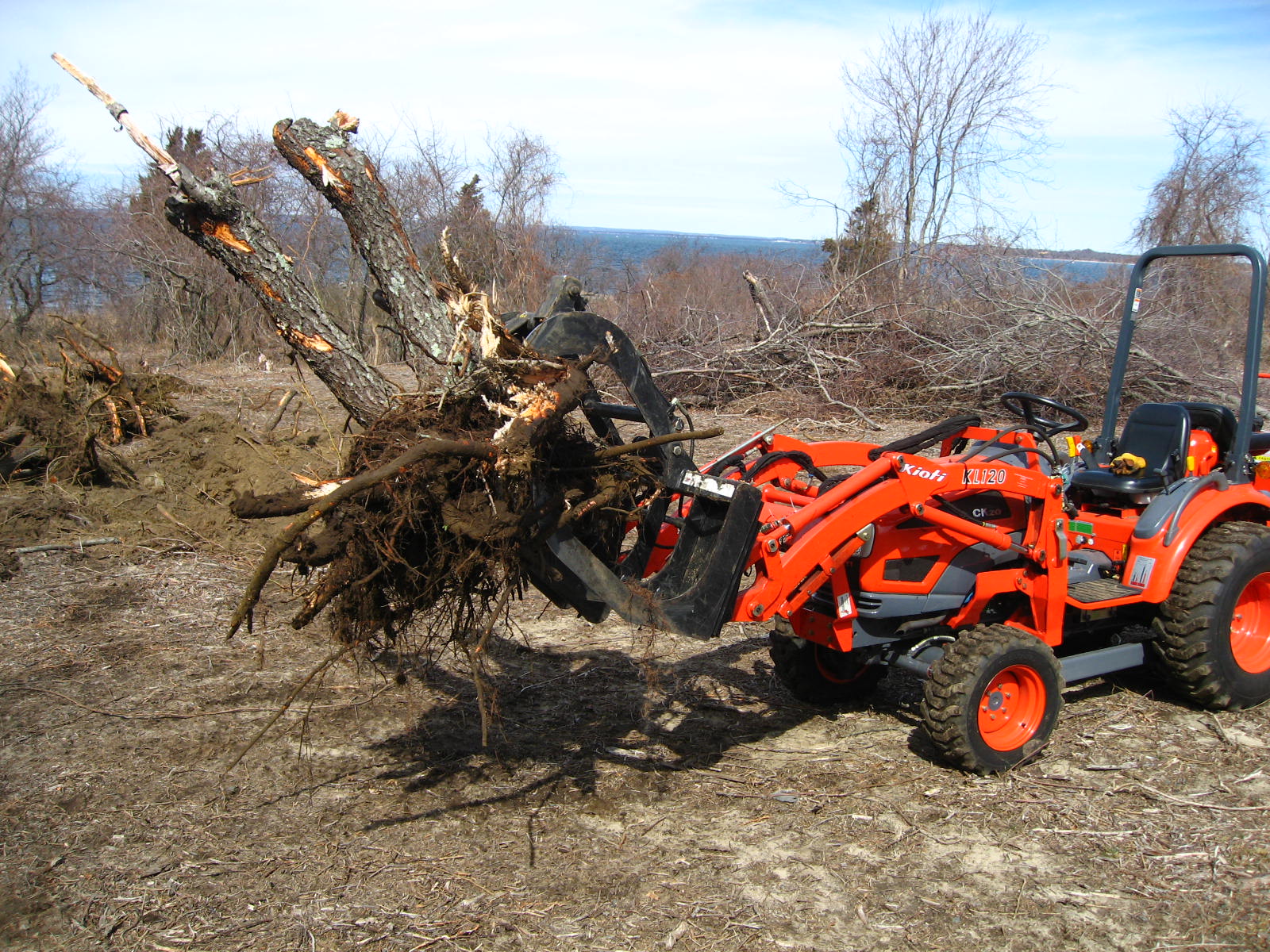

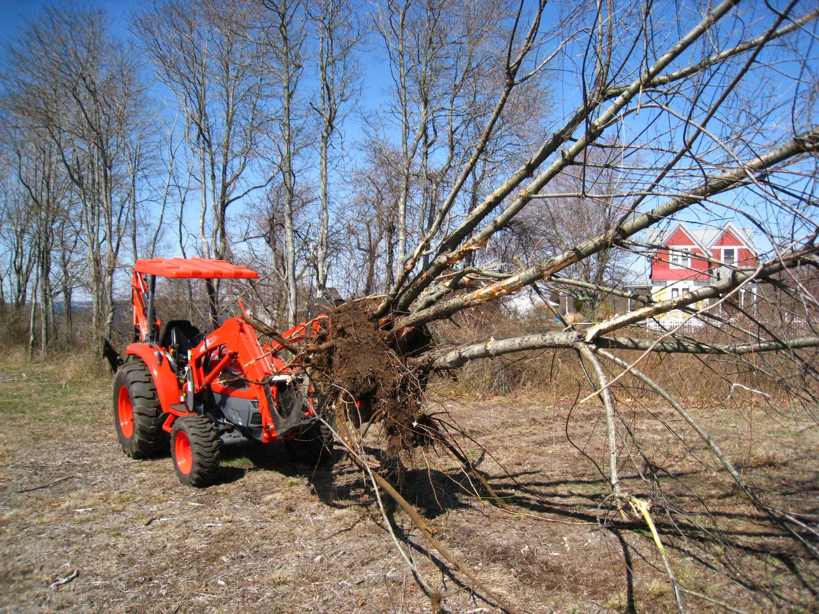

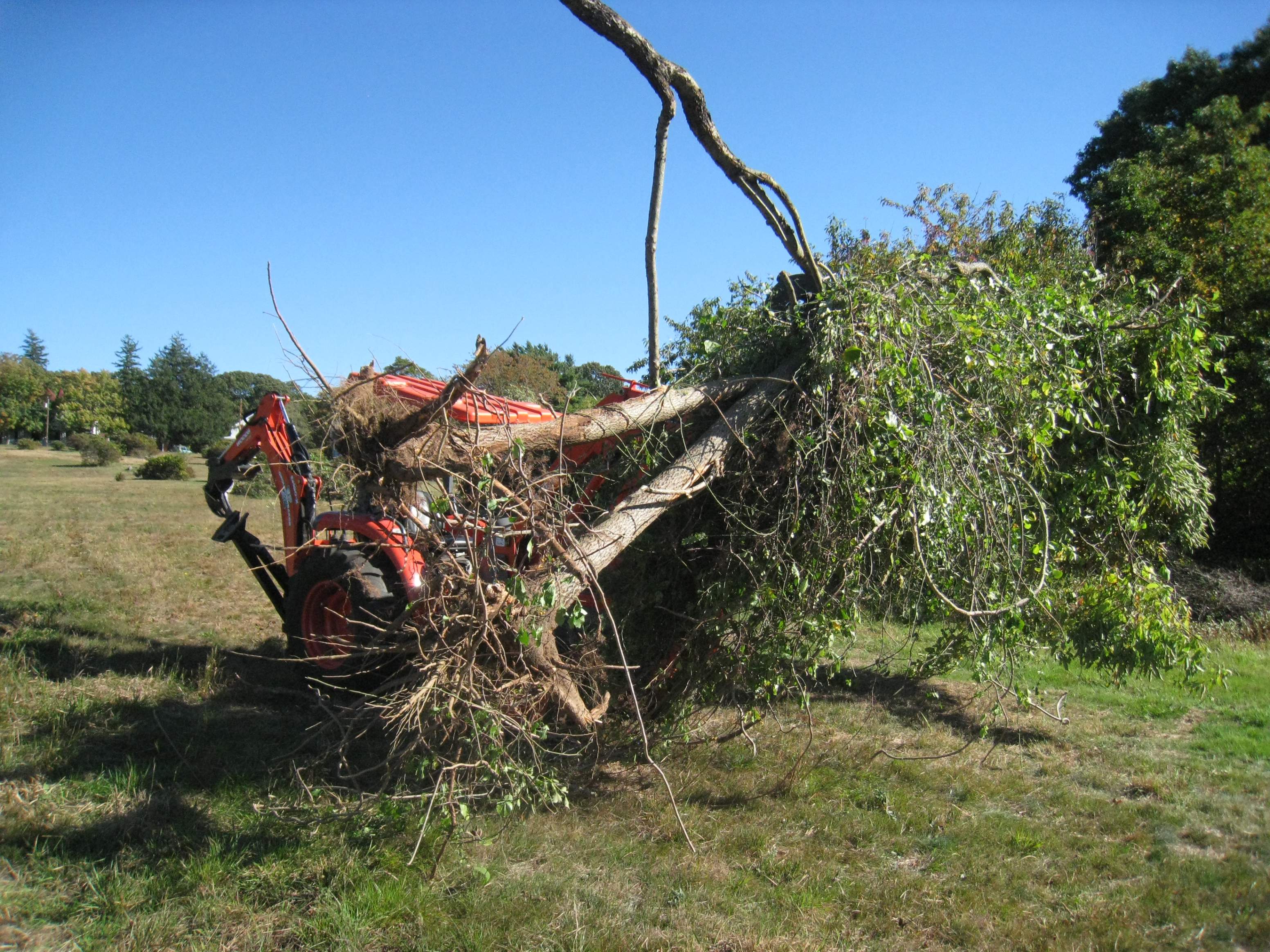

I've cleaned up very similar land here in coastal New England using a couple of different approaches with both a smaller (Kioti CK) and larger (Kioti DK) tractor. It can be done either way successfully. If time is important get the biggest heaviest tractor with a strong loader and grapple. If time is not critical but money is, then use the smaller tractor in conjunction with chain saw, grapple bucket and then go back with a rented mini excavator to dig out stumps.
I'm not sure that an L3301 is heavy enough to push over 6" trees. My Kioti DK is considerably heavier and using a grapple to dig up roots before pushing, I can get those sort of trees out without needing to cut them down. MUCH cleaner and less work in the long run than coming back to dig out a stump. To be clear, my standard approach involves a backhoe with ripper attachment to more efficiently tear out the side roots before pushing the tree over but if I don't have the backhoe mounted I can still get the job done with the loader. Again though, the Kioti DK loader is substantially stronger than the Kubota L series loaders so YMMV.
If clearing the trees and similar non mowing work is you main goal, you might consider Mahindra or Kioti in addition to Kubota. Generally, Kubotas are lighter and optimized for mowing. The other two are heavier and that can be an advantage doing land clearing. You get more loader for the buck too which is particularly useful in ripping up roots with a grapple.
