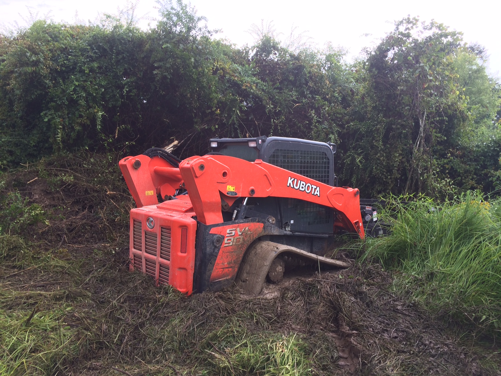

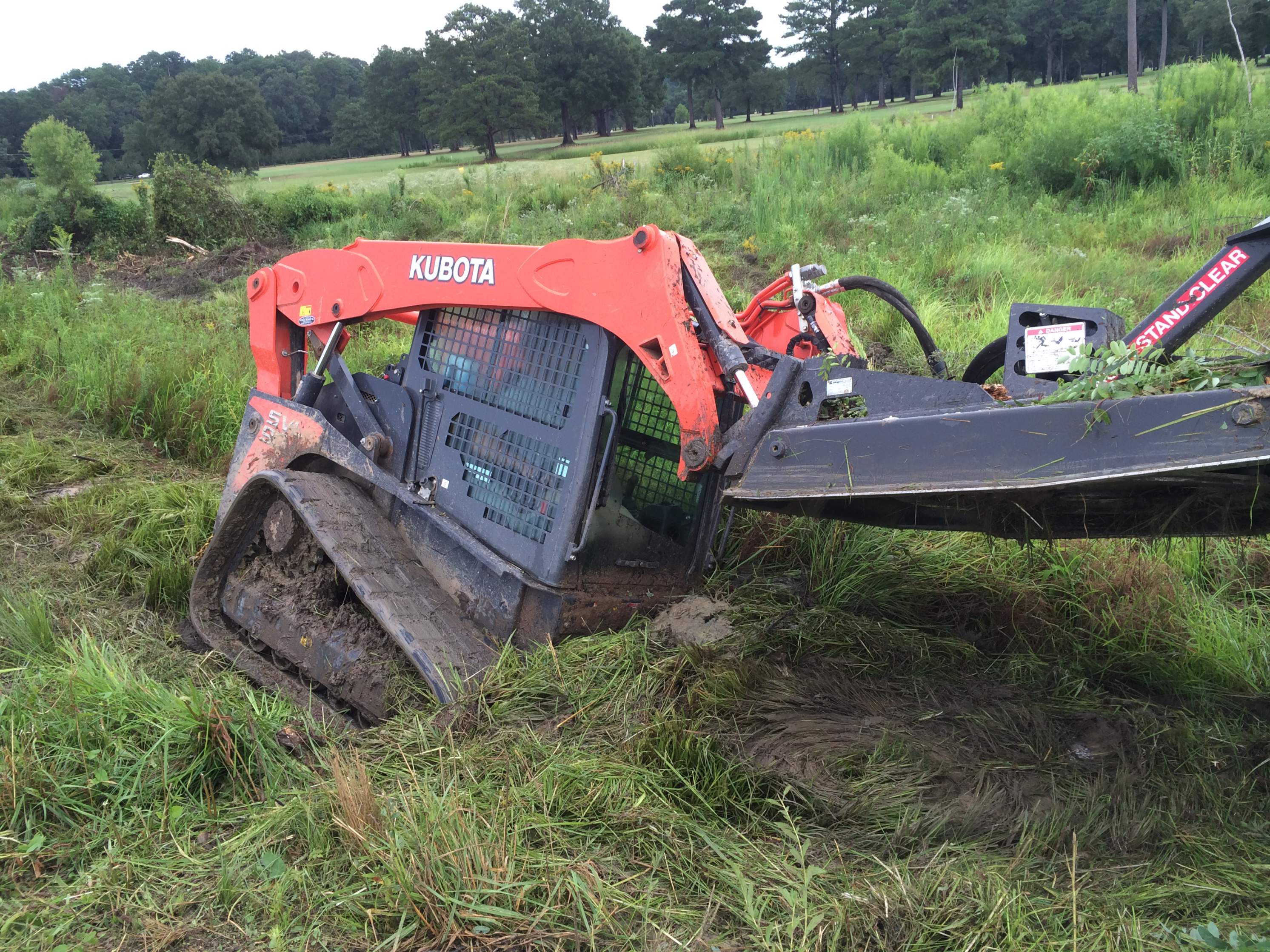

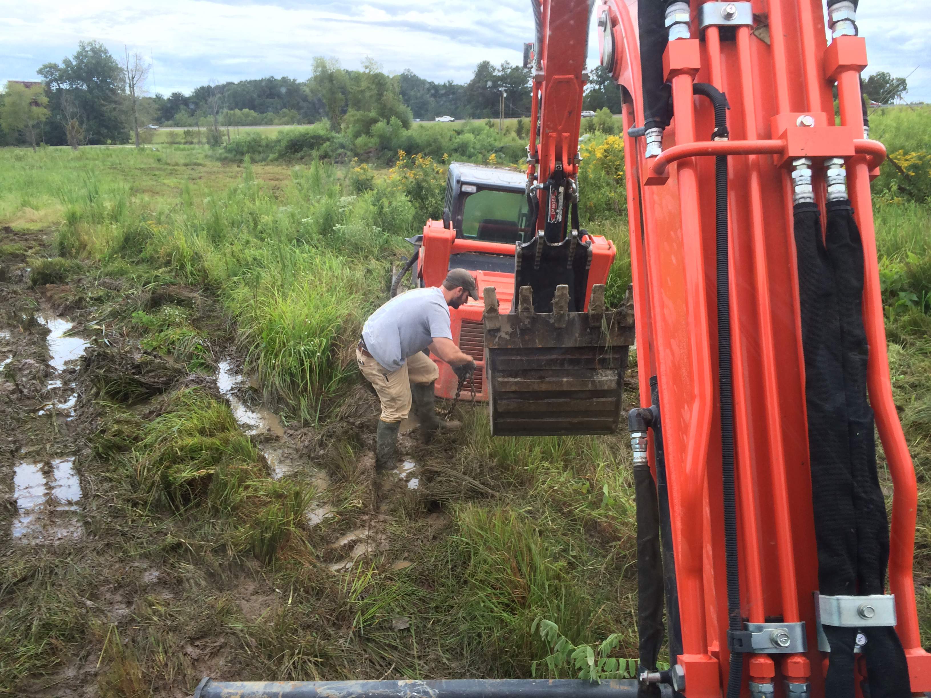

Here're some pictures of some mowing I did yesterday. The focus of the pictures was more the getting stuck than the mown, but I got stuck 7 times in ~5 hours of mowing.

wow, I probably would not have put my machine in that swamp. the down time kills you and the wear on the machine..
