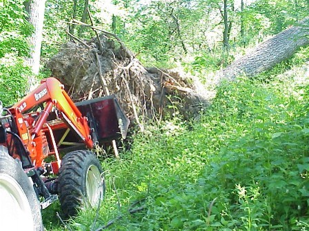

   / EZ ATTACHMENTS Landscape toothbar #19
Branson 4020's aren't bulldozers???? I thought they were? /forums/images/graemlins/cool.gif /forums/images/graemlins/grin.gif
Actually a storm dropped this tree but my Branson will clean it up and fix the fence.
Pete H&H Sales will only sell to dealers...so like you my dealer called them and ordered one which then automatically makes him a dealer for them. They said 3 days and it will be shipped directly to me. They bill my dealer and I then pay him.
Sure hope I gave them the right measurements... 65 3/8. Does that sound like what yours was?
I think you should get a commission from H & H for posting your toothbar. /forums/images/graemlins/wink.gif Now my dealer might be selling more.
Off to the woods to clean up storm damage.
Have a good one,
Ron
