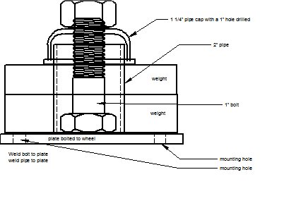

Try this for the 2" hole weights. The bolt is welded to the plate, then the pipe is welded over it to the plate. The pipe cap needs to be larger than the pipe, so the cap can slid over the pipe.

You can get the same plates as the ones with the 2" hole but with a 1" hole at W/M. You have to get a Manager or a assist-manager to call the vender to order them. Don't let them tell you that they can't. I know they can because that is how I got my 50 pound weights with a 1" hole.
   / EZ Weights Wheel Weighting System #13
Thanks for the information. I will try ordering the 1" plates first, then I will try the cap method. What do think is the minimum thickness for the backing plate? I have lots of 3/16" plate steel and smaller. Do you know if the Walmart weights are the machineable or non-machineable type of cast iron? If I could drill the first weight, then I could bolt it to the backing plate to make it stronger.
   / EZ Weights Wheel Weighting System #14
If I remember right I used 3/16" plate. Yes you can machine them. I had a friend machine a recess into the first weight that I put one each side. I did that so that the bolt head would have clearance and the weights would sit level.
   / EZ Weights Wheel Weighting System #15
That's great to know. I will stop by Walmart this weekend and order the weights.
   / EZ Weights Wheel Weighting System #16
