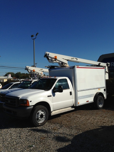

Done deal. I just have to make another trip to deliver the rest of the money, insure it and get a temp PA tag to bring it home. It'll probably be almost 2 weeks before it's final, but the deposit is there and the truck is mine. Went down and looked it over and drove it about 10 miles today. They showed me all their facilities and introduced me to most of the crew. Quite a selection of bucket trucks there.
Now to get some pics of the current one and get 'er listed. But here's the new (to me) truck.

Neat how the boom is mounted on an enclosed bed. Around me, all you see are booms on service beds. My brother and I went to a DPW auction one time. We bid on a 1970's F350 bucket truck. We didn't win. Just wanted it to limb trees and whatnot.
The motor & electronics are inside the splicer box, keeping that stuff out of the elements. First time I'd ever seen a setup like that.
