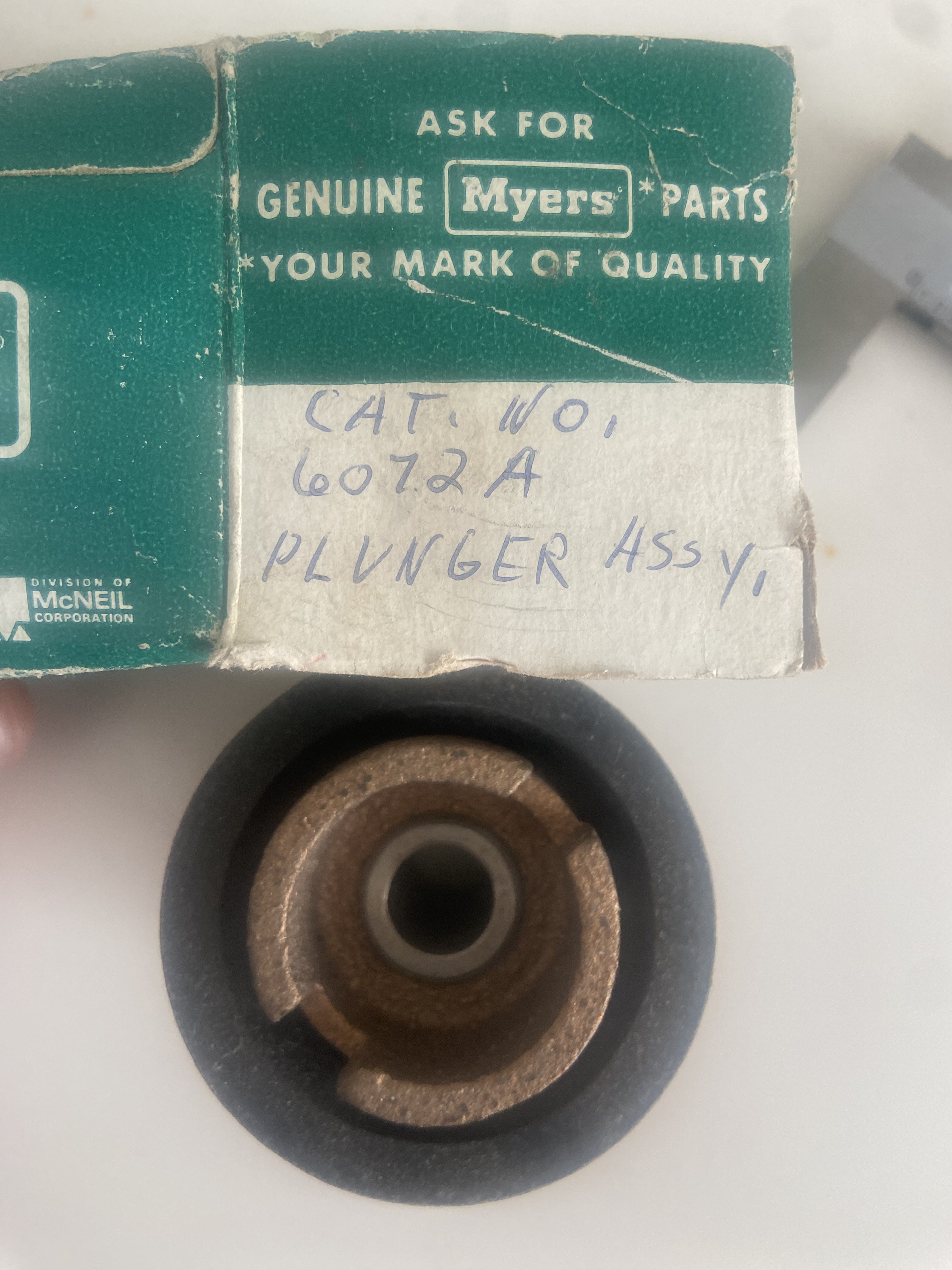

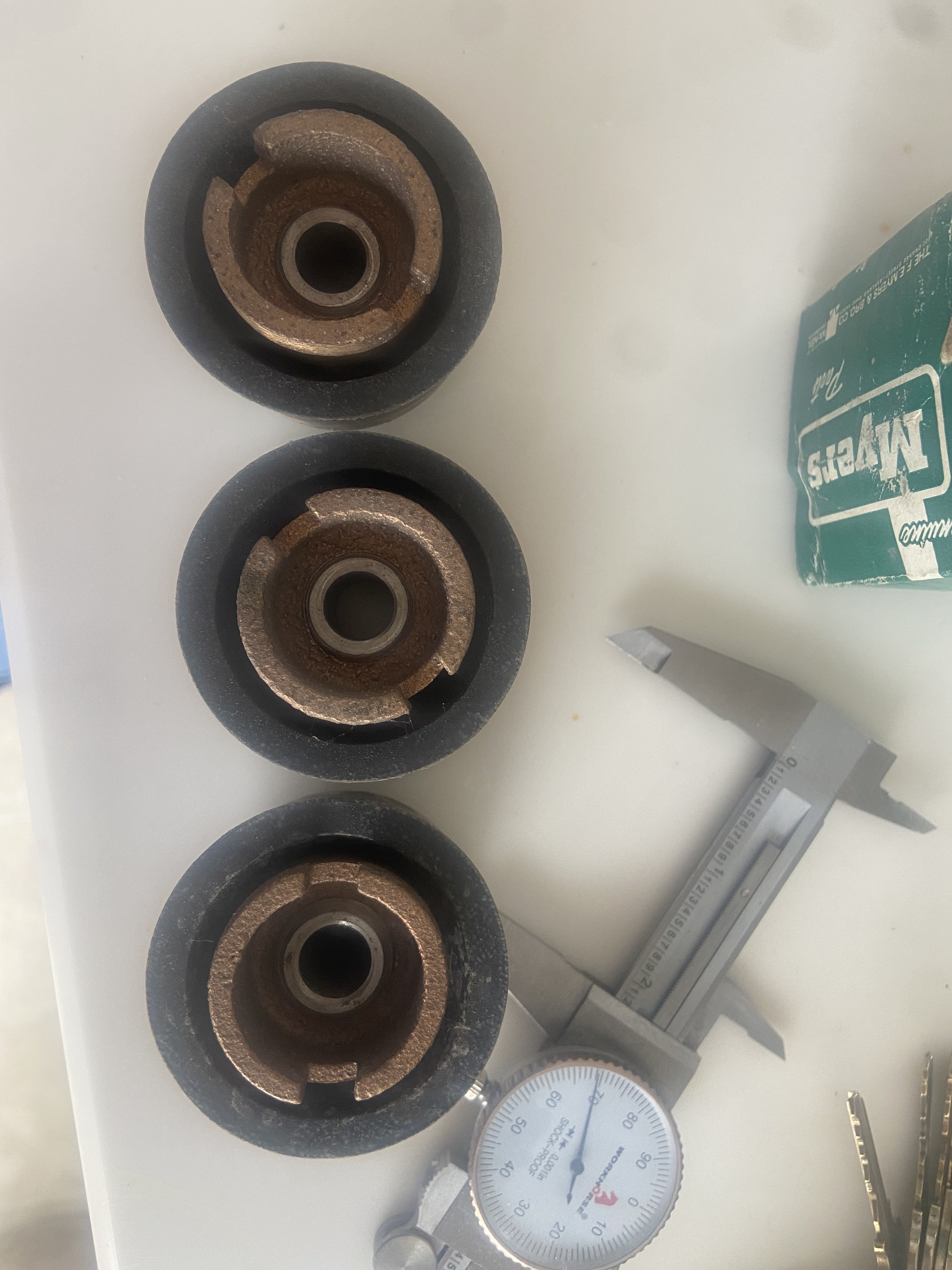

NOS Piston cups showed up, look pretty good. They are pretty stiff. I am wondering a couple things. 1) Is this the way they come? Seven Gables has noted that they are tough to get in, I assume this maybe what I am going to encounter. 2) What is a good lubricant that can be used to assist and install these units? I have Murphy's tire mounting lube, Lubri-plate assembly lube, brake caliper grease, wheel bearing grease, lots of motor oils, graphite powder and spray and half a dozen different liquid soaps. I am leaning towards using tire lube to prevent any issues with unintentional degradation to the rubber cups.

Yeah stiff is how I remember them . I think you’re tire lube would probably work good. Best I can remember I just used whatever grease I had on hand, thin layer on both on the cups and cylinders. Pretty sure you’re going to want to soften them in some boiling water also.
One other thing, I always replaced the gaskets at each end of the ceramic cylinders whenever I replaced piston cups. This was on a John Bean pump, I assume the Myers would have similar.
Be nice if you’d post a picture of the NOS cups along side the cheap imports.
Also do the nos cups measure 2 3/16” OD like they claimed?

They are pretty darn stiff. Not sure if that is from age or that is how they are.

Asian units have yet to arrive, I anticipate a month or so.
