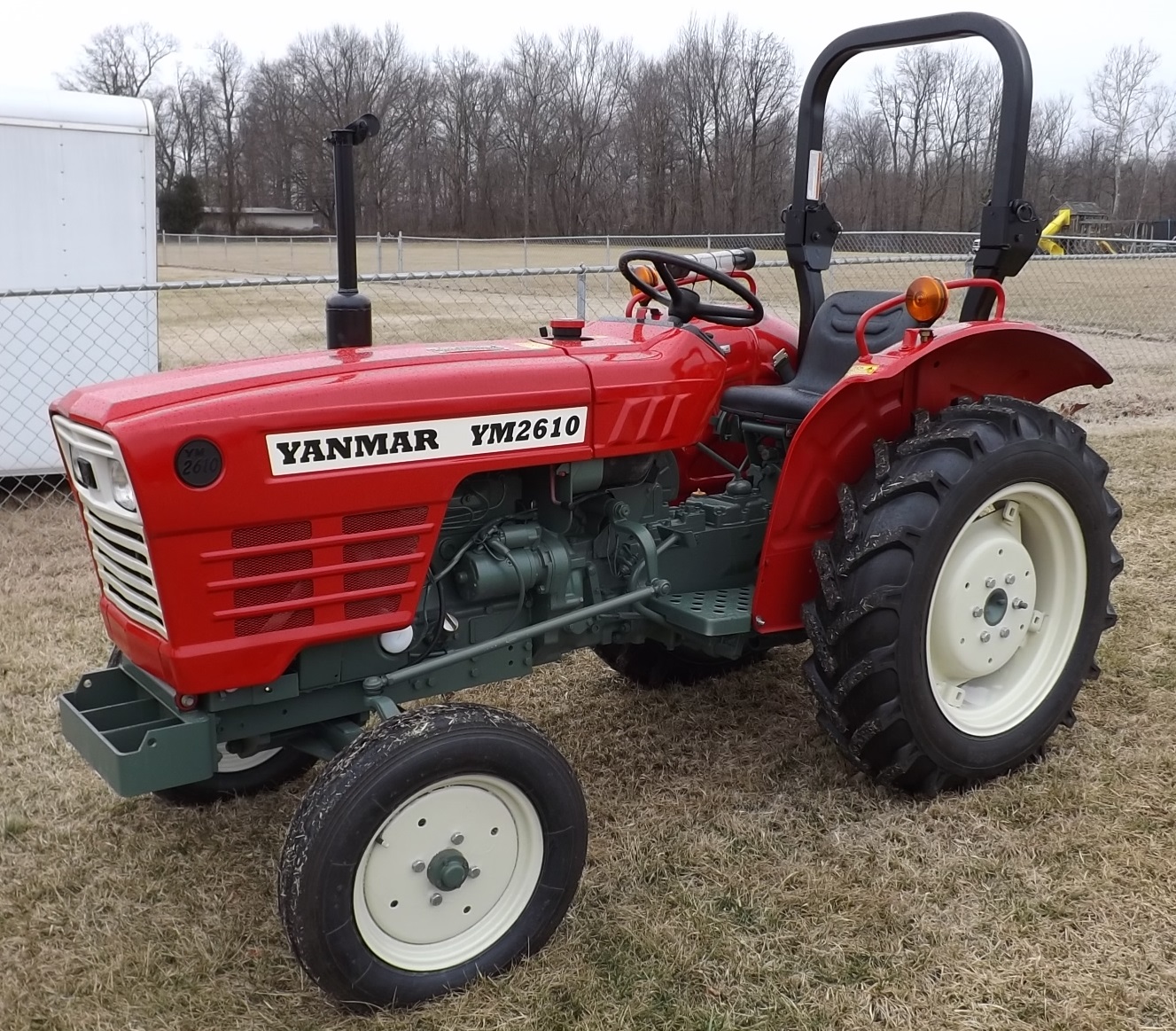

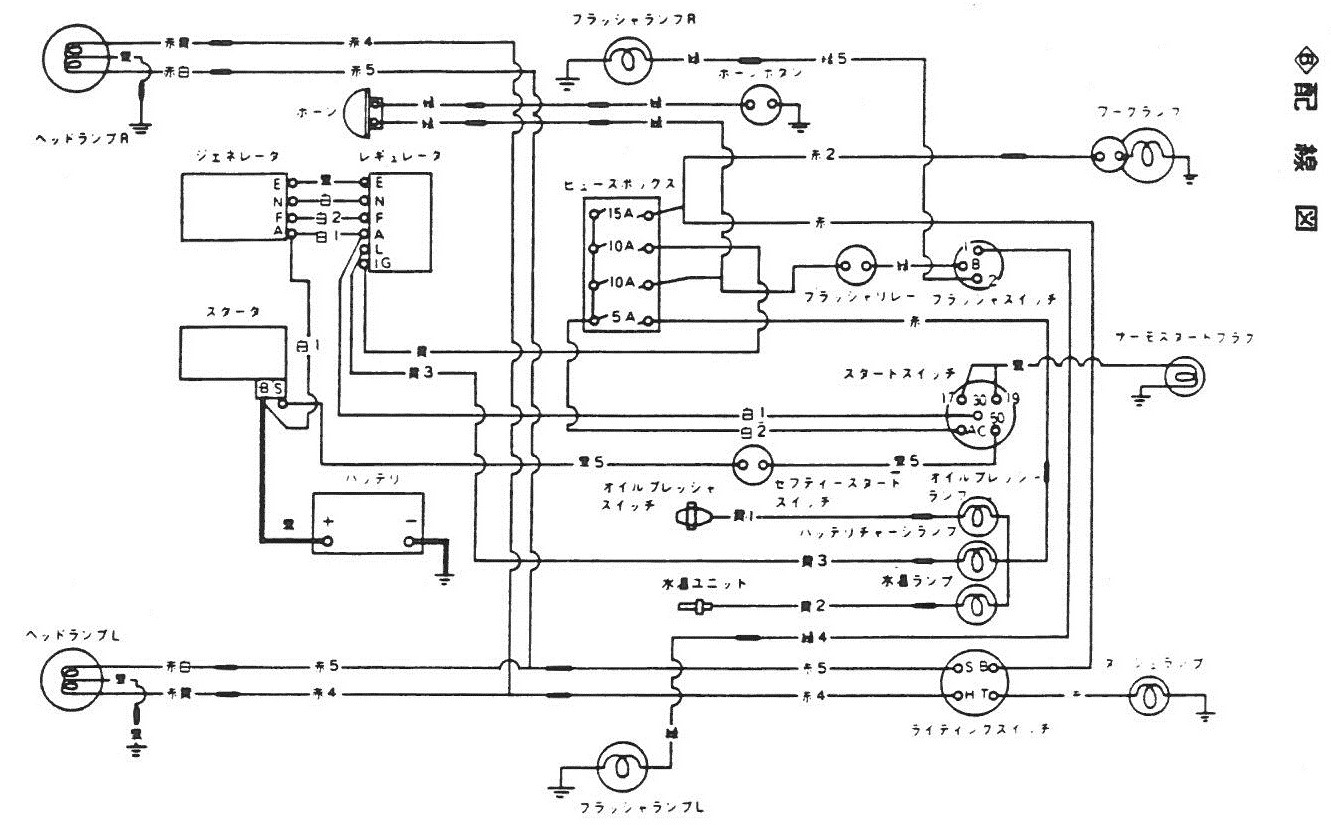

You only have a thermostart plug. Tried to circle it with paint but wasn't smart enough to do it. Just follow the little hose down from the bottom of the little container. The thermostart screws into the top of the intake manifold. Your 2610 may not be exactly like the picture of my old 2002D but will be similar.

Oh, now it's even harder to figure this out. haha Back to square 1 to figure what is a thermostart heater. :p
I only assumed it had glow plugs like the others.

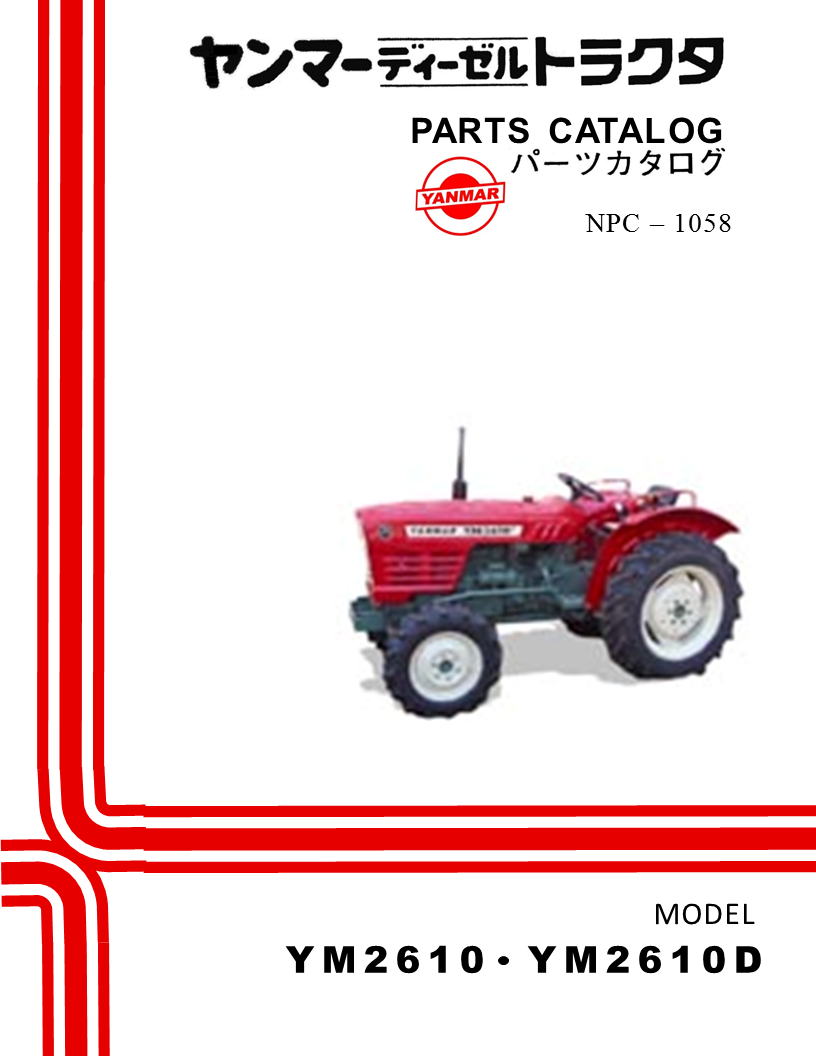

Why does Hoye show this for the YM2610 ???
Home/ YM2610_2610D» ELECTRIC» GLOW PLUG (THERMO-START PLUG)
GLOW PLUG (THERMO-START PLUG): Yanmar Tractor Parts
Does it have BOTH ??? I'm looking for any intake heater too. :)

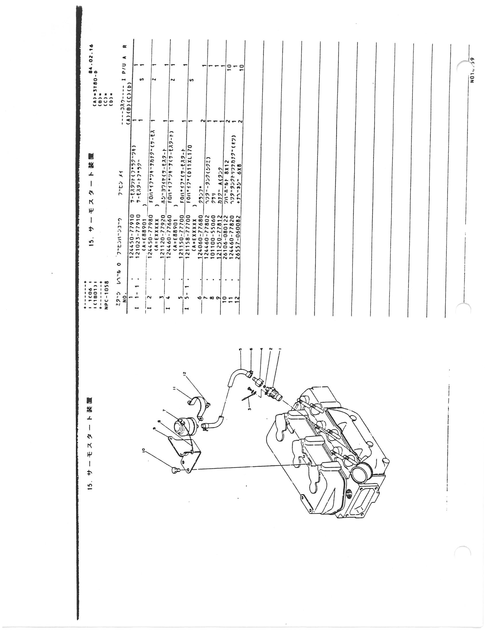

Now, I'll have to look thru all of those scanned pages. :duck:
So, there isn't much to go by on the heater or glow plug in this ... Anyone got an idea in this image? Maybe R1 ???
You should have little trouble locating your thermo-start on your tractor. Follow the lower line from the small fuel reservoir bottle. It on mine is plastic and a brownish color. Follow that line to your intake. The thermo-start will receive fuel and electric power.
To over simplify the process, it burns a limited amount of fuel to preheat the intake air to assist with cold starts.

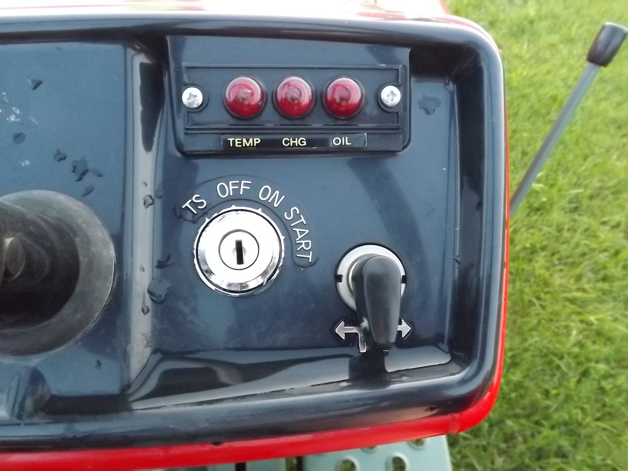

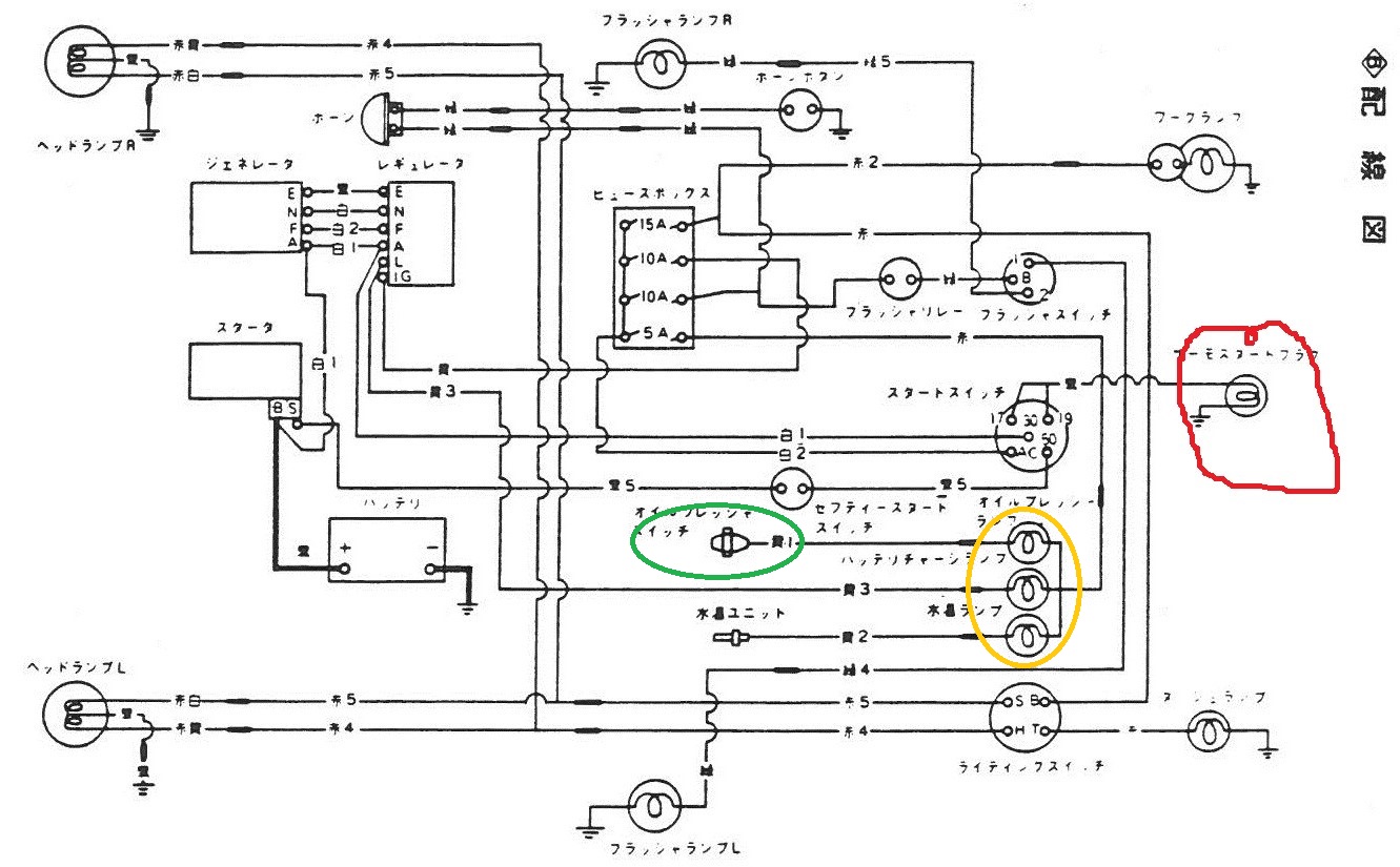

When looking at the electrical schematic, I thought the 3-in-a-row were the dash lamps. Thus, turning the key full left to TS would be the R1 path.
See my circle in green for the thermostart (maybe?) and the 3-in-a-row dash lamps (maybe?). :2cents:
But it all makes sense with California's link to Hoye and you image under the white bottle with the hose. :thumbsup:
It took a bit of time, but I think it's here as 124450-77910 and/or 121023-77910 (A=E88901) ... And this mounts into the intake manifold. hmmm
It reminds me of the cigarette lighter in a vehicle, just a bit different one would guess. :dance1:

So, I'll need to see if fuel is getting to the thermostart device. And to check for it getting hot. If it's dead, I can order a replacement. :thumbsup:

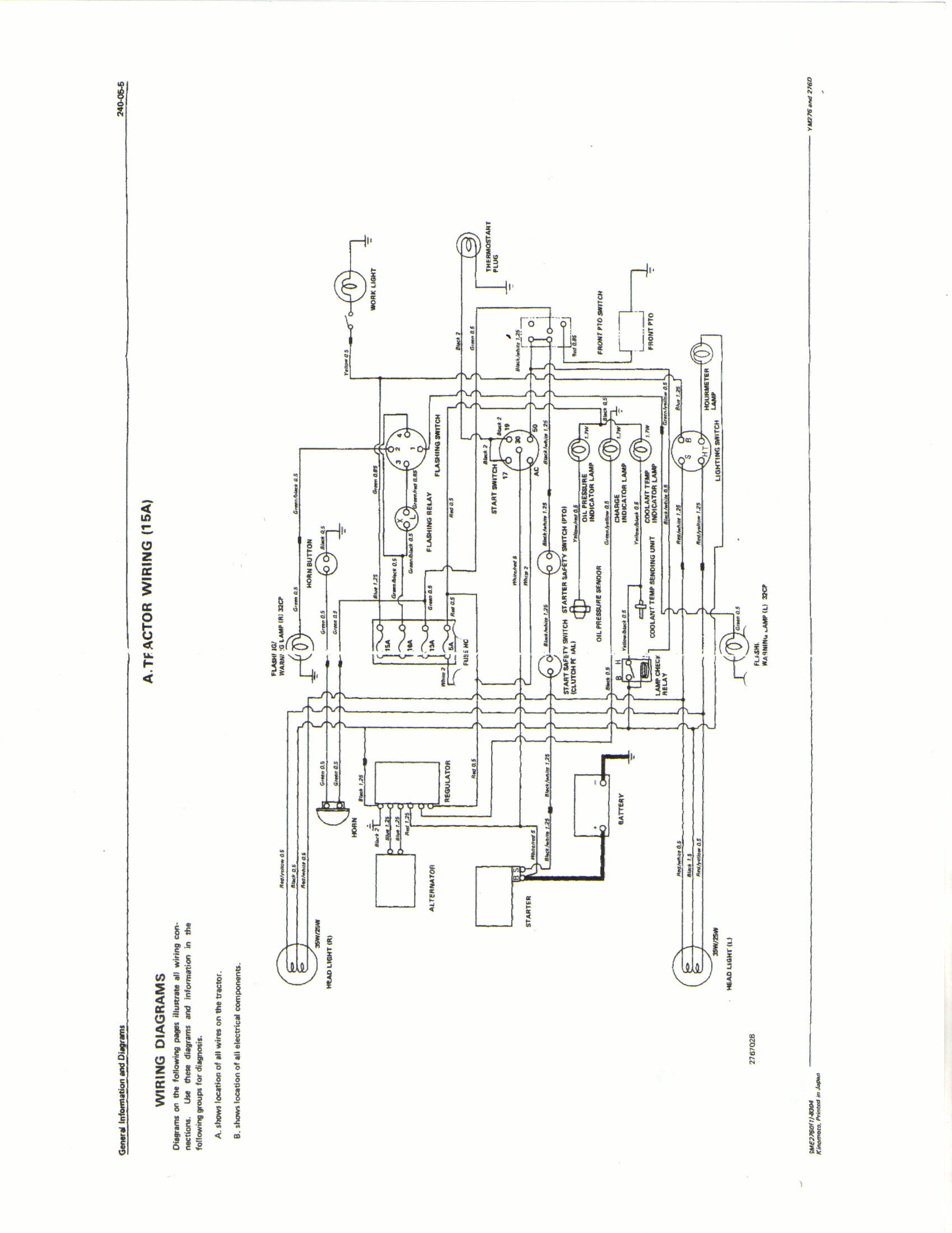

View attachment 634155 View attachment 634156
The one you have circled with green is the oil pressure sensor. Attaching the 276 schematic, very similar to your 2610 and in English, should help you.
