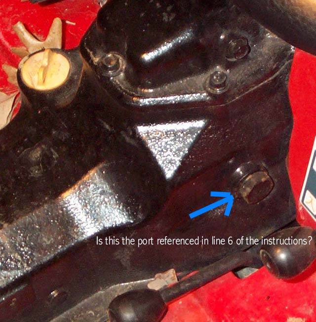

Buck, thanks for the info. If I understand you correctly, there is typically no fluid flowing through this line unless an over-pressure situation is created? The instructions that Koyker faxed to me are not that great. They have a stub out coming out of the valve body for the 3 pt. and then have a hose "t"-ing off to the sump from the loader valve body. But that doesn't really make sense with what I have to work with because the pby line needs to go back on the valve body. Do they want me to remove another of the port bolts in the 3 pt valve body and t off of that?
I haven't cracked it open yet, but I think the port on the side of the transmission housing will allow me to plumb the return hose into the sump. I attached a picture, has anyone used that port as a return?
I'll also attach the instructions Koyker faxed me so you guy's can see what I am talking about. I plan on working on this tonight after work, but I am trying to be careful so I don't screw anything up.

   / F16 Koyker Loader Install
picture of the return port
