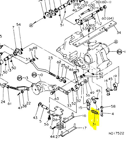

   / F24d #6
The only spring I see that sort of matches your description is the highlighted spring below. I'm pretty sure that spring is internal and could end up in the bottom of the transmission if it came loose.
Does the tractor move when in 4wd?
   / F24d
I am not sure if it moved in 4 wheel drive. I believe it was in 4 wheel because I was pulling a 2-14 bottom plow. I will look and see if this is it. Thanks this may be a break through.
   / F24d
Question though. Would this affect the drive train? This looks like it is for the 3-point.
   / F24d #9
The spring would not... unless it fell in between gears or something but you would be able to see if it was chewed on.

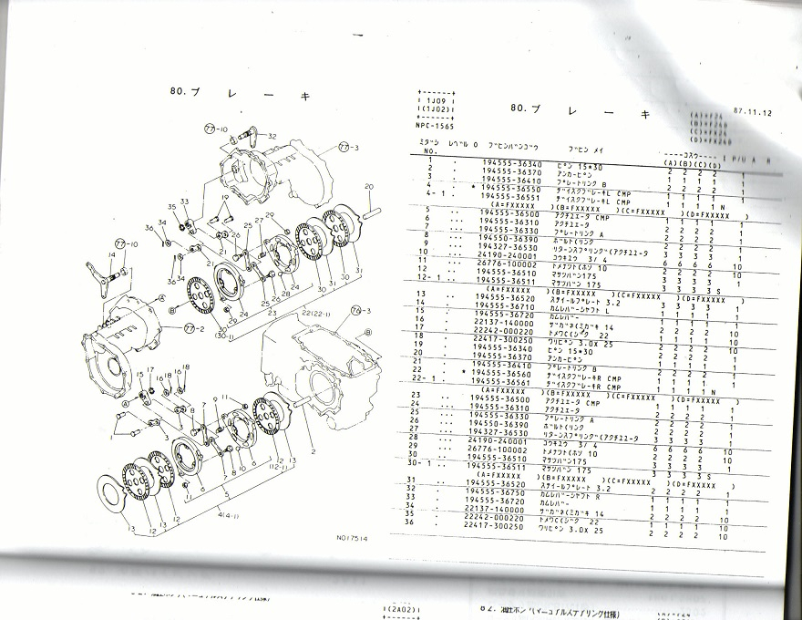

   / F24d #10
probably wrong but spring #37 looks external to me. Wonder if it could be #9 or #27 here. Shows there should be 3 ea of them. 4 wheel drive knowledge is important. This model noted for ring gear and pinion problems.
