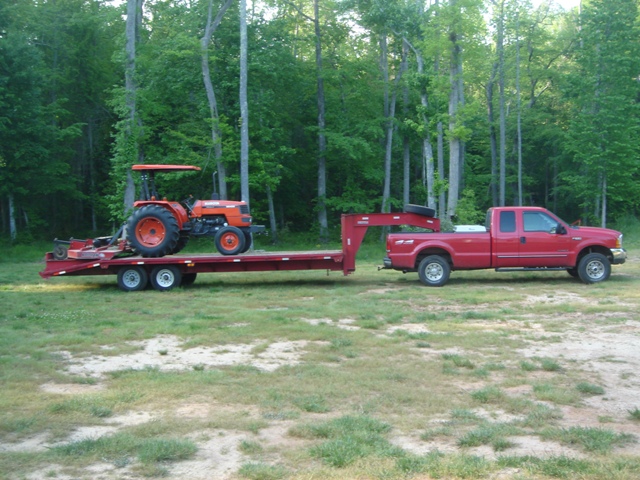

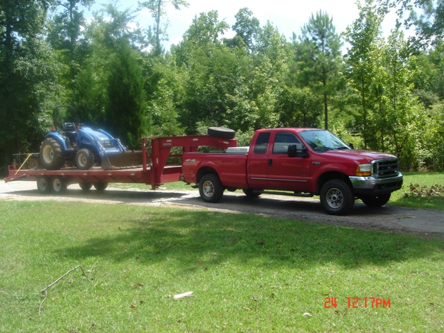

I do it all the time. In pics below both machines are in the 5000 to 5500 lb range. Sorry, that's all the pics I have. When I move my T190 with a spare bucket, or take the grapple, I'm close to the 9000 lbs range. Before I bought my T190 I rented a Takeuchi TL150 that weighted over 10,000 lbs., truck / trailer handled it with no problems. I have also moved a Takeuchi TB145 mini ex that weighted around 11,000 lbs. You definitely know they are back there. Allow some extra distance for stopping.
Truck 1999 F-250 7.3L Powerstroke Diesel auto trans 4x4 ext cab long bed. Michelin load range "E" tires.
Trailer is a North Alabama 20 + 5 gooseneck with 7k axles, electric brakes on both
