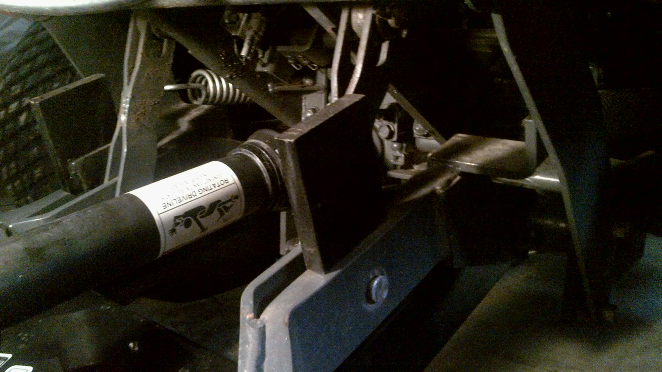

Jul 12, 2022 / F2880 - What are these parts? #1 C cray54 Member Joined Jul 15, 2010 Messages 39 I received a box of spare parts when I purchased a used F2880 mower. Any idea what these are for? Thank you, Chris

Jul 12, 2022 / F2880 - What are these parts? #3 T TractorTech Elite Member Joined Jan 26, 2012 Messages 2,774 Location California Tractor Ford 7710, Ford 550, Ford 1910, Ford 4430, KD Forklift, Ford LGT17H, New Holland L255 Skidsteer Not so much aftermarket as they are probably packing/crating parts that got left on the mower after it was setup.

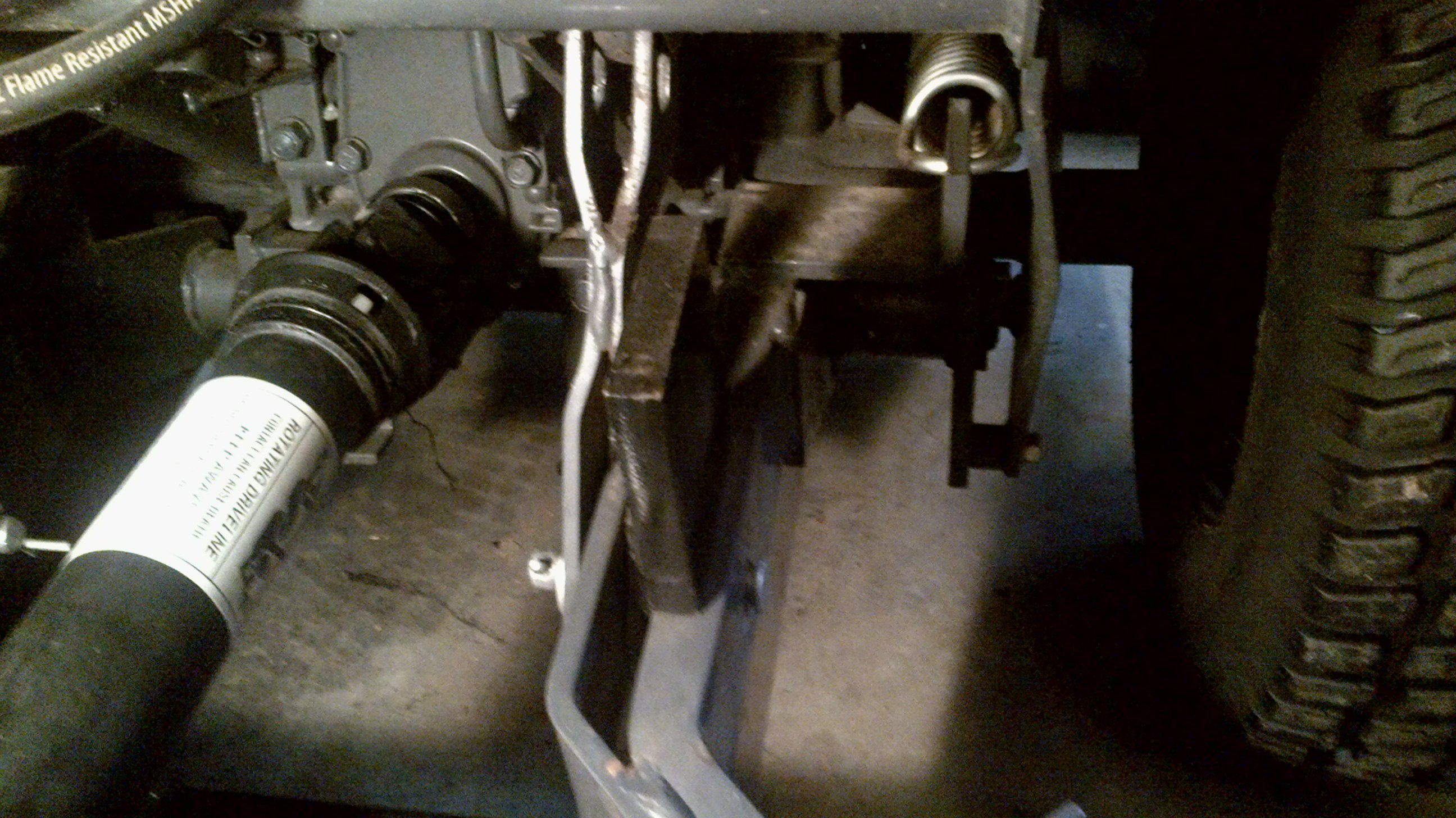

Jul 31, 2022 / F2880 - What are these parts? #5 S Sigogglin Bronze Member Joined Oct 26, 2018 Messages 55 Location Goshen, VA Tractor New Holland TC45DA I have those for my snow blower. They limit the lift height so the blower doesn't hit the cab.
Jul 31, 2022 / F2880 - What are these parts? Thread Starter #6 OP C cray54 Member Joined Jul 15, 2010 Messages 39 Sigogglin said: I have those for my snow blower. They limit the lift height so the blower doesn't hit the cab. Click to expand... Oh awesome - any chance you can share a picture of how they are mounted?
Jul 31, 2022 / F2880 - What are these parts? Thread Starter #7 OP C cray54 Member Joined Jul 15, 2010 Messages 39 Sigogglin said: I have those for my snow blower. They limit the lift height so the blower doesn't hit the cab. Click to expand... Thank you so much for the reference. I did some searching and found a picture of how they would be installed here: F3080 snowblower question Dan W said: I took some pictures for you, see what I mean... Dan View attachment 358014View attachment 358015 Click to expand... Now, I don't have a snowblower, but my mower deck does bump the cab if I lift it to full height. I'll try these out and see if that resolves it! Thank you, Chris
