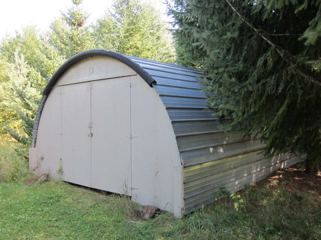

Here is my first garden shed. It is 14x40 and started out as old greenhouse hoops. The bottom of the hoops sit in drilled pockets atop buried 6x6 treated posts. That gave me extra height for the tractor. The hoops were bent up a bit so it is not as straight as the other building. It has wood walls on each end so I store the equipment I don't use much in the middle.

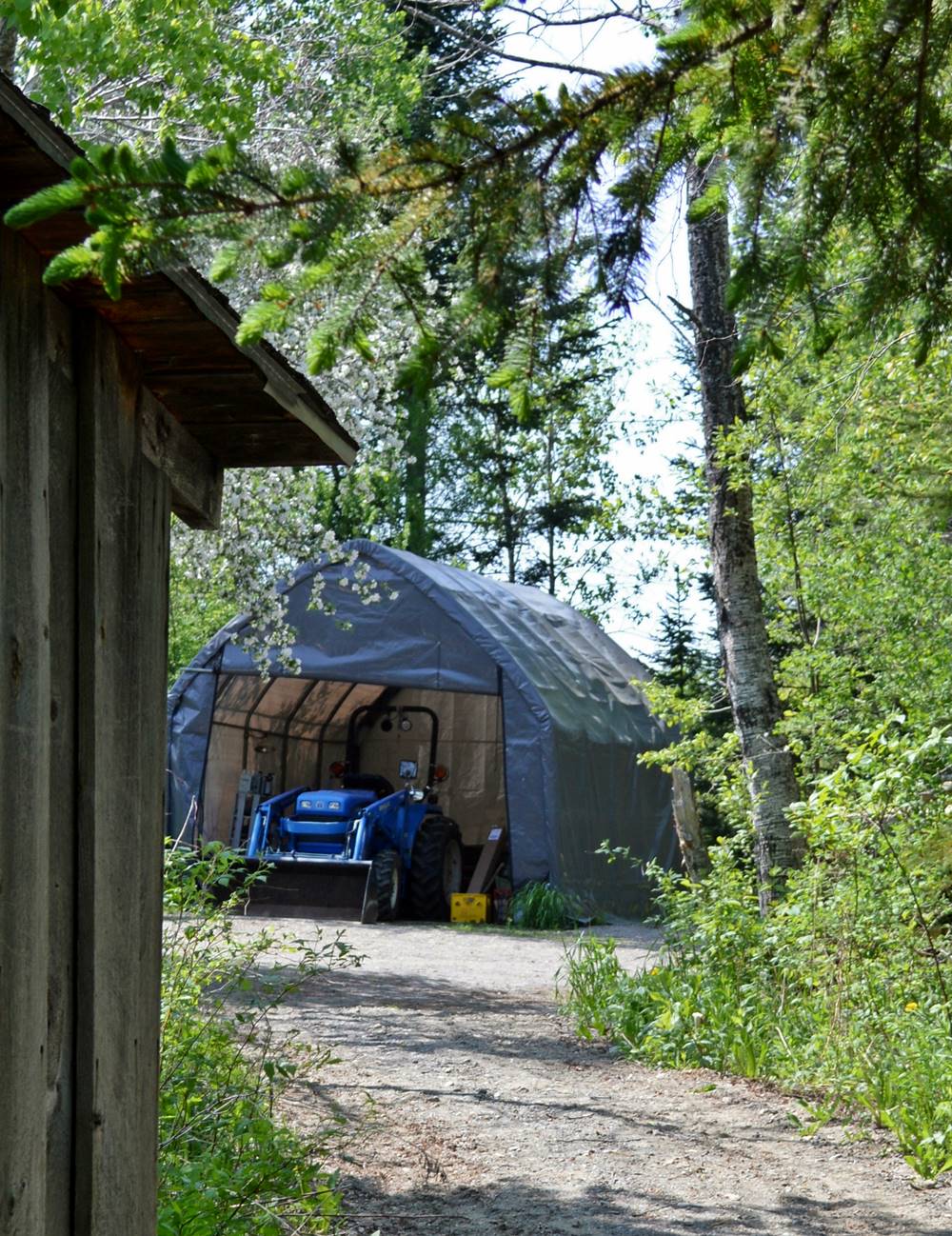

Helped my neighbor set up one of the shelter logic hoop type shelters this spring to use as a temporary tractor shed. The construction was a lot more robust than the gable end shelter of mine that flew away in the wind storm. The ground anchors were also much, much more robust.
We moved it recently from my place over to an area he had cleared on his property. Simply picked it up with ratchet straps hooked to the ROPS and chains hooked to the FEL, and drove off with it. Went slow, felt like I was a giant turtle with tunnel vision of only what was straight in front of me! We had to pull the anchors with the FEL, I was worried that the auger plates would get stripped off, but they came out with minimal damage.

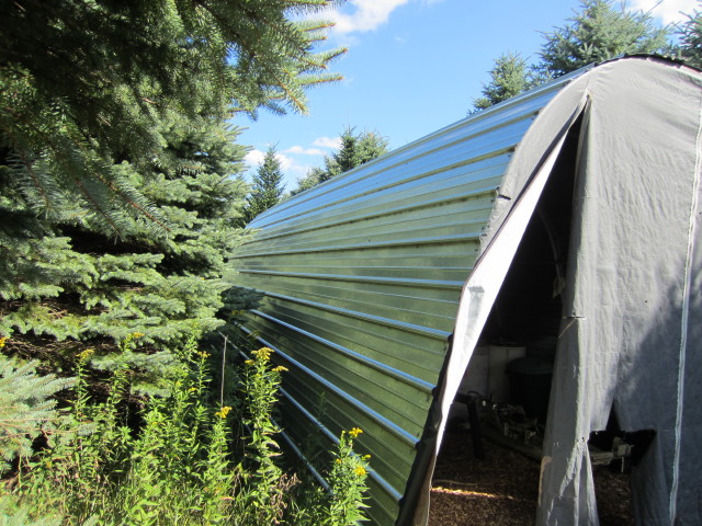

I did note that the fabric cover seemed to rip fairly easily if not handled carefully, this was at some of the stress points at the seams and corners when we were installing it.
Covering it with metal as Ruffdog has done would certainly make it a lot more durable.

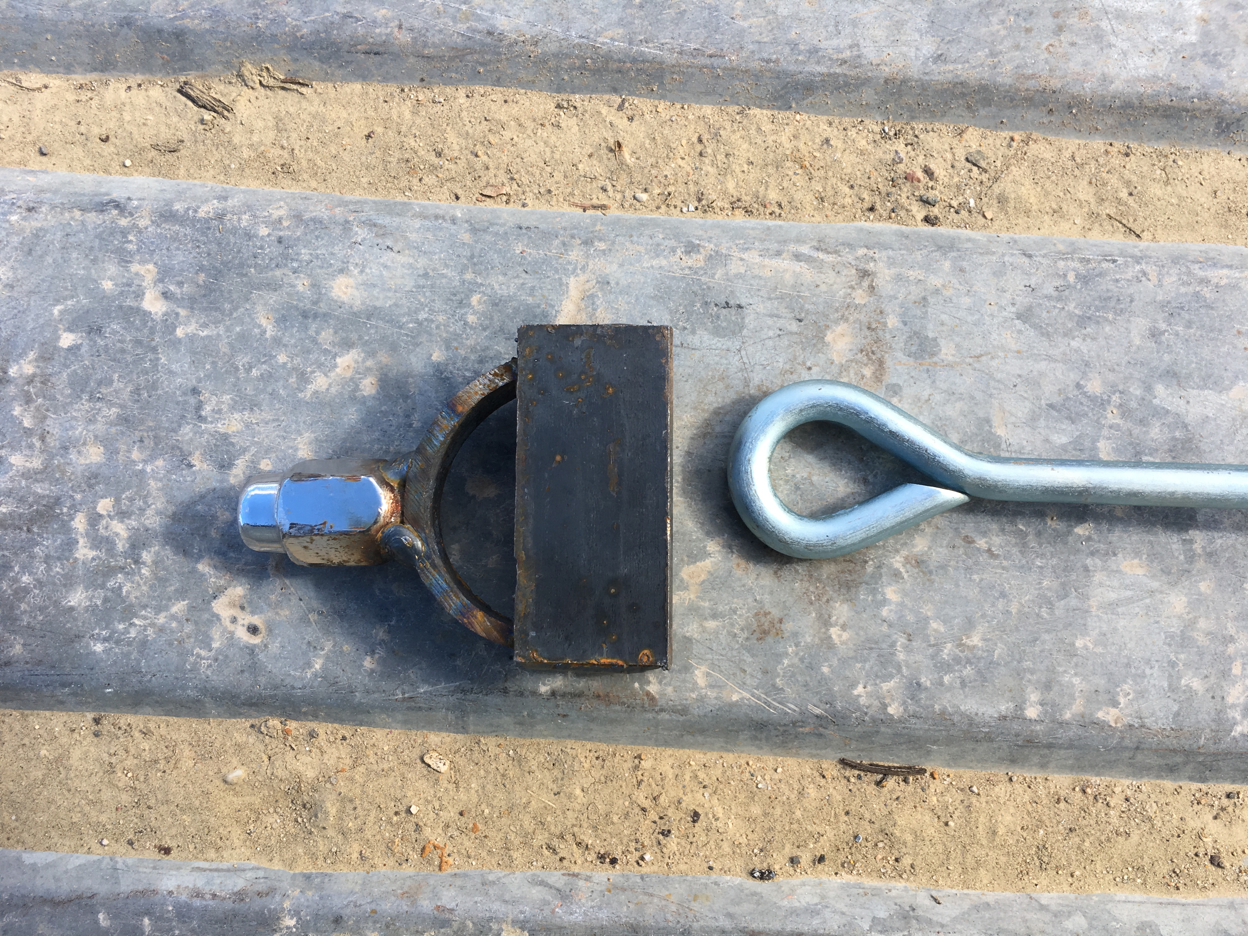

Just a pic of the anchor driver I made to use an impact. I got six HD 30 inch anchors from the local farm store.

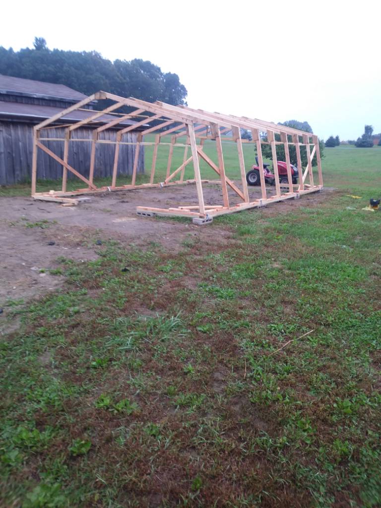

I'm in the process of building shed cover for my tractor, implements and anything else that fits. Have a 15x15 foot patio out from basement and will be attached to house on upper side, and 4 posts along sides and ends. $350 for wood and fasteners, and $400 for Ondura asphalt corrugated roofing and fasteners for roofing. Looked at metal, but too many issues with my location and height I wanted. Would have been over $2500 but installed rather than me build.... I can enclose the two sides for another couple of hundred so a thousand spent max.... saved $1500 minimum
