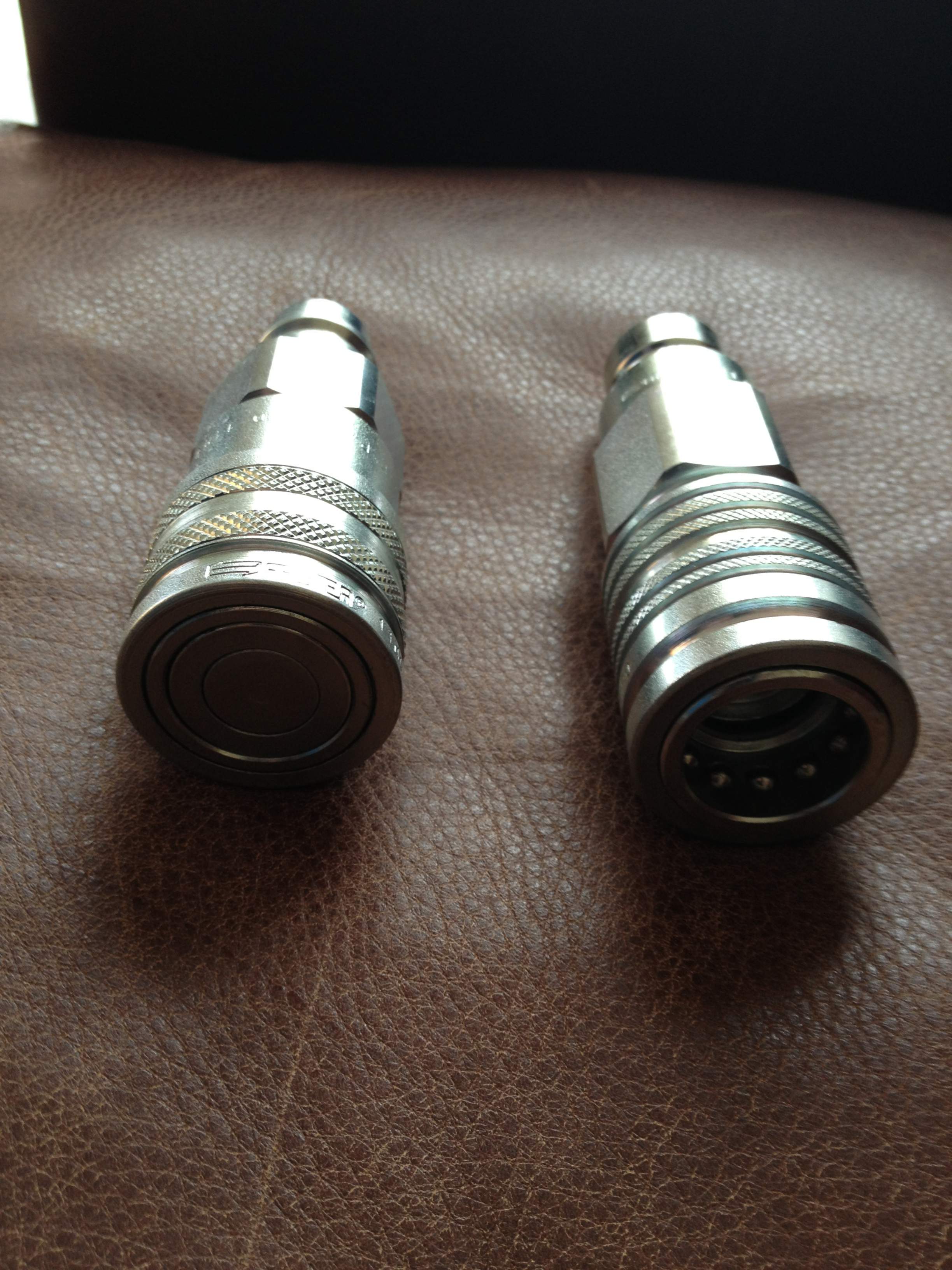

Nice job adding the flat face couplers, just unplug the hoses if you need the AG couplers.
What sizes are the R4s?
As for options, I like how (on the JD 6415) it goes into 4wd when you brake
   / Factory Fresh 5085M
#44
Can't remember R4 size. Maybe 19.5l by 24? I'll look. Just finished going back and looking at the thread from all you guys about the standard duty hitch and telescoping arms. I mean I sat in the office with Dad and the salesman and heard Dad ask at least 2 times about the heavy duty hitch and the salesman said it would have it. I think Dad has the same situation pclausen had... Larger lift cylinders with standard lift components. Nice...Like most who order the "Heavy Duty" M series, Dad thought naturally it would have All Heavy Duty components. I guess we have another issue on their behalf to fix. We'll see. But yeah the MFWD has 3 options which is pretty cool. And an electrohydraulic locking rear differential button in the floorboard. Has some cool features for sure. I'm still impressed with the electrohydraulic hitch controls myself. Very nice. Oh and yeah we just decided to fab a bracket and keep the Ag couplers because we were spending too much time trying to match the flat face coupler masts to the connection originally going to the Ag connections. Doubt the Ag's will ever be used but they're there if he needs them. We tried JD and Parker but no luck with Ag to Flat conversion on FEL. Thought about adapters that plug in directly but they stuck out too far so we went with "pigtails"... or so we called them. Work great so far. There is one unfortunate thing about the FEL. If your implement or bucket is not sitting higher than ground level or on a trailer or something the hookup is terrible. Need 2 people. Operator can't see the hookup so far in front of and below the hood. I mean I have 20/20 vision and it's hit or miss. Poor Dad don't stand a chance being legally blind. We even looked at a camera system..haha. Dad said "forget it"! I said..."get the attachments up higher on a raised stand or something. But we've almost decided he'll be using a bucket most of the time anyway. That loader sticks way on out there. The tractor is way more enjoyable without the FEL imo. More compact and more agile. But the FEL is a very nice tool!

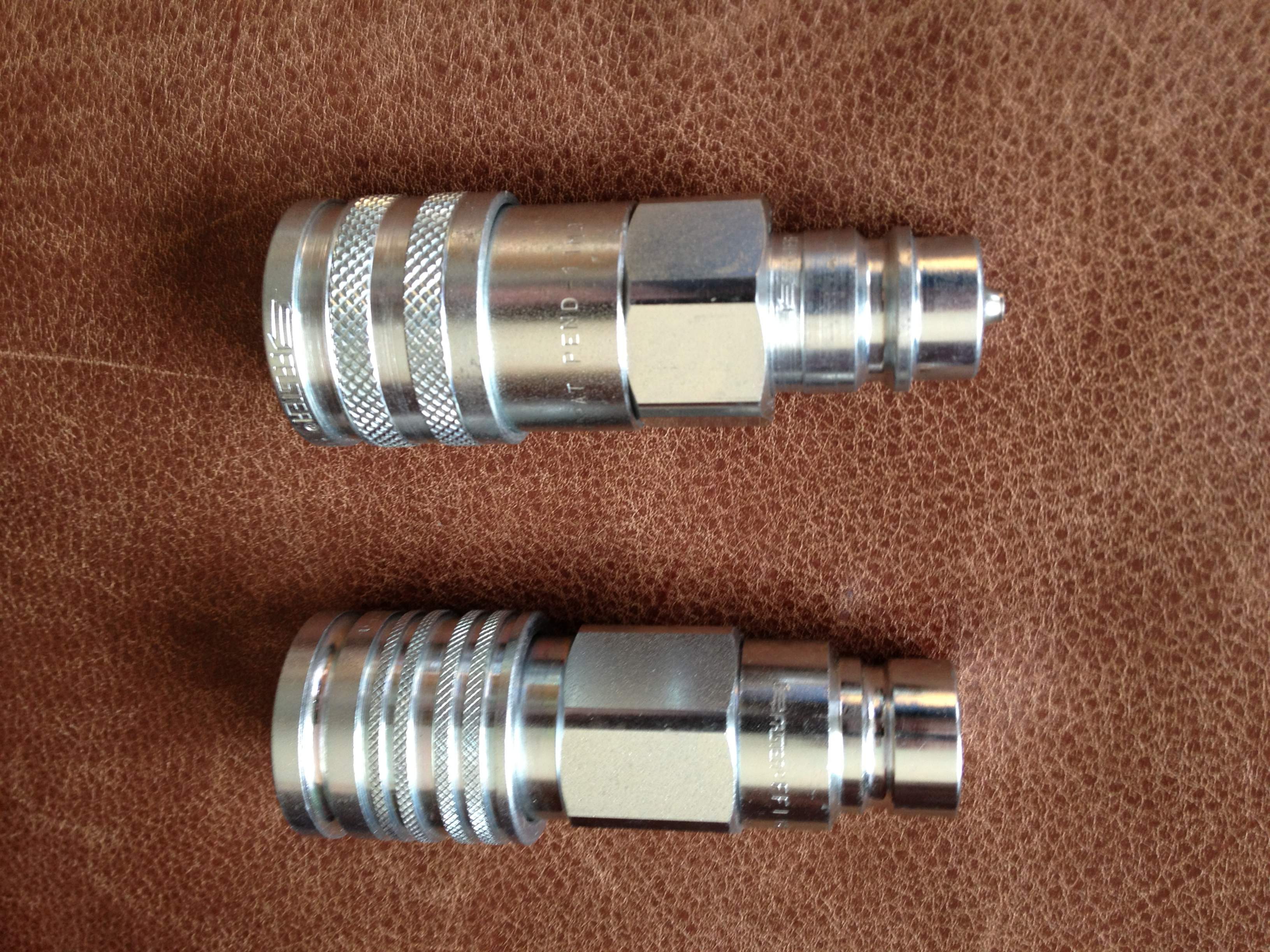

I like the coupler mount on the front. Another option is these adapters I picked up at my local Bobcat dealer. They said they sell a lot of them as part of their attachment rental business; people want to use Bobcat attachment on machines with Pioneer couplers. They have both options, male Pioneer to female Bobcat and female Pioneer to male Bobcat. They set me back about $50.00 each. I don't think I could buy the couplers and connectors to make up adapters for that. Use them for my grapple.
Jack
#50
Yeah those would have been a little cheaper and easier. I think we have about $140 or more in the pigtails set up. We couldn't find the replacements that had the right masts for the ag style and JD dealer couldn't help by changing them. No luck with Parker either. Basically we decided any adapters would probably stick out there a bit too far with the hoses connnected so we ended up just making a bracket and building some pigtails. The setup looks pretty cool but I was trying to keep it a bit simpler by changing the hook ups all together or using the adapters you show. Didn't even cross my mind to check with bobcat...and we even have a model 773 bobcat. Which by the way is amazing in itself. Dad brags on the bobcat as much as his new 5085M believe it or not! Bad little machine!!

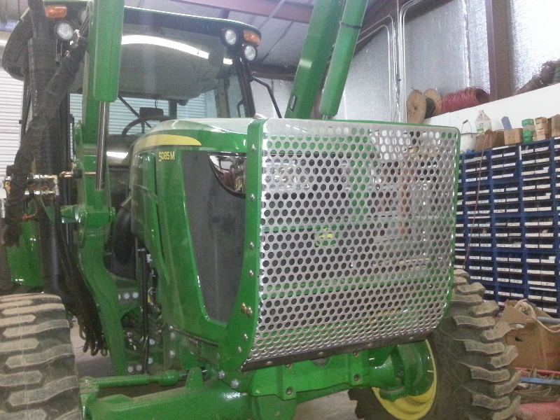

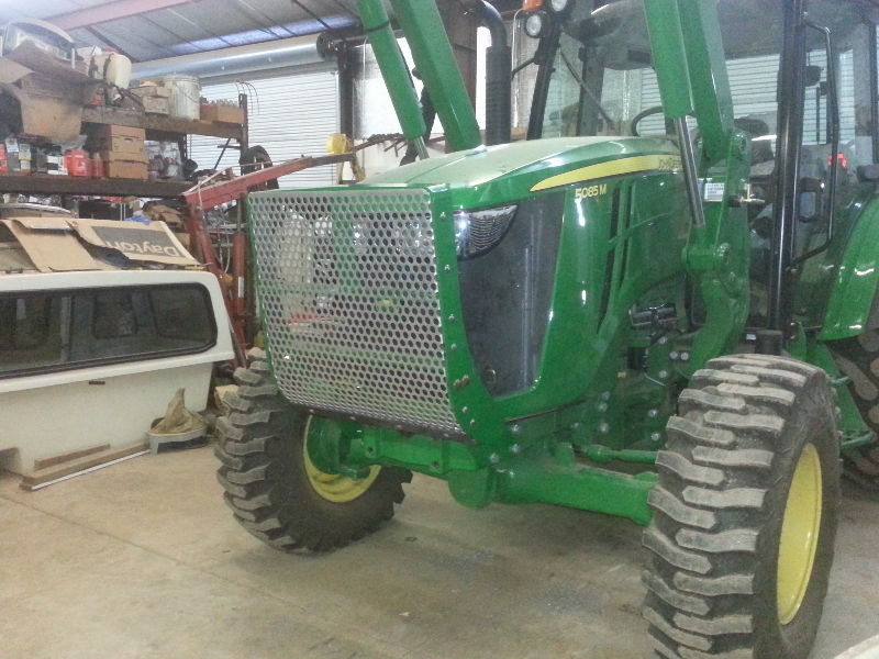

Just a recap...Dad has ordered the skid plates for the 5085M and is currently awaiting their arrival to the dealer. I'll still do my best to get pics of them before they are installed. Here's a pic of a cool Aluminum brush guard addition Dad and I fabricated. We noticed a small dent in the hood screen and decided to try and prevent that from happening again. This is some material I snagged from a close friend who owns a sign company. I believe if you're ever in Panama City Fla. you will see tons of this material used under hand railing on one of the newer Hotels. Maybe the "Splash" Hotel. The same company installed it down there a few years ago. Or if you're ever in GA. you will see it on a 5085M John Deere. Haha!! We just thought it was something different than expanded metal and it turned out very strong and looks pretty cool too.
   / Factory Fresh 5085M #52

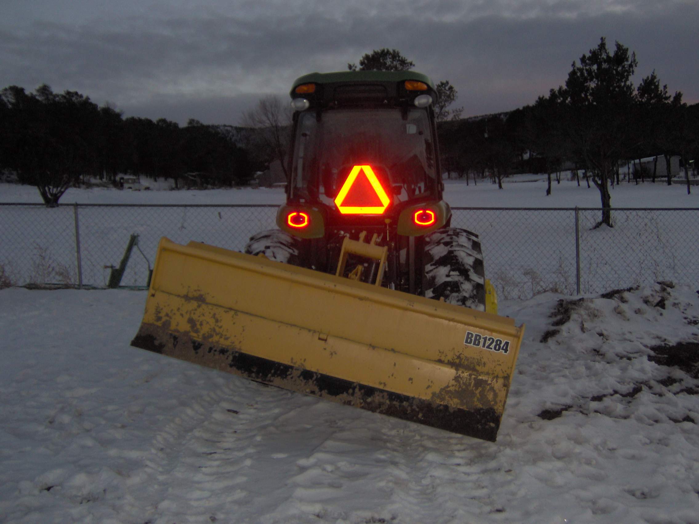

Makes the front head lights almost useless doesn't it? Of course you probably have others up on the cab. I took my factory brush guard off for snow plowing at night. I'll have to remember to put it back on in the spring before doing brush hogging and loader work.
#53
Actually, we did some testing with a giant piece of cardboard to make a decision on how to build the screen. I thought about making a smaller section in front of the headlights that would "hinge" down for night time use but, after testing the amount of light the screen restricted, it wasn't enough to be concerned about so we just left it as one whole piece. Thankfully the cab lights are extremely bright and really light the area up.
