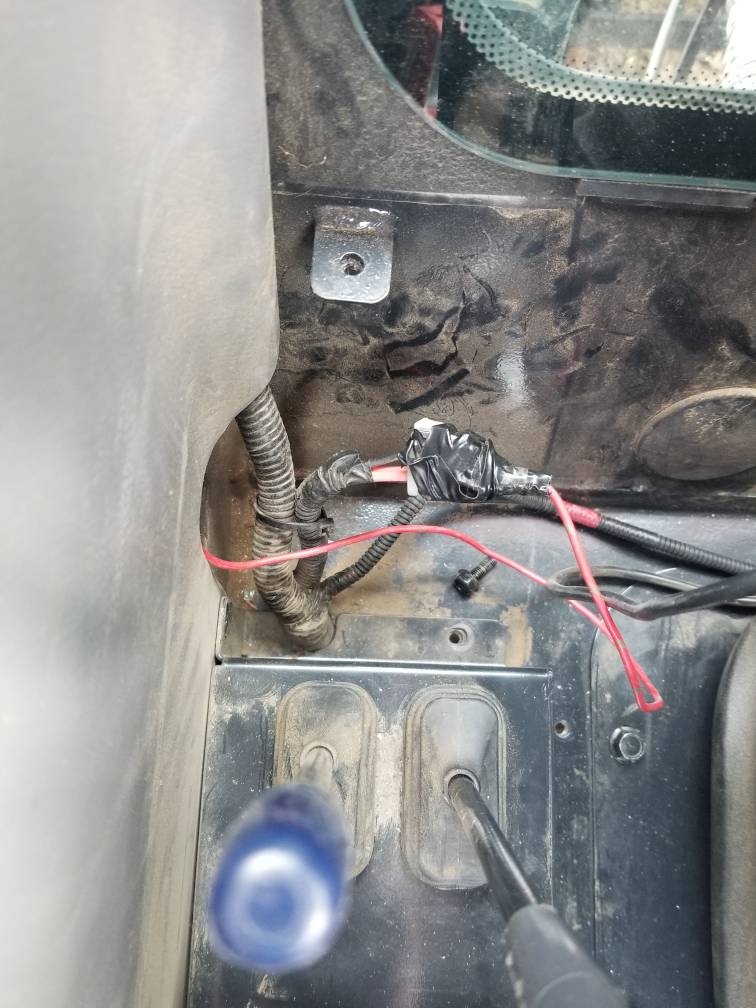

I have the same issue. The other day I was wiring in an intermittent wiper switch and discovered a plug in the back of the cab that is powered in the acc position. I used that for the wiper switch that needed power. So, I was thinking that I would look for a wire in the roof first that goes to acc, then if not, I would extend the circuit I found up a pillar into the roof.
I used a spade lug and held it in with tape until I can find the proper connector. I think the plug is meant for going out to an implement control system but I don't know for sure.
I guess I should save up for the shop manual
