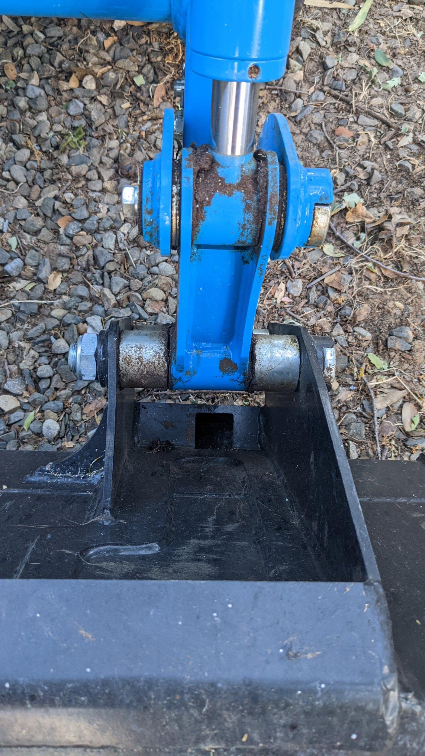

I decided to go a different direction and ordered the weld on quick-tach adapters after being inspired by this post.
   / Factory SSQA bracket for MT125 and MT122 LL1101 loader #42
@mslisaj
On your quick-tach, are these bushings still used, or are the side plates closer together? Looking at your photos, I do not see the bushings.
Nevermind, I see in your last picture no large bushings.
   / Factory SSQA bracket for MT125 and MT122 LL1101 loader #43
Btw, I took all this info about a month ago and went to a NH dealer about 2 hours away and had everything to pick up 5 days later. I have an LL1101 and everything pinned on perfectly and now the geometry is perfect when dumping ... Unlike the SSQA that the dealer installed on it where I purchased it. Side note, I also still have been pinning/unpinning the stock bucket, so I picked up an SSQA bucket too. Stock bucket for sale in WV ... Hahahaha!
   / Factory SSQA bracket for MT125 and MT122 LL1101 loader #44
You say the SSQA didnt work with the stock bucket? what year and version of that bucket did you have we have a mt125 with what I believe is set up with the ls version of quick attach bucket? will that work with the above new holland ssqa attachment?
