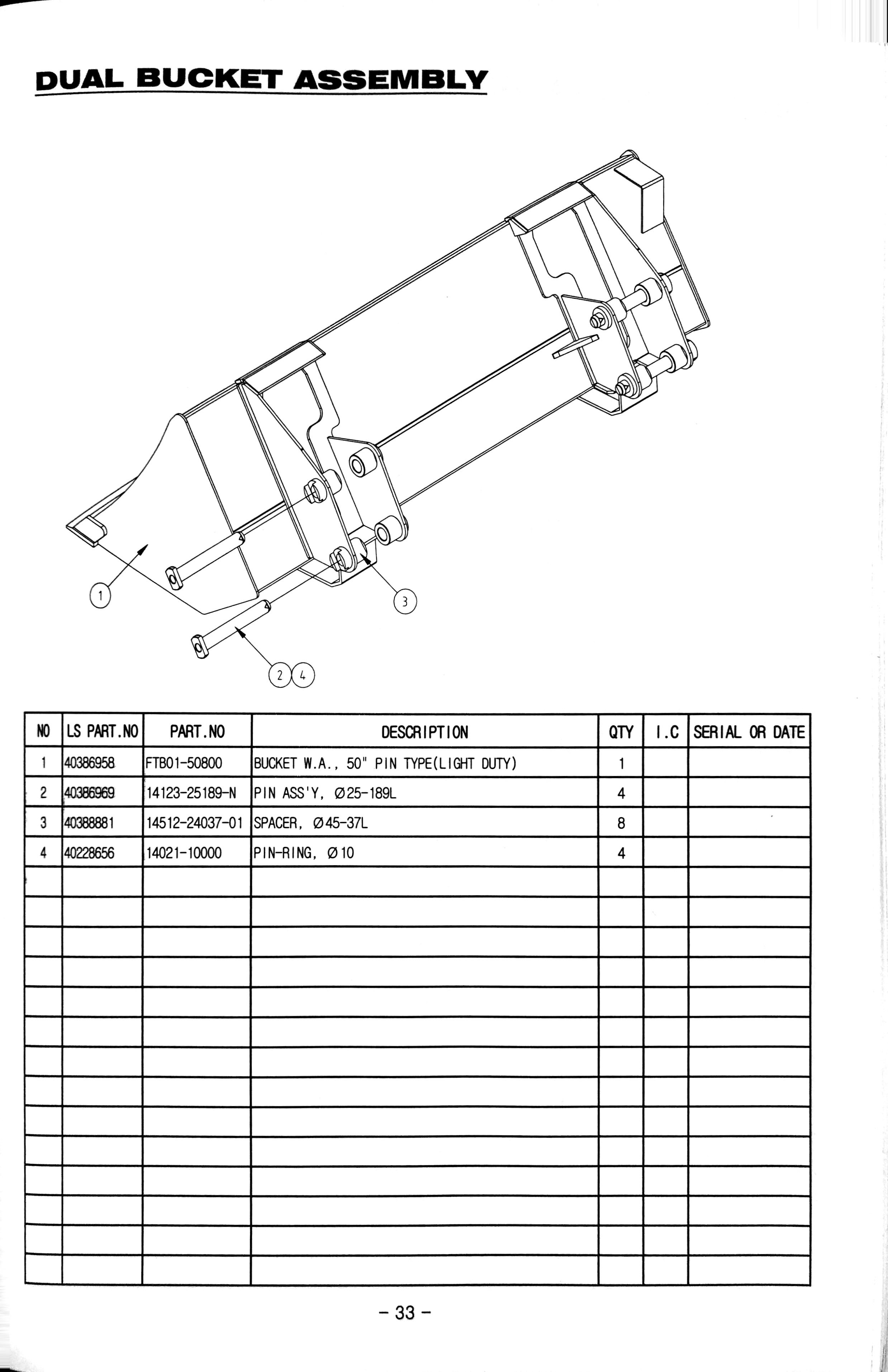

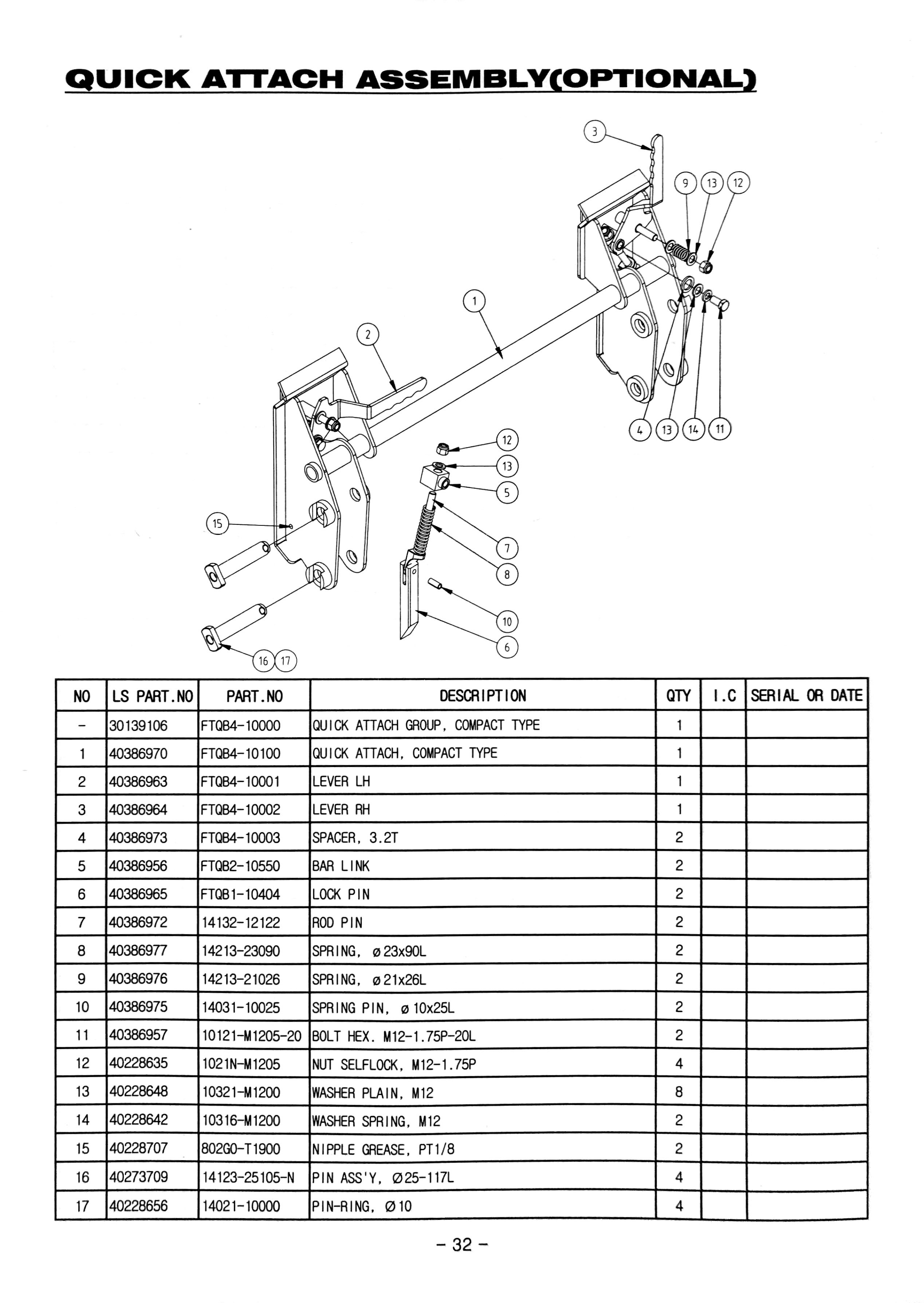

Just got hold of my new 125 and was browsing the operators manual for the loader. Mine came with the LB1101, which I assume is a new model since on page 32 of the manual it lists an optional Quick Attach Asseymbly and Dual Bucket Assembly! These are not in the manual for the LB1100. I'll figure out how to upload the picture of the manual later but for now, here are a few part numbers to pester your dealer with.
The Assymbly
Quick attach group, compact type: 30139106
Qucik attach, compact type: 40386970
The Dual Bucket
Bucket W.A., 50" Pin type (Light Duty): 40386958
Good Luck!

The MT125 I am considering purchasing (when I feel better about spending the discretionary $ after the pandemic) has the "Dual Bucket" attached. My dealer quoted just under $500 to add a quick attach assembly. I do not know if that was a factory unit or an aftermarket unit. Looking at these two illustrations I am not sure I understand how the QA fits the dual bucket with the pin brackets in place.
As soon as someone gets photos, please share! :thumbsup:

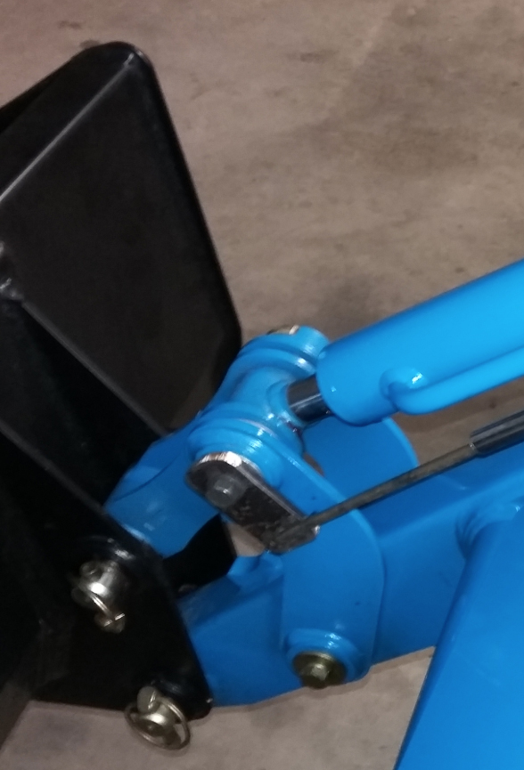

I noticed that the pins on the new QA bucket are using spacers for wider brackets.
I found a look in at mslisaj's image showing that the older bucket brackets are narrower. Because I am a newb, I can't share the link so I screen grabbed the image. (you can search the original post "LS MT125 Bucket Level Indicator" or by the user name)
I assume the QA fits in between the wider brackets.
I'm still excited to see the new adapter in use and to get a review.

/ Factory SSQA For MT-125 Coming? #9
That is exactly how my bucket is currently pinned on ... with the spacers on either "inside" of the mounting bracket of the bucket. I am hoping to hear back from the dealer which I am purchasing the LS Brand QA soon so that I can pick it up and see if it mounts similarly.

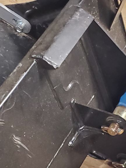

I'm curious as well, got my 125 in January 2019, my bucket looks a little different than the one pictured above. Maybe its a bad camera angle but the bucket mounts look different. Notice my inner "ear" is squared off for the cross tube on the QA to clear. The one above appears to be tapered up to the top of the bucket. The part # for the QA in my manual is 30139106. I'll call my dealer this week and inquire as to availability.
I believe this is how mine looks also ... purchased Nov 2019. I haven't updated, but the dealer that I was speaking with quit replying to me when I asked for a shipping quote to be added and an invoice so that I could get the purchase authorized. Three emails since have not been returned .. who knows? I will try to follow up with another telephone call and possibly find someone at the dealership who wants to sell one.

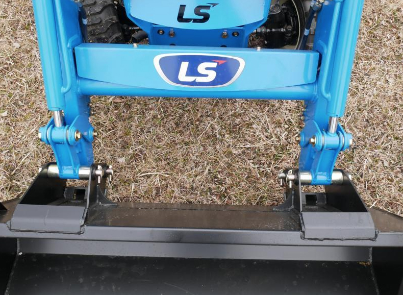

My neighbor sent me these pics... not sure if there is enough detail for you.

Thank you and your neighbor for the pics. That's the one I want. Is your dealer in Edgewood? I may call and ask if they have it in stock and can ship.
/ Factory SSQA For MT-125 Coming? #20
