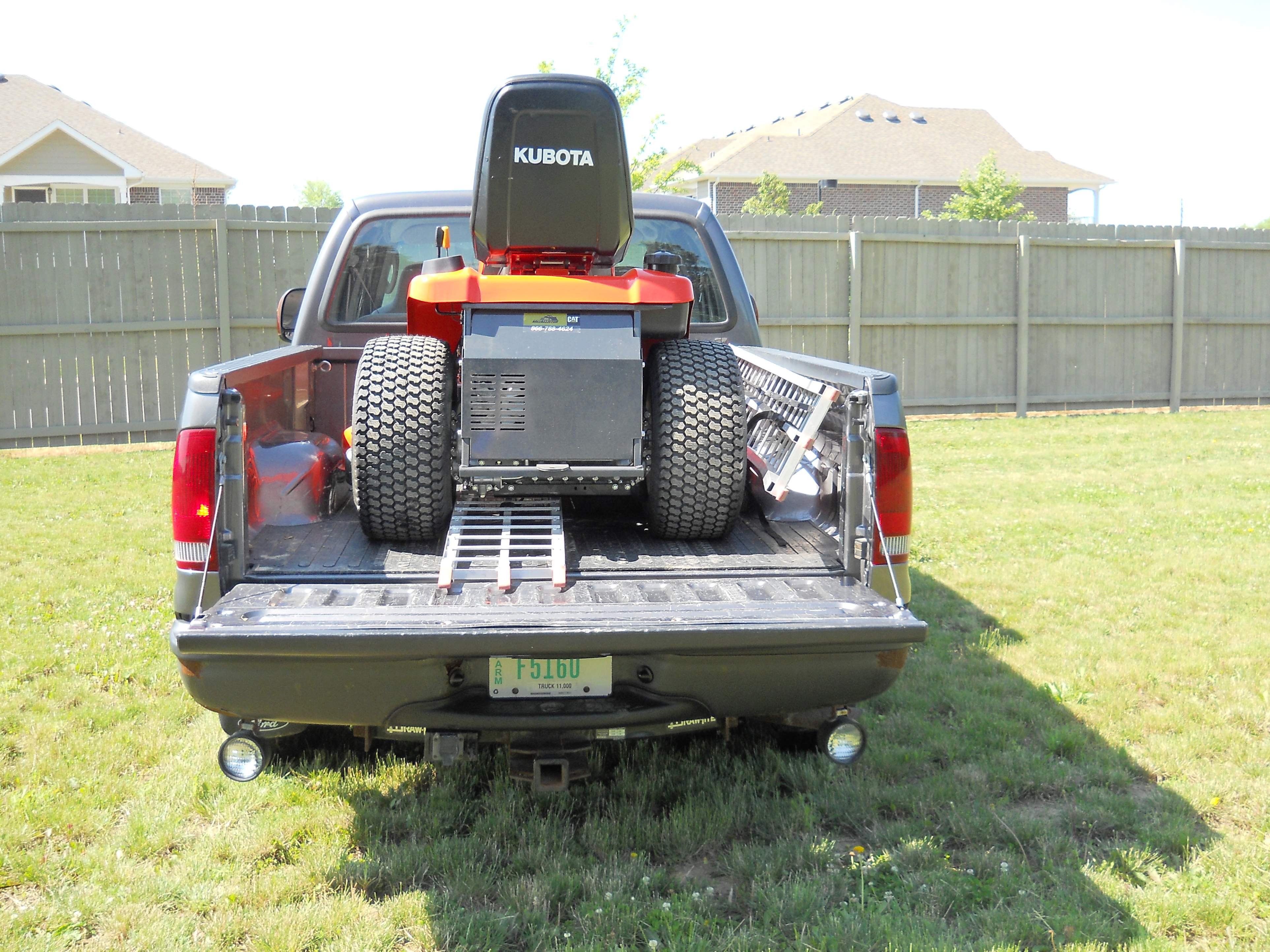

   / Factory work lights #27
I got the same lights to use as backup lights under the rear bumper on my suburban. Great prices and work well.
   / Factory work lights #28
Same here, works great. Philip.
