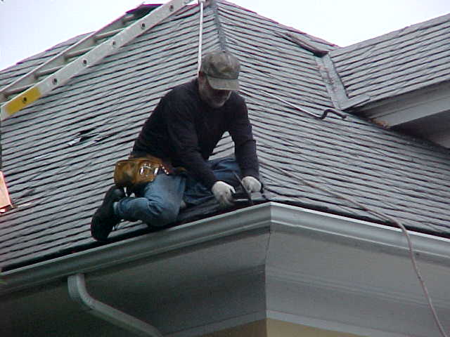

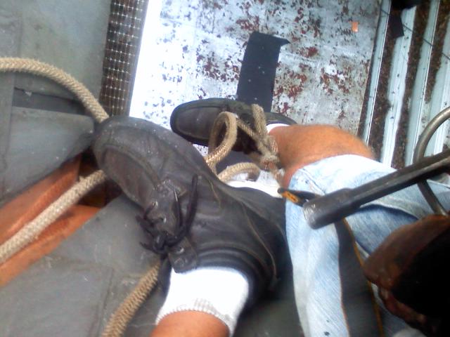

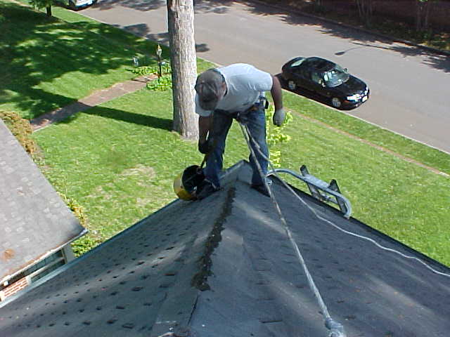

Self employed roofer. I've used many harnesses. Since I only use positioning, I skip the arrest. The rope would have to part for a fall. There was one time though that a shake popped out and, in harness, I hit the deck so hard I broke my arm. Go figure. And another time, while taking my safety goggles off, the elastic strap popped loose and popped me in the eye. Go figure.
