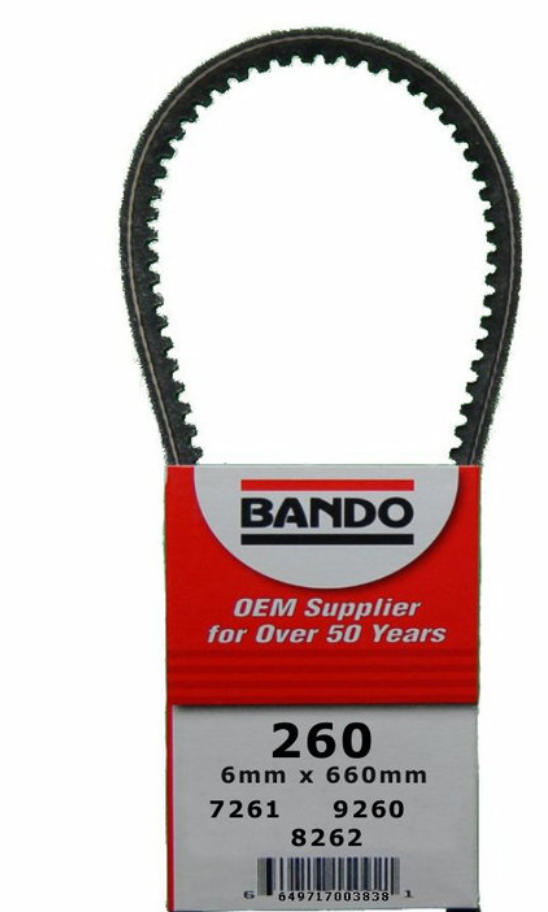

I think I may have found the problem
POWER FLEX-RPF
BANDO's Molded notch design gives extra flexibility to reduce heat build-up and provide long belt life, especially on small pulleys.
I don't see any sign of notch's on my belt and the AC, fan, idler are small pulleys the crank drive pulley is large. So they are in 2 to 1 over drive.
