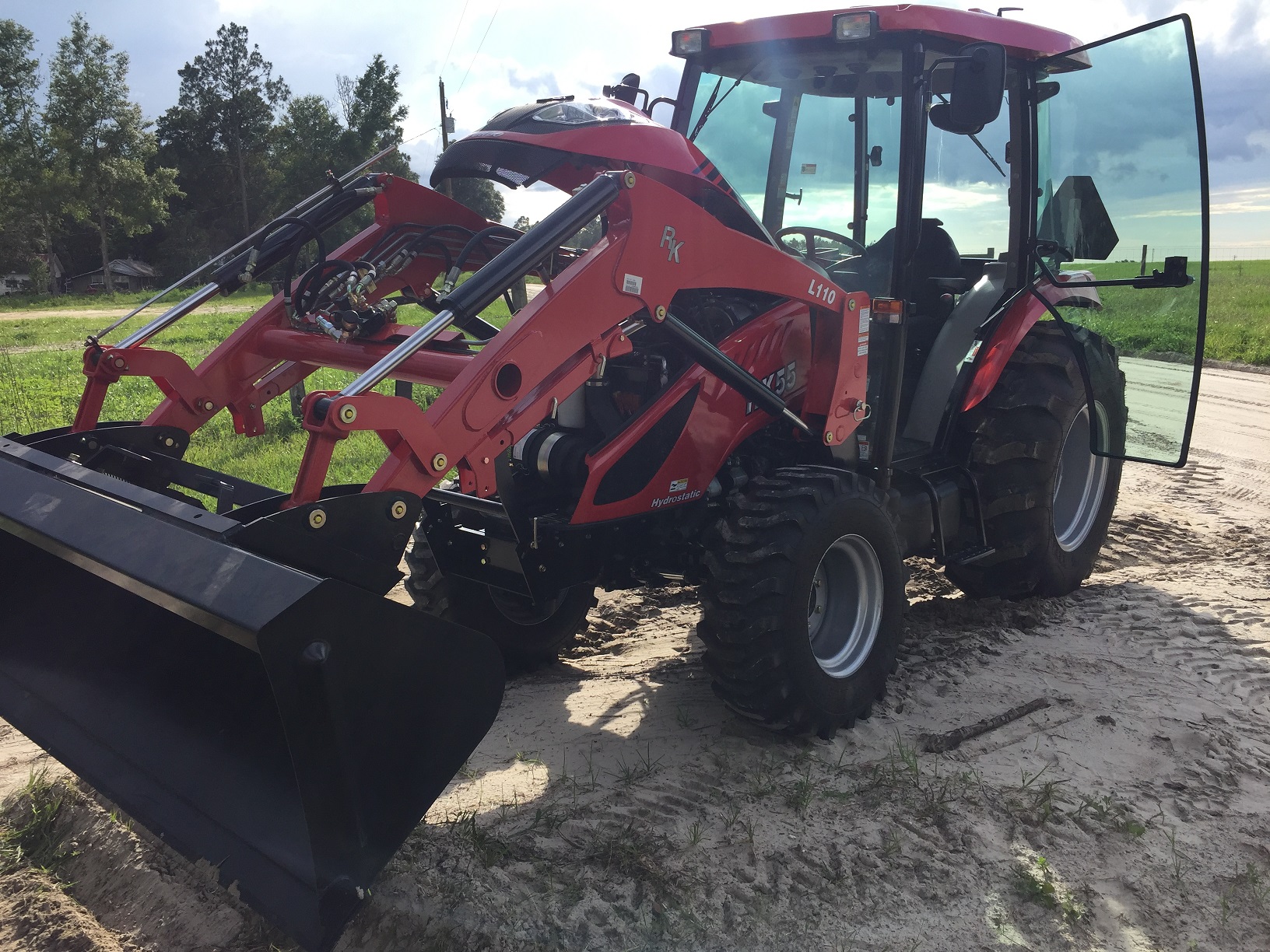

I took some pics of the tractor where it sat before I moved it. It honestly didn't look like a crazy angle in person.
Just looking for some feedback one way or the other. It appears I'm going to have to alter the way I tackle our driveway from the days that I owned the MF.

This sort of suggests the frame is twisting, which seems odd to me. I would not expect that on a well designed modern tractor. I'd check everything over carefully to make sure there wasn't some loose fasteners or some other factor allowing the frame to flex or twist.
The fan is on the engine, which is rigidly mounted to the transmission and rear end of the tractor. What is the radiator mounted to, and how does that interface with the engine/trans/rear structure? If you can determine what allows relative movement, you will probably find the issue.

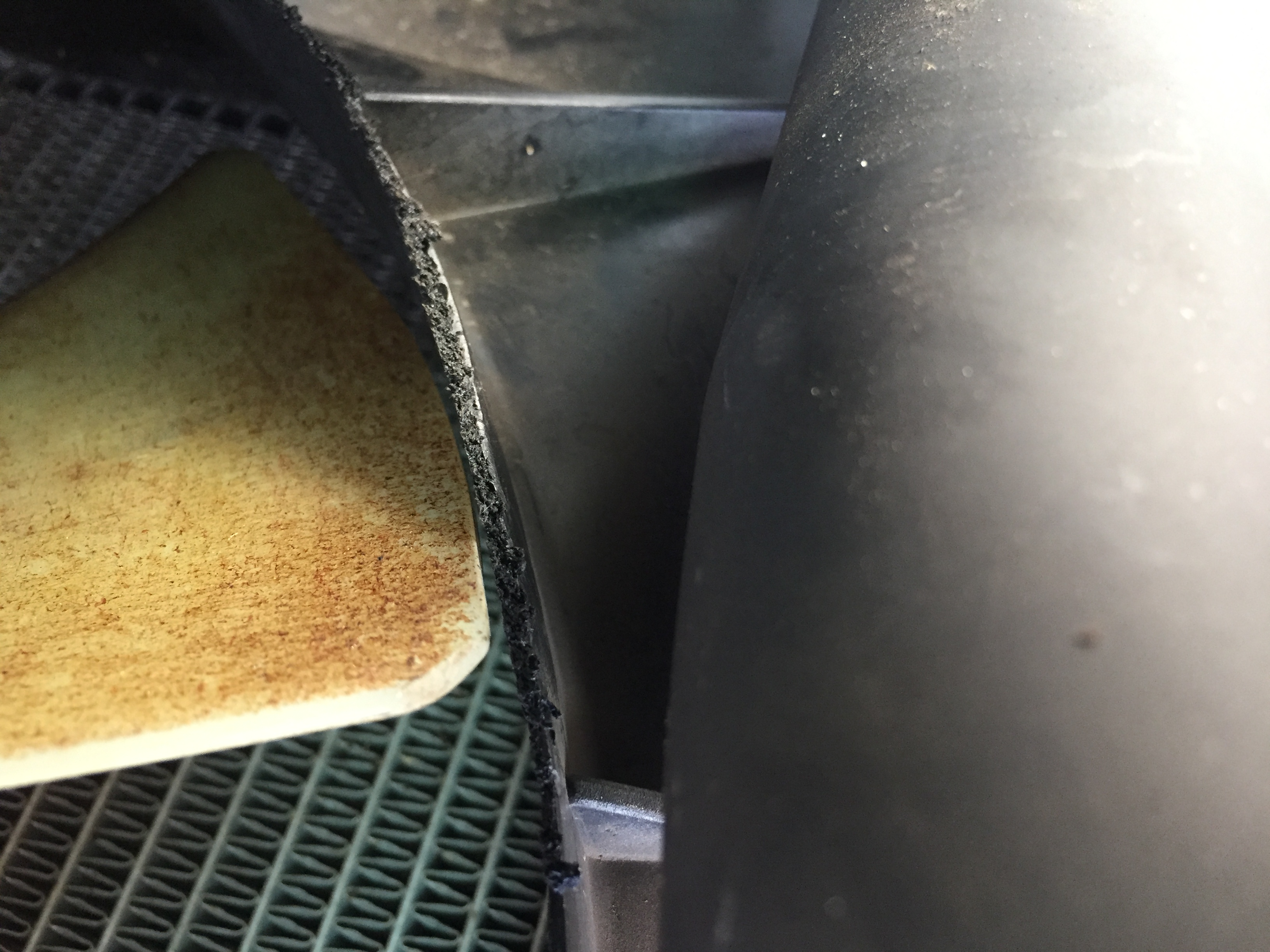

I took a closer look at the fan/shroud assy today and noticed the fan is extremely close to the shroud around the 4 o'clock to 8 o'clock positions, in one spot I've got maybe 1/16 to 1/8" inch of clearance (see pic - sorry upside down for some reason). I don't care how rigid a tractor is, I would think that's not adequate clearance between the fan and shroud. At the top of the shroud I can stick my pinky between the fan blade and shroud.
Unfortunately one of the bolts that attaches the shroud to the radiator does not appear accessible without removing the radiator hose. I loosened all of the bolts but that one and shifted the shroud as much as possible to lower it. Gained maybe 1/16" of an inch. I will need to take the shroud completely off and widen the holes to gain much more clearance than that.

You want a tight clearance between the fan and shroud. That's doesn't look too bad.
Something is moving that causes the fan to hit the shroud and it's a matter of figuring out what it is. Either the entire frame or the radiator support.
Try lifting the entire front of the tractor with the loader and try pivot the front axle by hand while taking a closer look on potential things that it can hit and push.

Kind of hard to tell from the pic but to me it looks like the shroud might be warped. Just looking at the lip it doesn't appear round.
