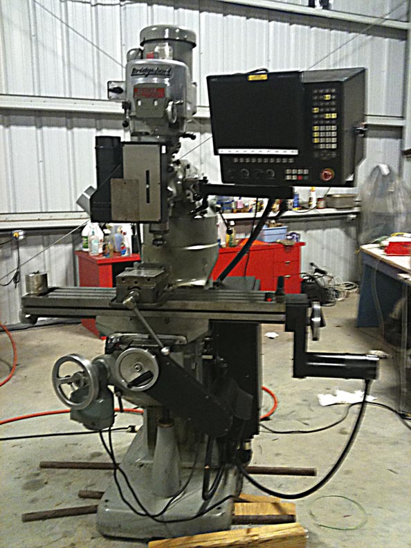

I bought this fancy drill press at an auction that no one showed up to. It's pretty cool because the clamp area can be moved around under the drill with cranks. On the way home at a gas station a guy offered me $500 for it. I was tempted to take it to the bank and be happy, but I also thought this would be fun so turned it down. He said the box is a computer number console and the motors move the drill, which can drill sideways.
The book is about 3" thick so I have some reading to do.

/ Fancy drill press #5
Looks like a proto-trak, not sure due to viewing the picture on a 4" screen. Prices for them start at about $3k and go up. Learning the programing is harder to do than just reading the book, but the outcome is worth it if you intend to make complex or semi complex parts. Heck, even wheel spacers are easy to do with a Proto-Trak. If all you need is a drill press, list it for sale and buy the best drill press on the market and put the rest of the money in the bank. (Or I will trade you my Bridgeport/cash for yours, dispite already having too many milling machines...

/ Fancy drill press #7
I can't read the tag but it looks a lot like a Bridgeport Mill to me.

/ Fancy drill press #9
Bridgeport is the Cadillac of milling machines. If the computer/NC control is good, you've got one heck of a machine. If it's not, you've got some major headaches. You can do most everything with that machine. What type control does it have?

#14
You guys are right. I have learned some. It does say Bridgeport and the big control back is Anilam. It also is called a mill not a drill press, and the cutter that cuts sideways is called a ... milling cutter. They are expensive. It turns out every thing on this beast is expensive. The work clamp is called KURT and they are outrageous.
The motor would not run right - only hummed until I twisted it, then it started turning, but slow. My neighbor said it uses three wire electricity and I have only two connected, so I need an electricians help to install another wire.
The control box box just plugs in the wall and turned ON ok and has numbers that change when I turn the cranks. The manual reads like a math book.
/ Fancy drill press #15
It takes 3 phase power. Do not run it on your single phase as eventually it will ruin the motor. It may also be set up for 460 volt 3 phase. Get some help from an industrial electrician.
