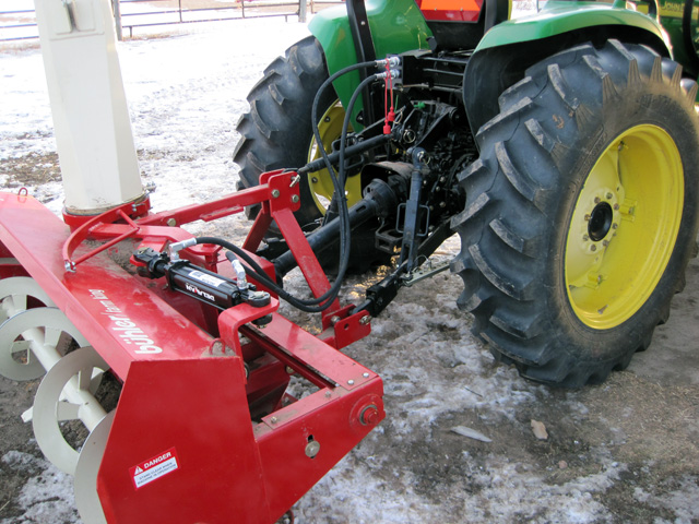

I just put the hydraulic chute rotator on today. I have a Y740 so rotator is a little different, but works using the same principal as the Y500/600. This should be a much better solution than the hand crank - although I could reach it fine, my wife couldn't!
